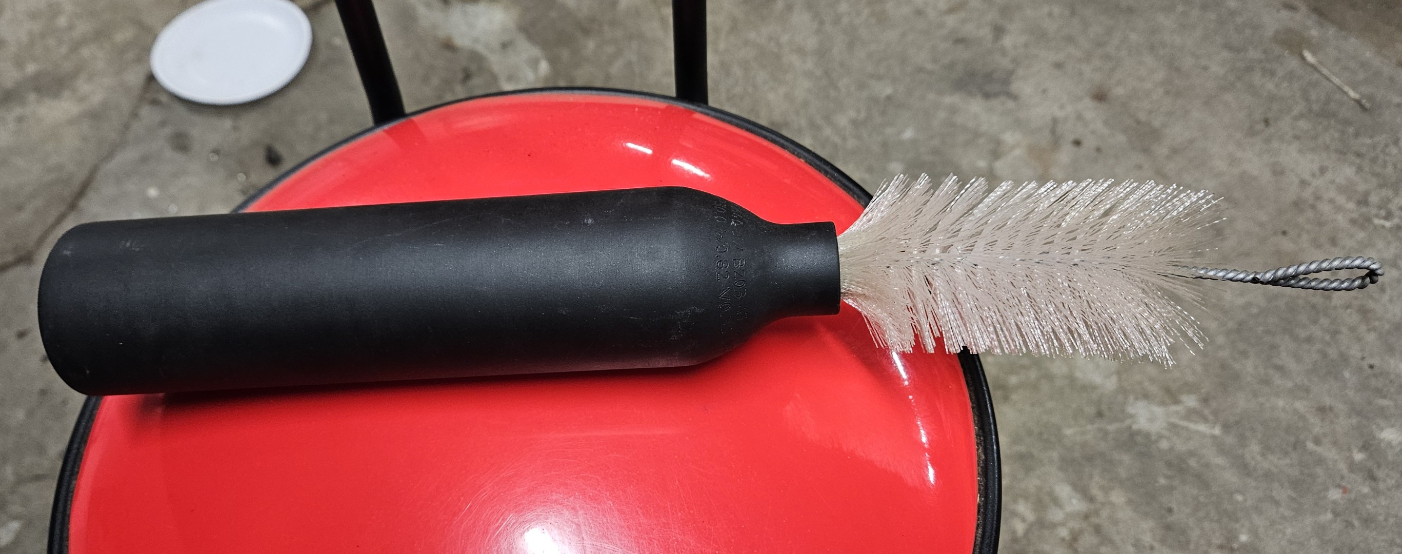

Yes, the ping/boing sound you hear is a pressure wave bouncing back and forth so anything that breaks that up stops the sound completely.The brush really works???
Do you leave the handle on the brush?Yes, the ping/boing sound you hear is a pressure wave bouncing back and forth so anything that breaks that up stops the sound completely.

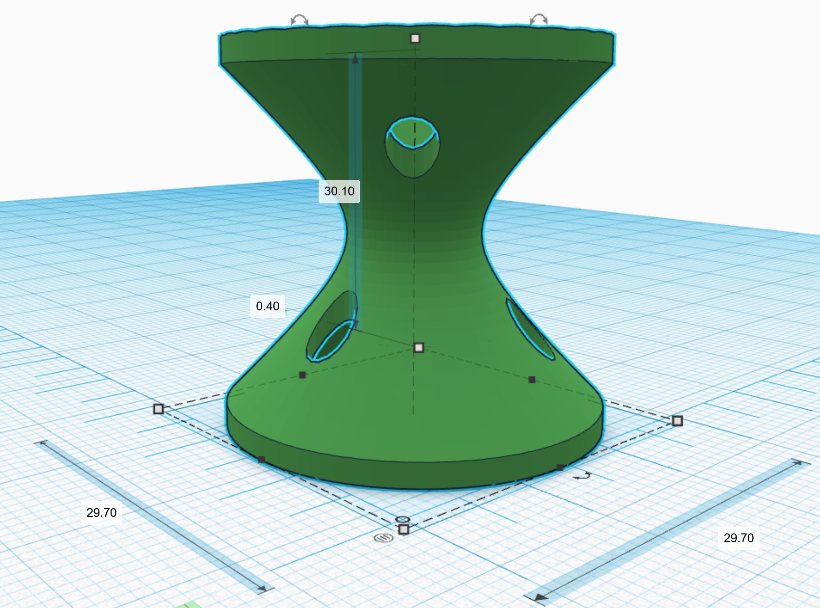

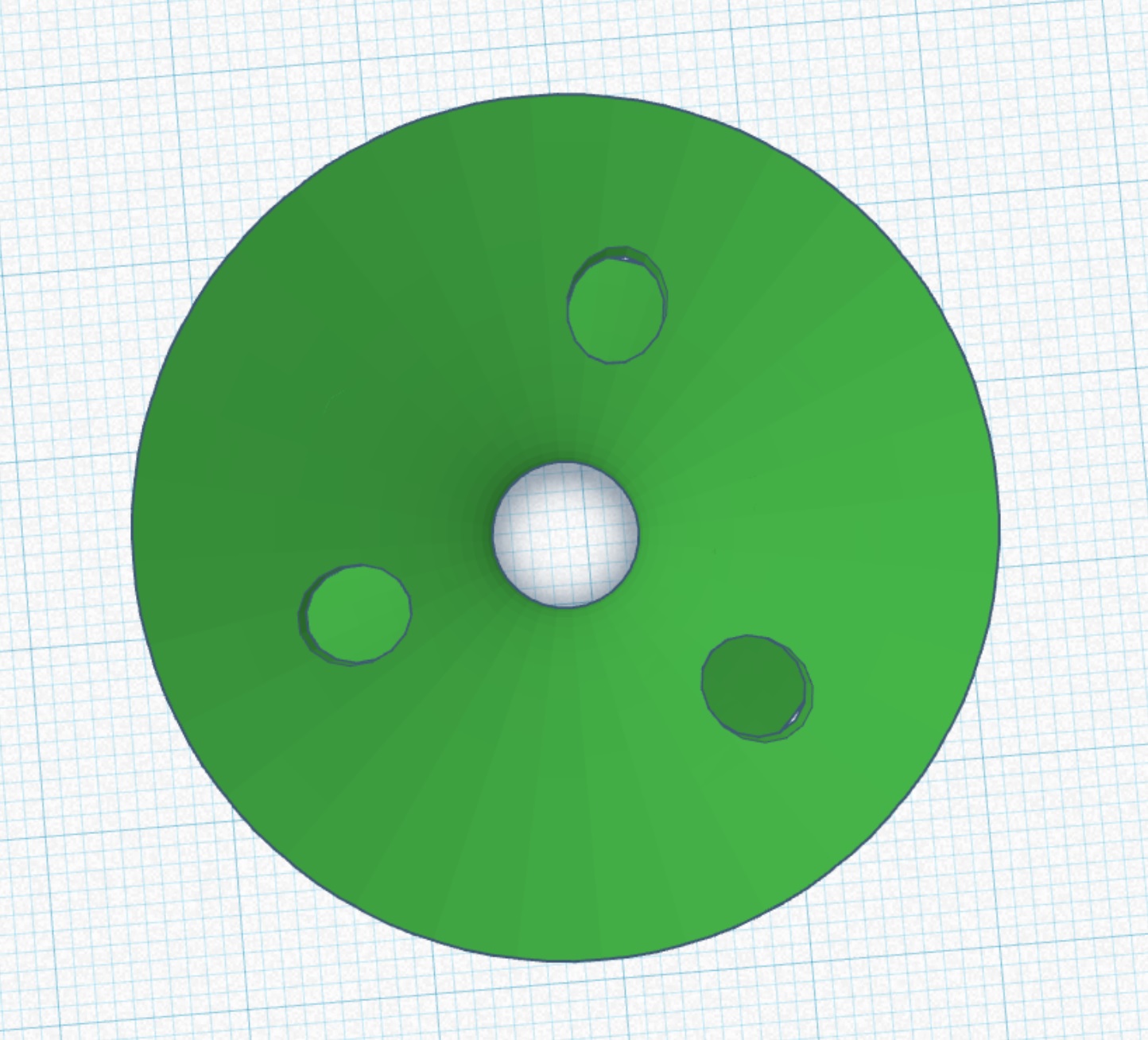

I've never owned an airgun that needed a depinger in the bottle. It's usually an air tube or large plenum and I 3d print one to fit.Do you leave the handle on the brush?
