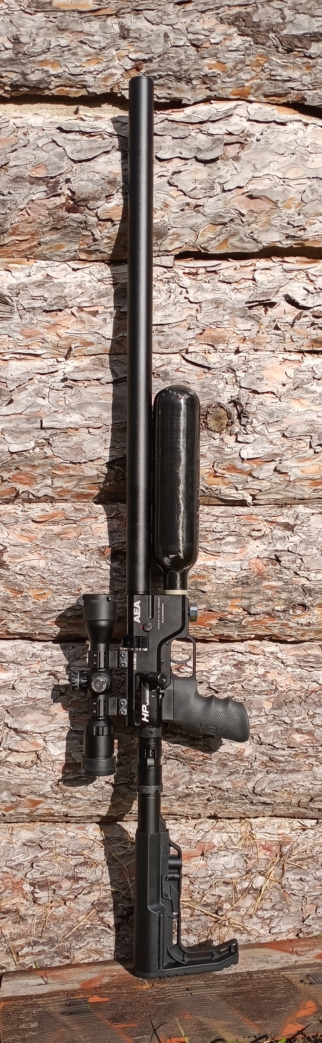

I have a varmint and it is one of my most accurate guns. I got it when they were having some issues with the crown of the barrels but recrowned it. I’ve not heard any complaints of barrel issues lately.
I have modified mine with a balanced valve but I haven’t heard of one commercially available. Maybe in time someone will produce one.

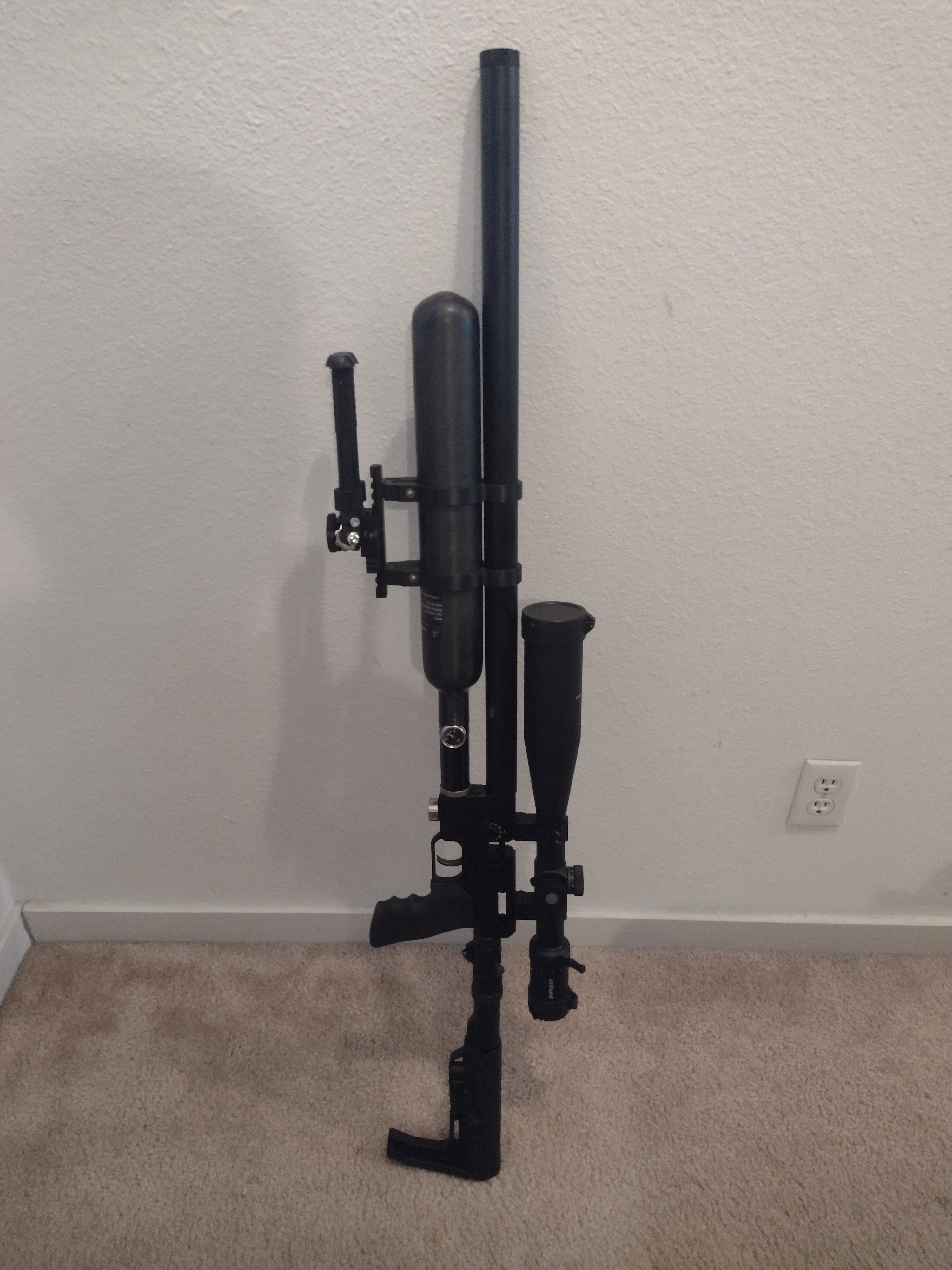

There are many change-outs you can turn it into a semi automatic on mine I did a lot of stuff to it 700cc carbon fiber air tank plenum and regulator very easily to work on I can get up to 91 foot pounds
