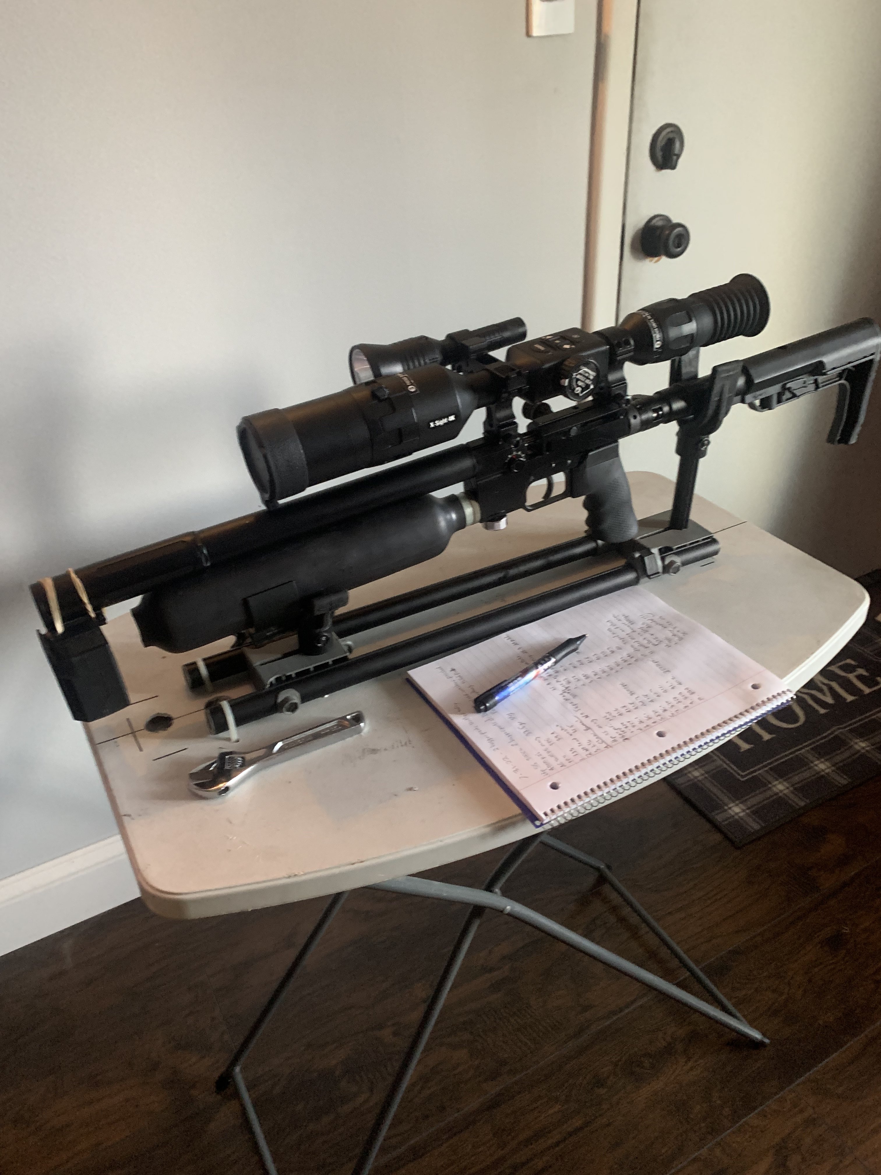

This is my AEA .25 with 8” barrel i modded her with a larger port on barrel and action and closed all other ports on barrel so just one large port on barrel also all shimmed the hammer spring with a 500 cc bottle and fill to 4200 psi she’s a beast.
