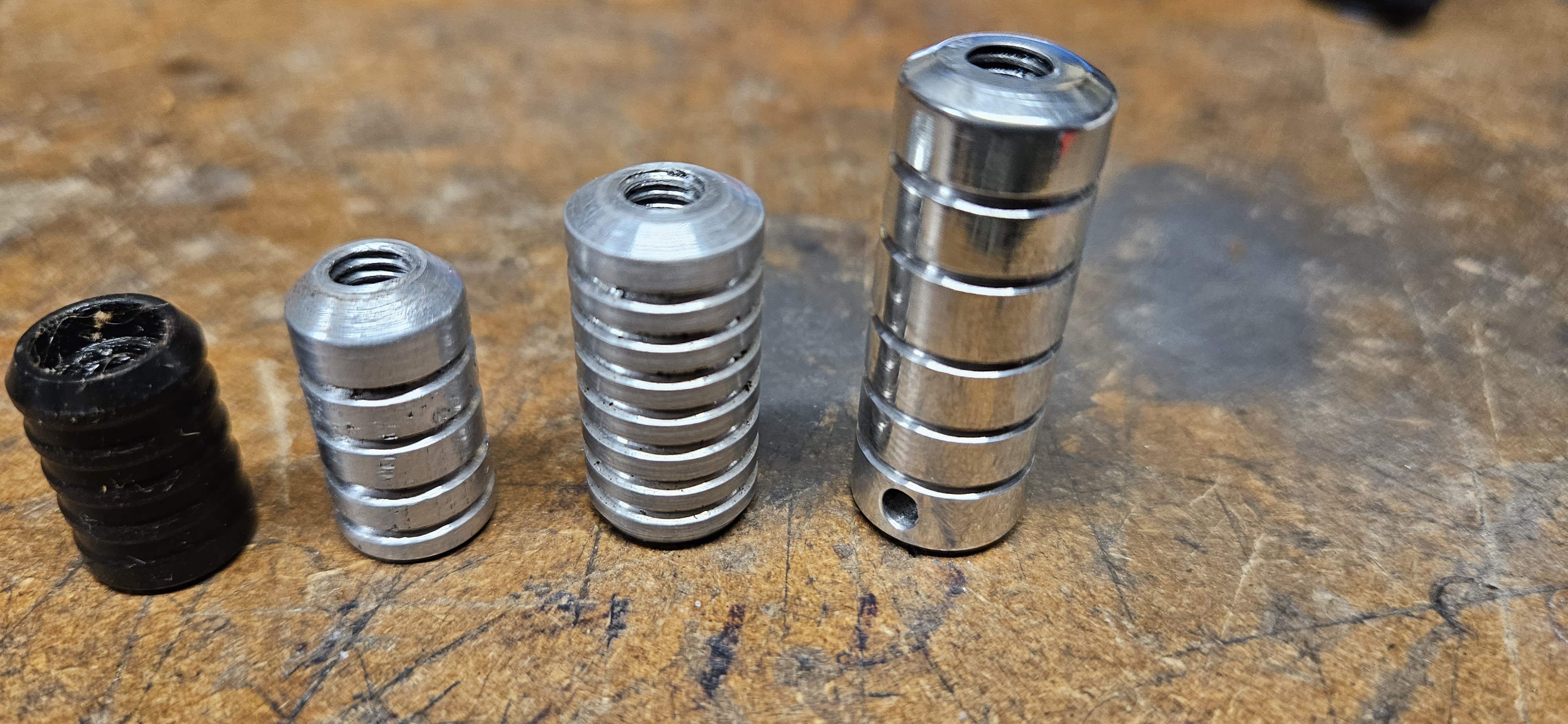

I made a longer bolt handle for all of mine. They do cock hard. When I got my first carbine I thught something was broke. But no that is the way they are. If you tear one down and polish all the parts that helps some. But putting a larger handle on is the best remedy. Do not mix Krytox with petroleum lubricants. Left to right original and progresively larger bolt handles.

I have the OEM springs from the Pellet Shop. Supposedy new and improved. If you lighten the hammer spring it does cock easier. It also don't shoot as hard. You have to balance the poppet spring with the hammer spring to do what you are attempting. Tearing down the insides and poishing does more for the smoothness than hammer spring change and does not affect velocity. I have made many handles for members here and else where and that by far is the best way to make the cocking esperience better. Changing to bolt action does nothing for cocking effort.

I've tuned many AEA HP's for people and I polish everything on the lathe. I replace poppet with PEEK , lighten trigger, recrown muzzle, and add a large bolt handle. They smoothup nicely. I lube with Super Lube, Triflow, or Krytox, depending on what the owner wants. I generally dry spray all parts with spray PTFE let dry then lube. I have not had luck in these rifles with MOLY.

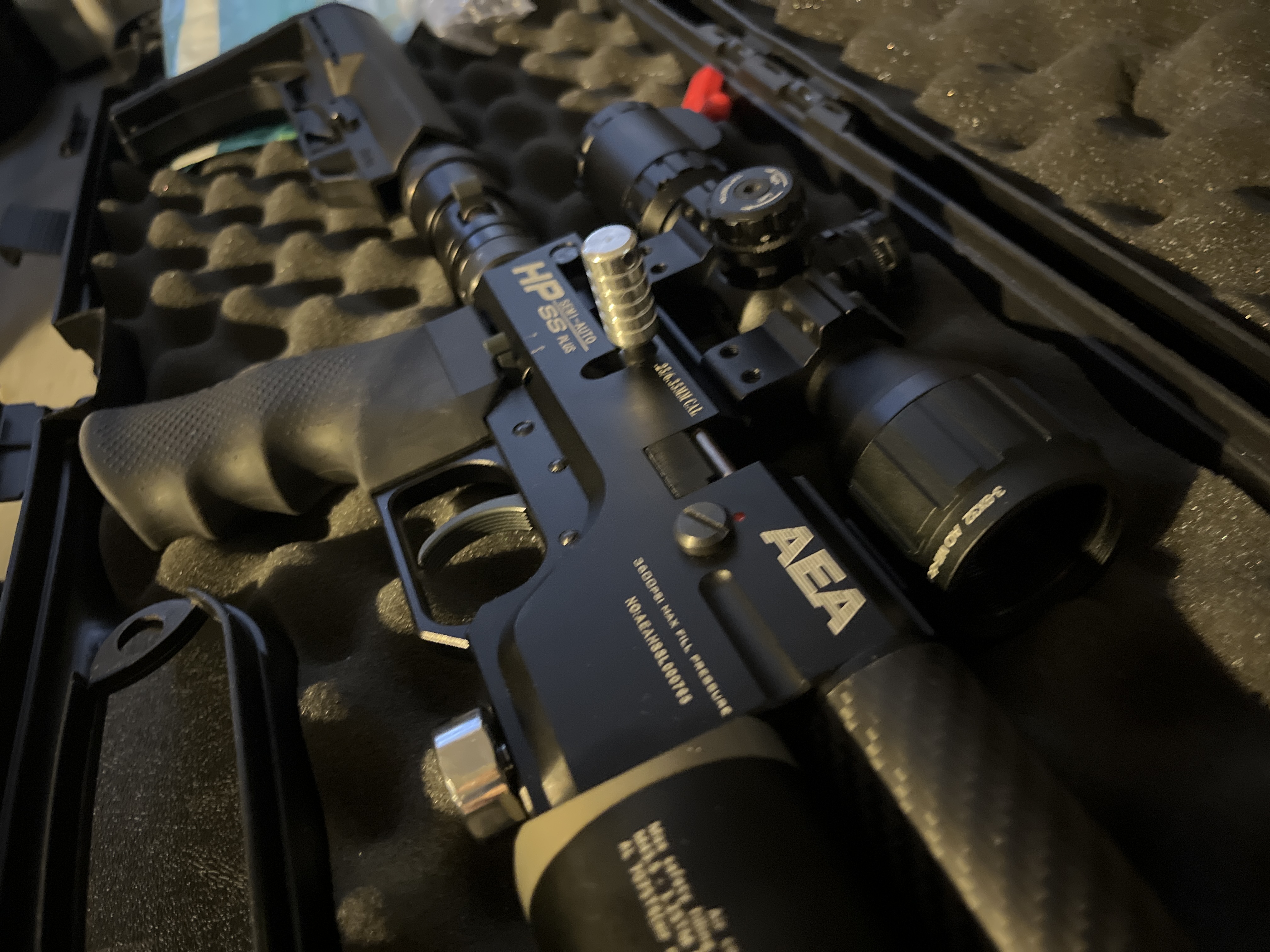

Your bolt handle makes all the difference
