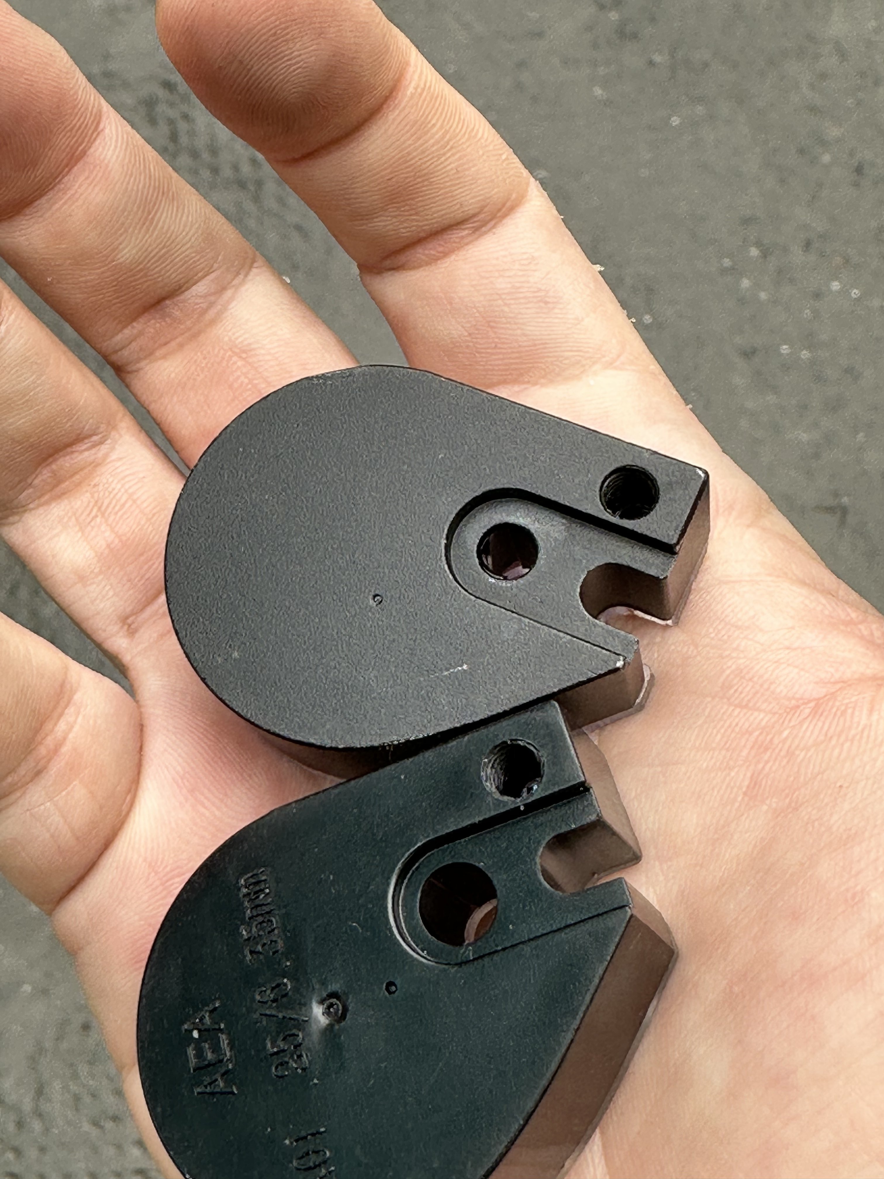

hi sir!In fact, CNC magazines available same time from the beginning of the HP series, but there are too many AEA products that many dealers themselves cannot understand. So they didn't place an order for AEA CNC magazine.
And SF's magazine and HP are universal. And there are also two types: plastic and CNC. Of course,
AEA has not appeared for a long time, so many product line details are not well-known to people.
