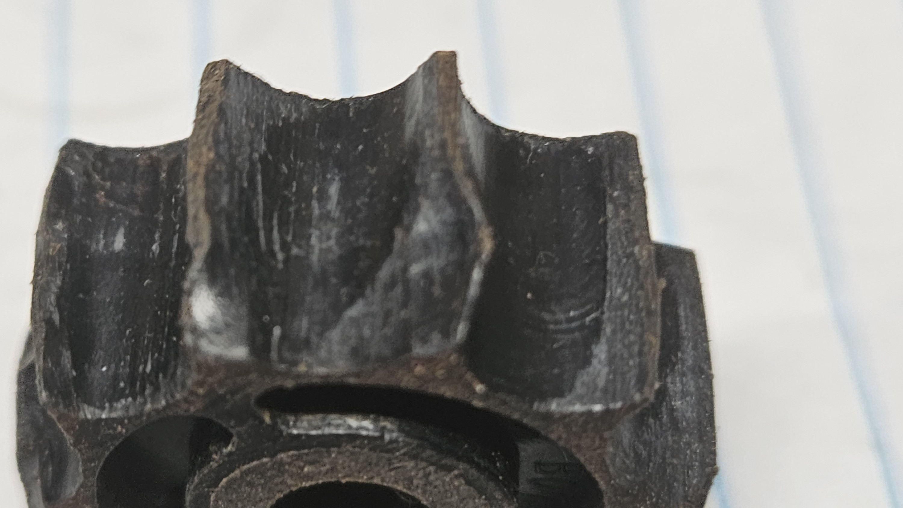

Two problems with the mags are springs and carousels. The springs weaken if left loaded and they slip out of their anchor holes. That is fixable, what isn't is the carousels. They will deform when jammed and then they don't index accurately.

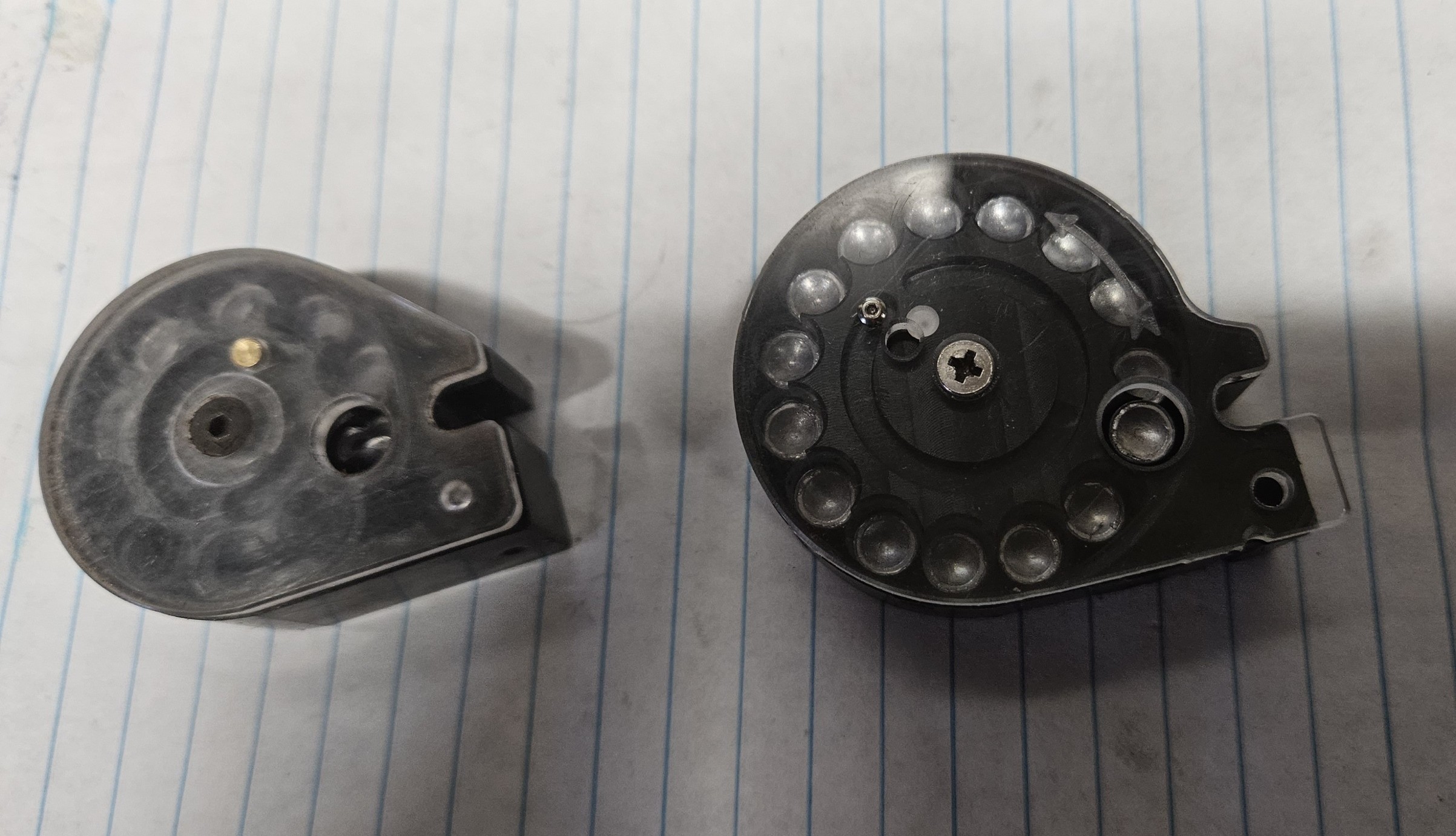

Fox Air Power had a magazine made by AE Swede 15 shot. Been using this mag for couple months and they work fine. They seem to be made from a different plastic. Notice the extended cover lip. I think it is for helping to hold on to it during loading. So as a member said doesn't flip across the room. :)
