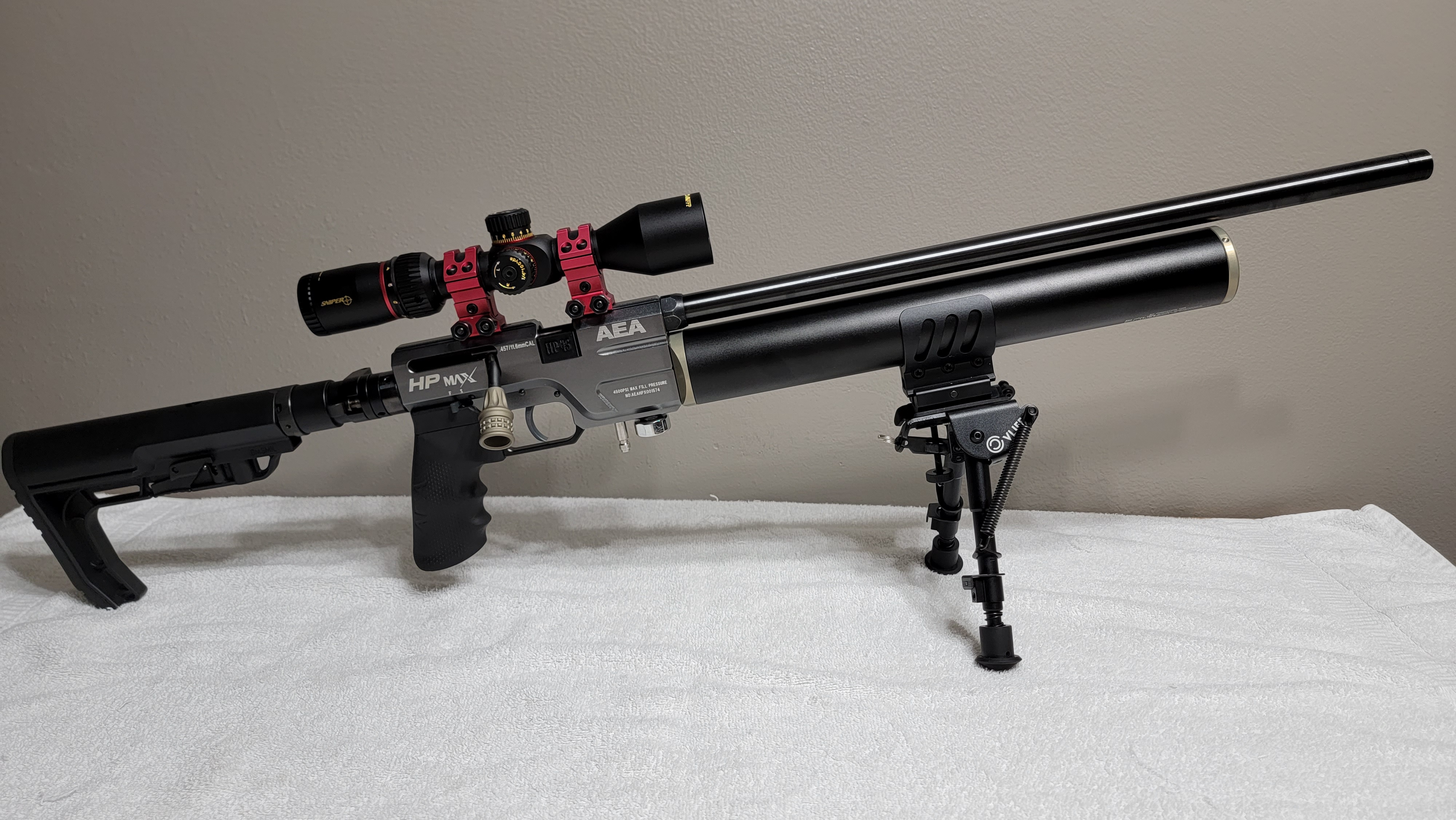

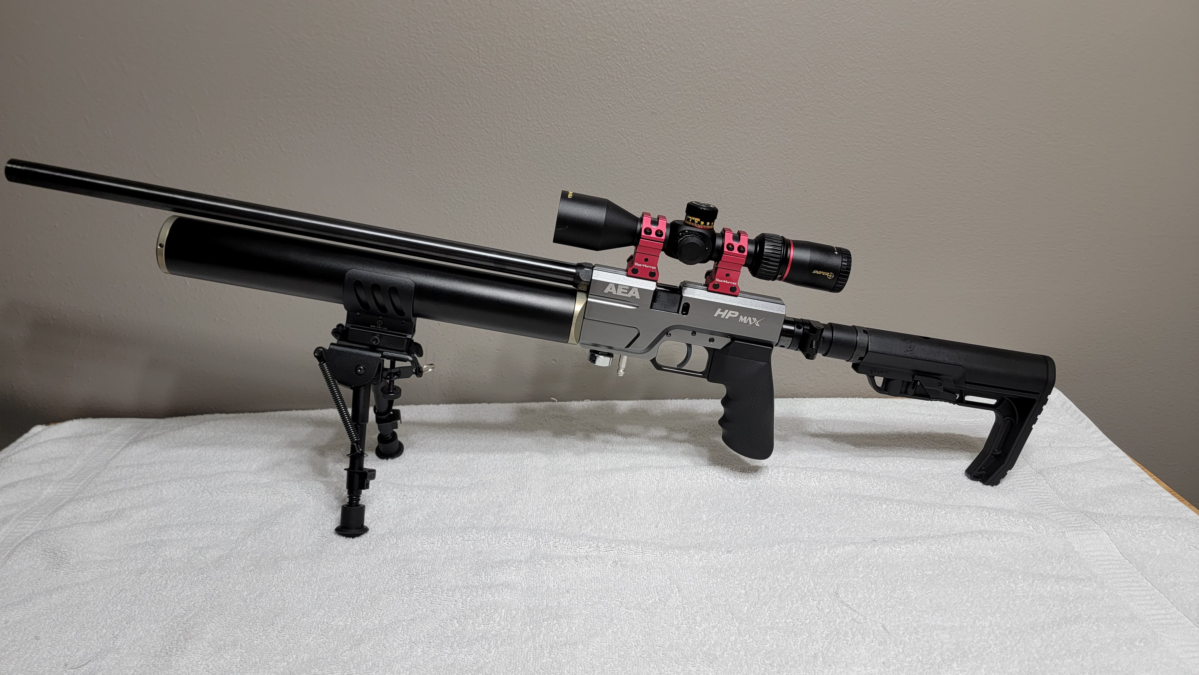

Just a little info.
HP Max .457, 22" barrel, 500cc tank.
4600 psi fill (Because that is what my gauge says when my pump says 4500.) Ending fill 3700, 3600, and 3500 respectively
Mr. Hollowpoint 170 gr (171 measured average)
muzzle velocity 50 yd velocity FPE Ball. Coeff. FPE 50 yd
979 920 364 .1006 321
960 910 350 .1168 314
939 884 335 .1035 296
914 857 317 .0971 279
860 809 281 .1022 248
Mr. Hollowpoint .457 260 gr (264.8 measured average)
803 775 379 .1743 353
772 741 350 .1464 323
765 736 344 .1601 318
719 690 304 .1503 280
670 641 264 .1398 241
Pro Slugs Fury .457 180 gr (177.5 measured average)
958 810 360 .0372 257
930 796 340 .0402 249
914 777 328 .0385 237
893 765 313 .0404 230
800 693 251 .0435 188
the measured average for the bullets were within 2 grains of each other for each type.
i have another 6 or 7 slugs to test next weekend hopefully. just doing this to offer up some information that may or may not be readily available.
it's notable that the pro slugs lose much more energy than the round nose Mr. Hollowpoint 170. Mr. H's seem to retain alot of energy at 50 yds.
copied and pasted text from another post i had. formatting seems different here. first column is velocity at muzzle, then 50 yds, then FPE, then ballistic coefficient, then FPE at 50 yds
