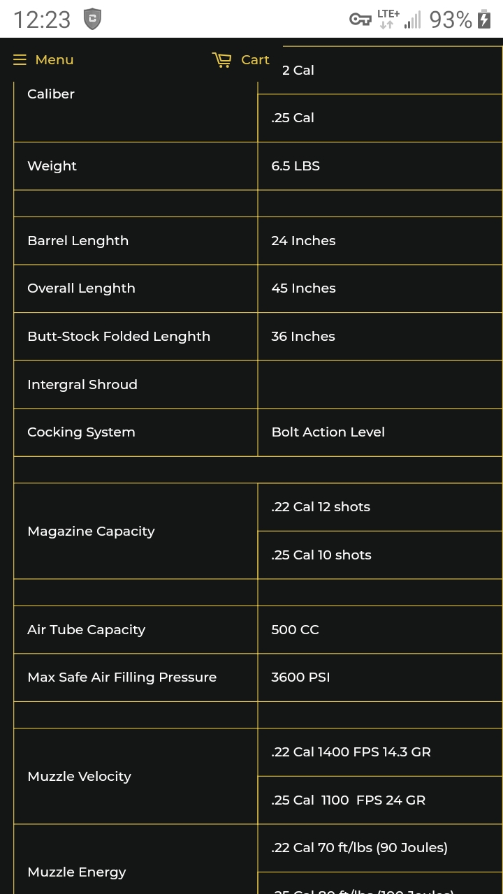

Bin of AEA U.S., Was kind enough to put an AEA HP Varmint together for me. I wanted the regulated air tube, not the bottle. The "Custom " is .25 only, so I probably have the only one in .22. Nice customer service for sure. I chose this particular rifle for weight, accuracy and ofcourse , POWER. The Varmint is promoted as 62fpe in .22 with muzzle velocity of 1,400fps shooting 14.4gr pellets. As it came from Bin it achieved 47fpe on max power setting, (tp power wheel). I was advised by an AEA dealer to bump up the reg. Here's how that went.

The reg is broken so I took it out aired up to 3600psi and got 55fpe. I can live with that. To be clear, I had issues with the gun, not with Bin or Peter. Everyone in the AEA USA family have been first rate. I have no doubt that anything that becomes a problem will be handled. I'm not sure if I will keep her, but I'm not sure I won't. If she is a shooter and a longer bolt handle makes cocking easier, I can see her staying. I hope AEA continues to evolve and improve since a company with such regard for its customer base is a win for all. I may have reservations (small at this point), about the gun, but I'm all in on the people. Lastly, thanks to the people who responded to my op and let me know the reg was not helping velocity. 47fpe regulated (140bar) to 55fpe unregulated. Mister Raccoon best invest in a helmet and body armor.
