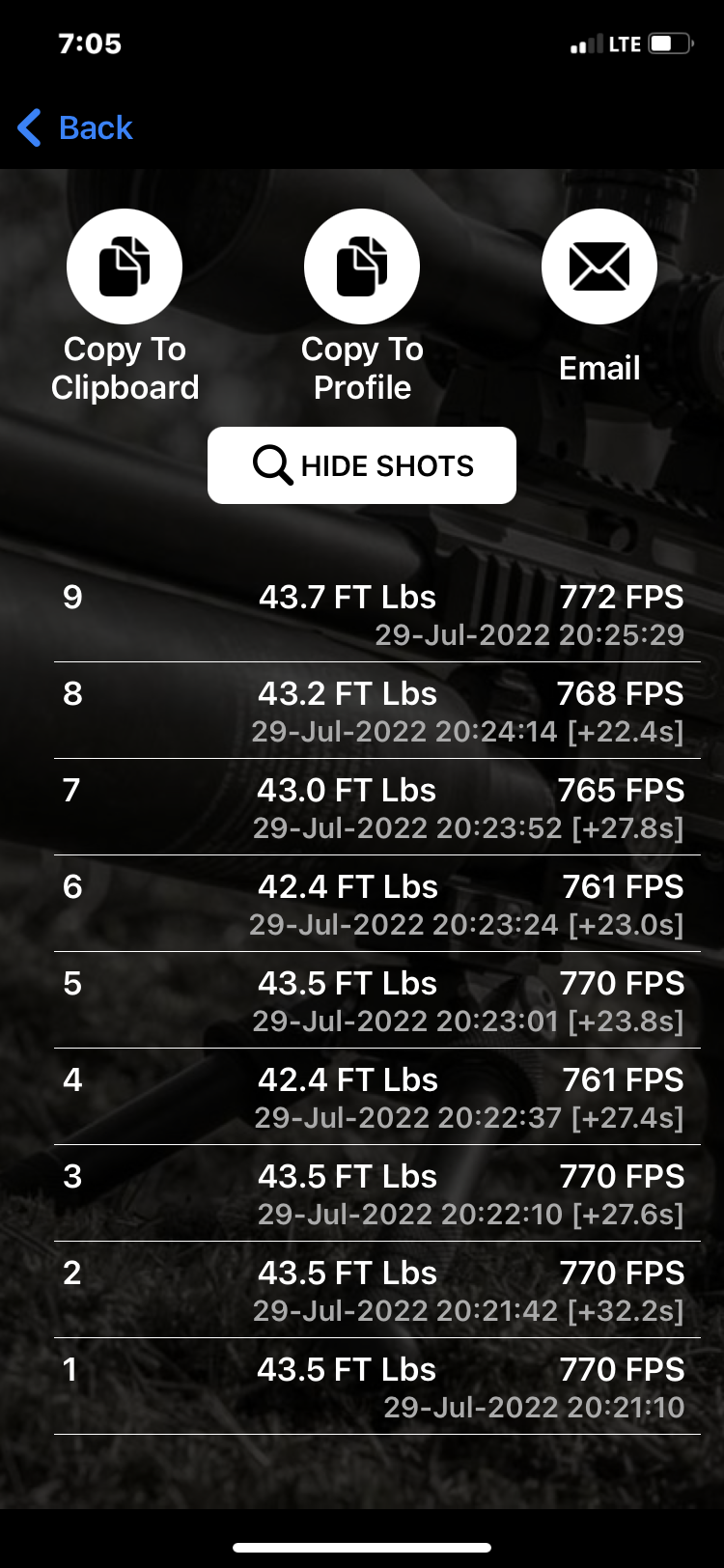

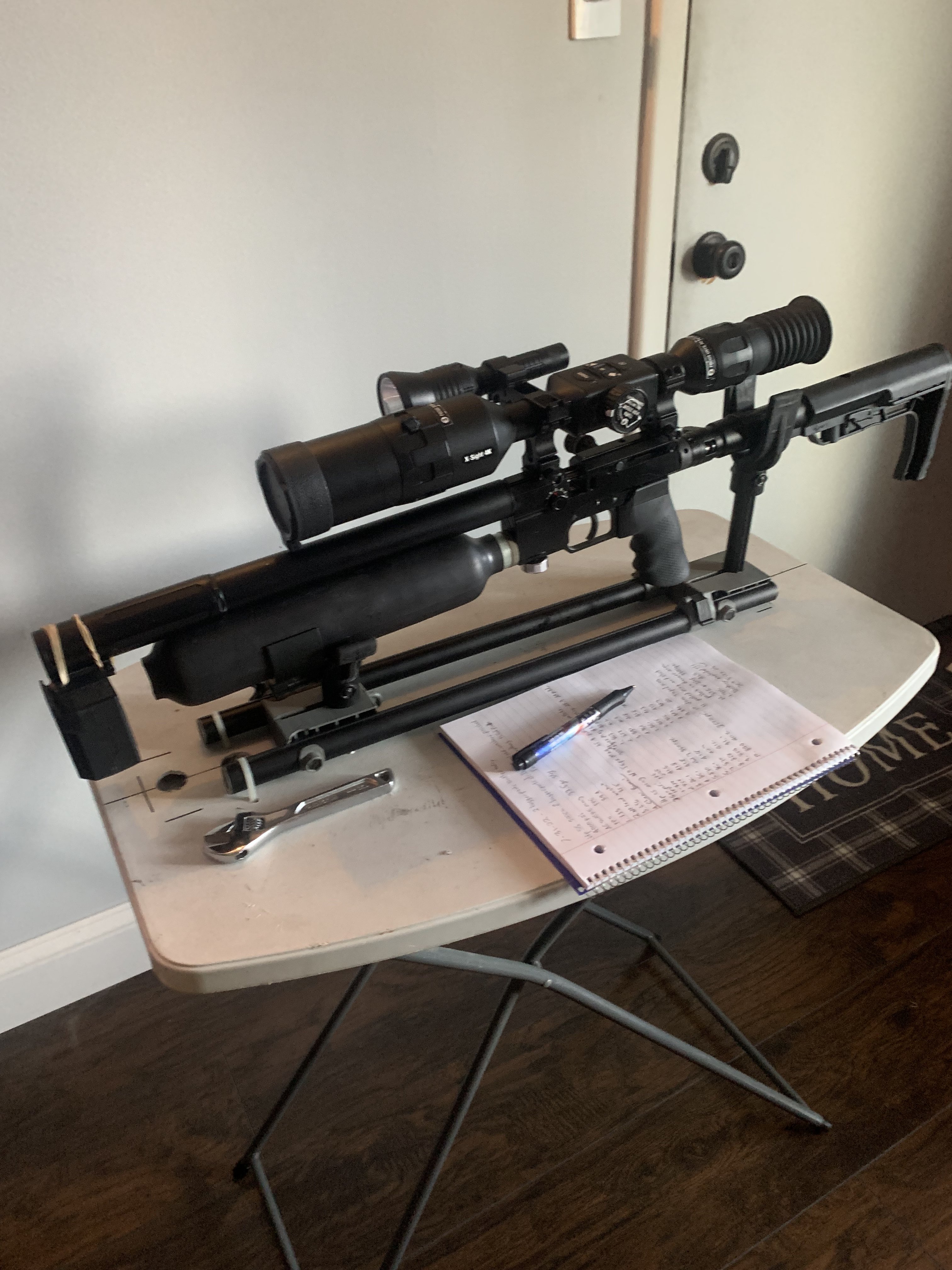

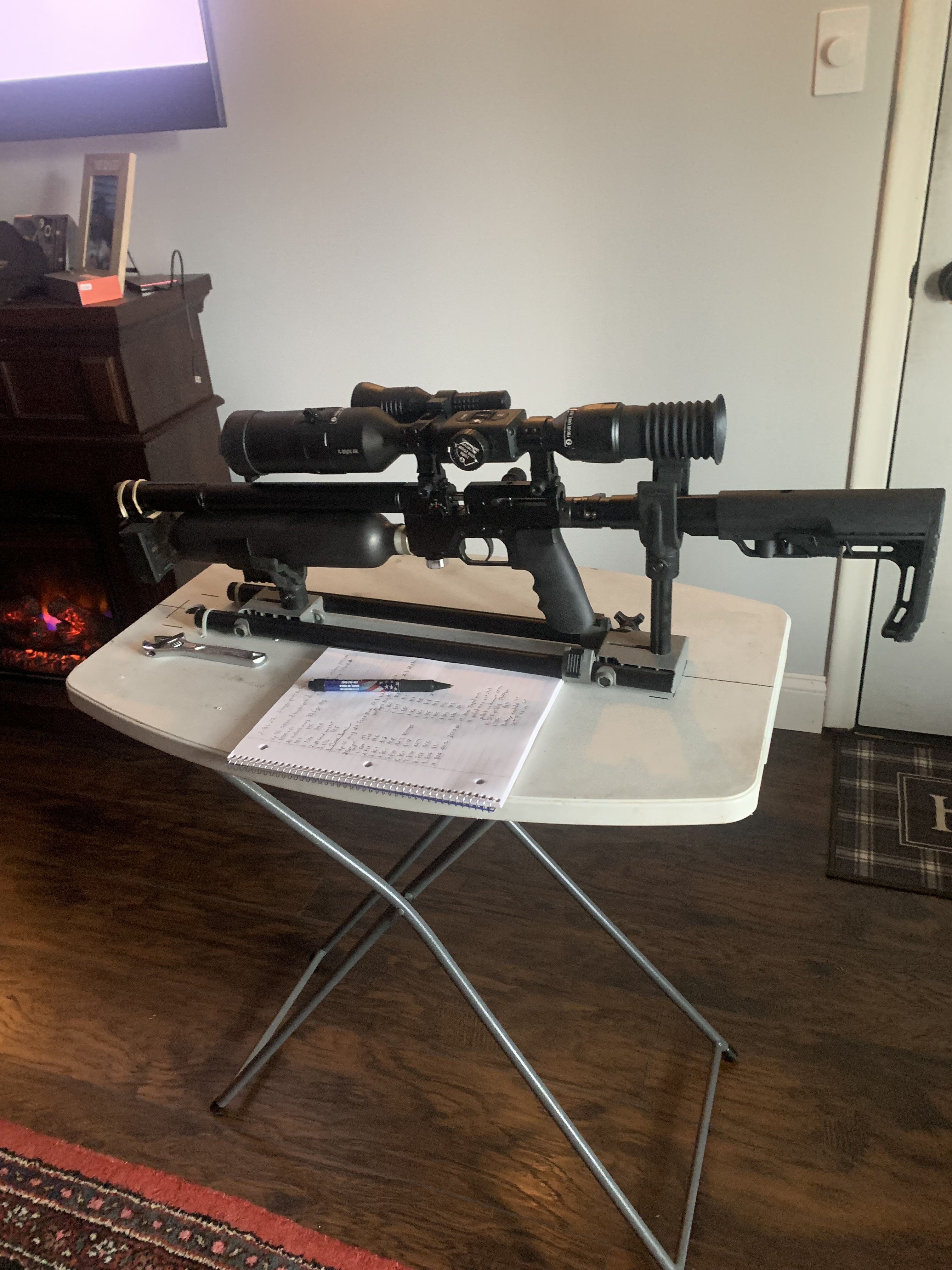

I know it’s not regulated and I love to tinker so I just wanted to see what kind of power I could get out of this thing. I can fill to higher pressures over the 3600 psi and it does still cycle with AEA mags I bought a AE Swede high capacity mag and not so much although it was with 33.5 nielsens I did wind the spring tighter but still no go I’ll try with the lighter pellets in that mag. I think because I polished everything and it’s broke in so to speak that’s why it cycles I did plug all holes at the end of barrel but one and have 3 turns in on the piston meaning 3 threads showing in front of piston on the barrel. A lot of fun tinkering.
but the power for a 8” barrel is pretty cool

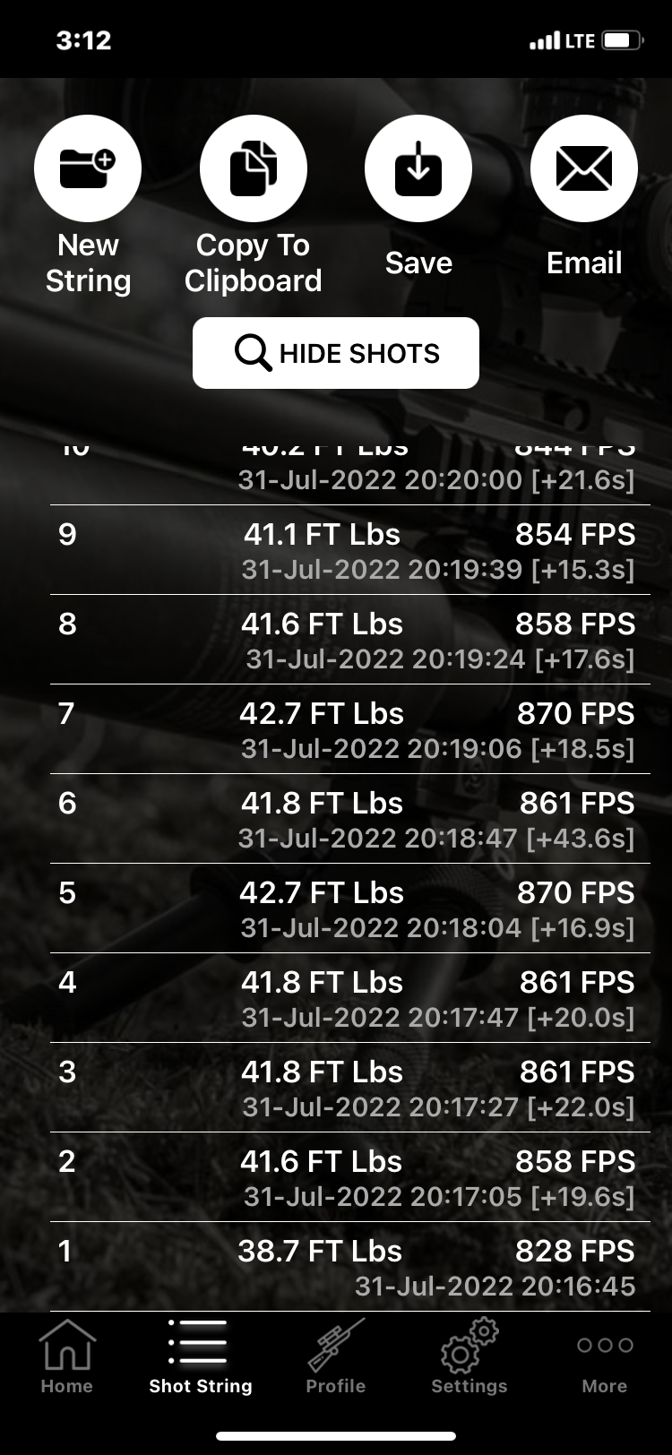

That's some impressive power. I have some comparisons I can give that are like for like. My rifle is the TD model in 25 cal. with the 13 inch barrel. It has one modification to the black disc in front, turned in 3 turns. I did this to soften the action cycle some. I noticed NO difference in velocity after that adjustment but it did seem less violent when cycling. I fill my rifle to 3600 psi. With 33.6 gr Nielsen's it averages over 25 shots 797 fps, SD 11. With 25.4 gr JSB's 30 shots at an average of 901 fps and SD 9.
By far the most accurate out of my rifle are the 26 gr slugs. The 26.8 gr Nielsens shoot average of 30 shots at 887 fps with SD of 12. You may want to try some. You have me wondering now what you could get out of a carbine in 30 cal.
