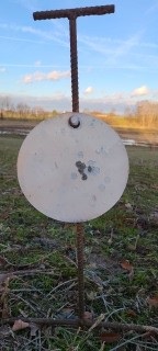

Congratulations on the carbine. Shot this 5 shot group at 75 yards with AA 25.4 gr pellets. I was aiming at the bolt at top of disc.
