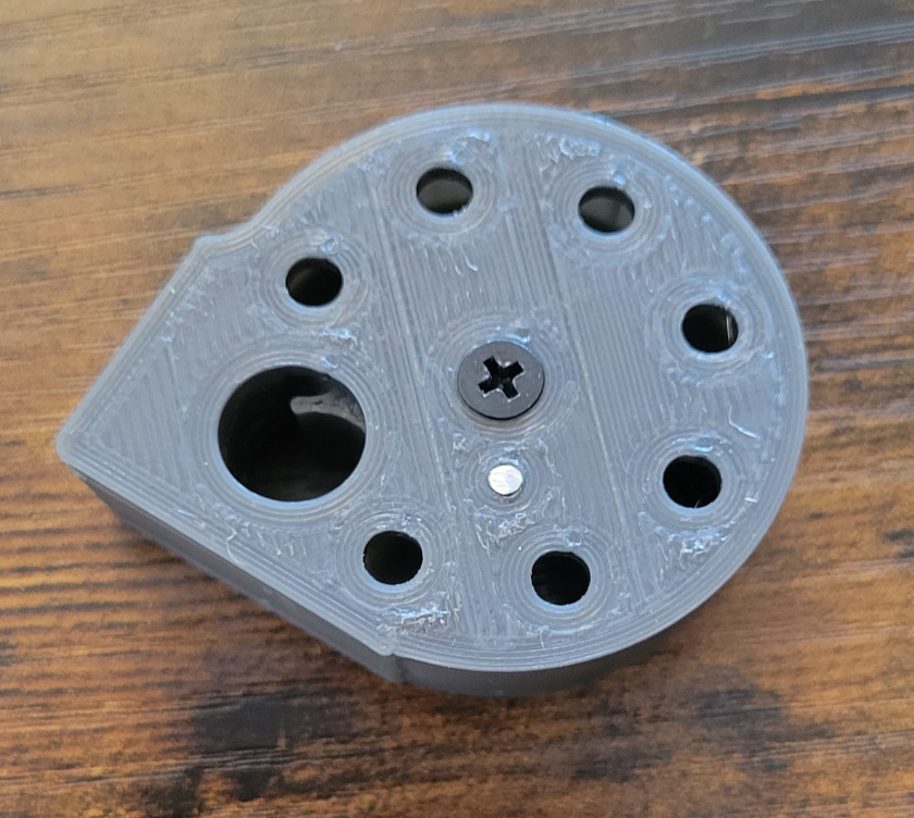

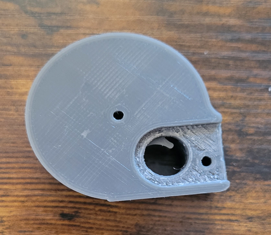

I have designed new mags for the .357 AEA HP. I had a customer send me a factory unit. OMG...the quality of the AEA mags in grossly terrible. Mine are made from PETG and soon to be back in a customer's hands for further testing on my design.
The bolt or cover countersink and terribly inaccurate and way out of spec in my mind

Is that a prototype? You seem to be having an under extrusion problem in the last pic.
heavy-impact/
its not under extruding. that recess area has a support as it gets printed and its not giving the cleanest release that it should. trying to get the setting tweaked in as I have been fighting the support releasing on all sorts of different prints. I run a bltouch on my ender 3 pro. so this are as they should be.
Have a look at the QIDI version of Cura, I like it better than Cura https://drive.google.com/file/d/1s7TyUp9k1e6_-XZJKeA4KanktKGOhGHG/
