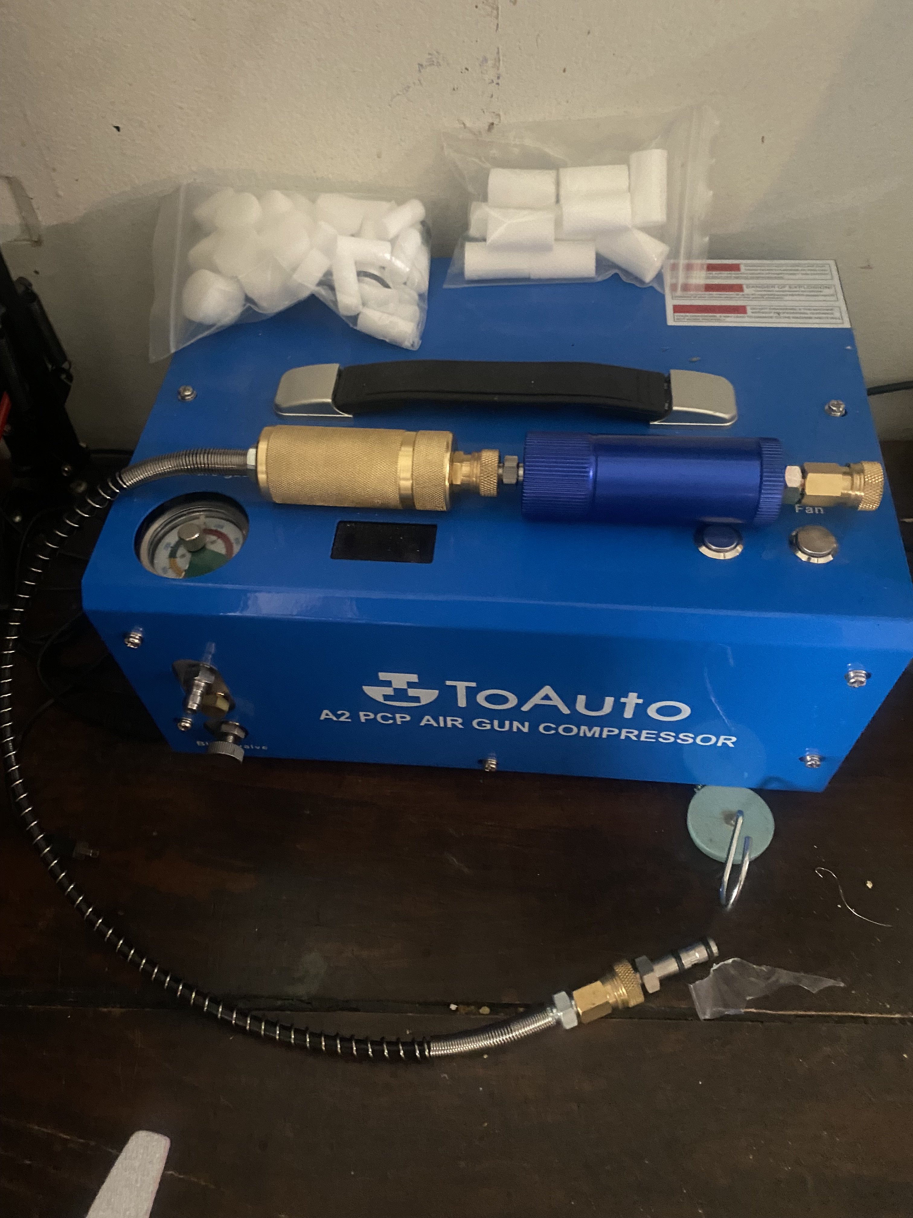

I have an element max and 50 Cal. I have the small water separators that are about 4 inches long. I have two of those and tandem. I didn’t feel comfortable with just using one of the little things. I’m working on getting another one here in a couple weeks a bigger one.

I’m thinking that I’m getting moisture into the tank as it sits it’s condensating inside the tank. on that first shot it’s blowing water out, preventing the valve from closing immediately after the shot.
I was thinking you know if I had water in it, it would do it through every shot first aired up.
So I guess my question is, is it possible that there’s a small amount of moisture? Getting into my tank. And it condensates over a few days?
Thanks in advance

No it works fine, and it only does it when it’s full and left untouched for a couple few days after it dumps I can fill it up to its max and it shoots fine for the duration multiple fills. It’s only when it’s filled and left it dumps the first shot. The only thing I can think is hear in the south with a average of 70% air humidity that these water filters are letting in a small amount of moisture that is condensating in the tank if it sits.

No need really, I just take the first shot after that it’s hood. The main concern of mine if it’s water. Water at high pressure will eventually rip through a seal. I’m getting a better water separation system and a dehumidifier for my study to remove moisture from the room. We have 70% humidity here in Arkansas on average it’s in the air when it’s goin into the pumps but I’m thinking it’s getting some in the tank that condensates when it cools. After everything I’ve read that Hass to be it. Other than that initial dumped the gun shoots fine
