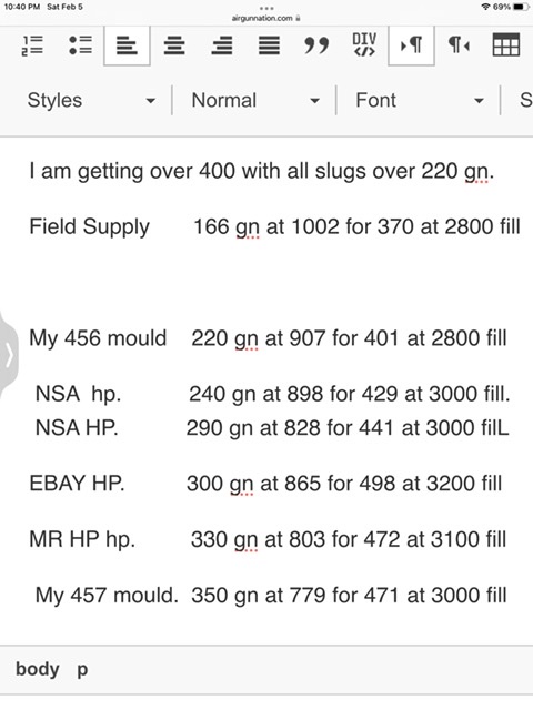

The listing for the .457 and .50 say 400+ FPE. Does anyone know what they are really capable of? I found a thread on the other forum saying these rifles support 4,000 psi, is that the same for the .457 or just the .30/.357?

  • yes you can fil it to 4000 but 3600-3800 is the sweet spot
