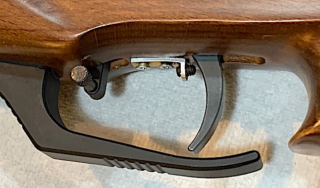

BTW, I've also fabricated a sear-engagement adjuster, to get the trigger down to a crisp, 2 pound break.
That sear-engagement is really ingenious! And the spring trick too. One inch at 50 yds. in gusty winds seems good to me. You probably fixed the barrel and did'nt realize it until today 😉 jk. Should try in good conditions.
