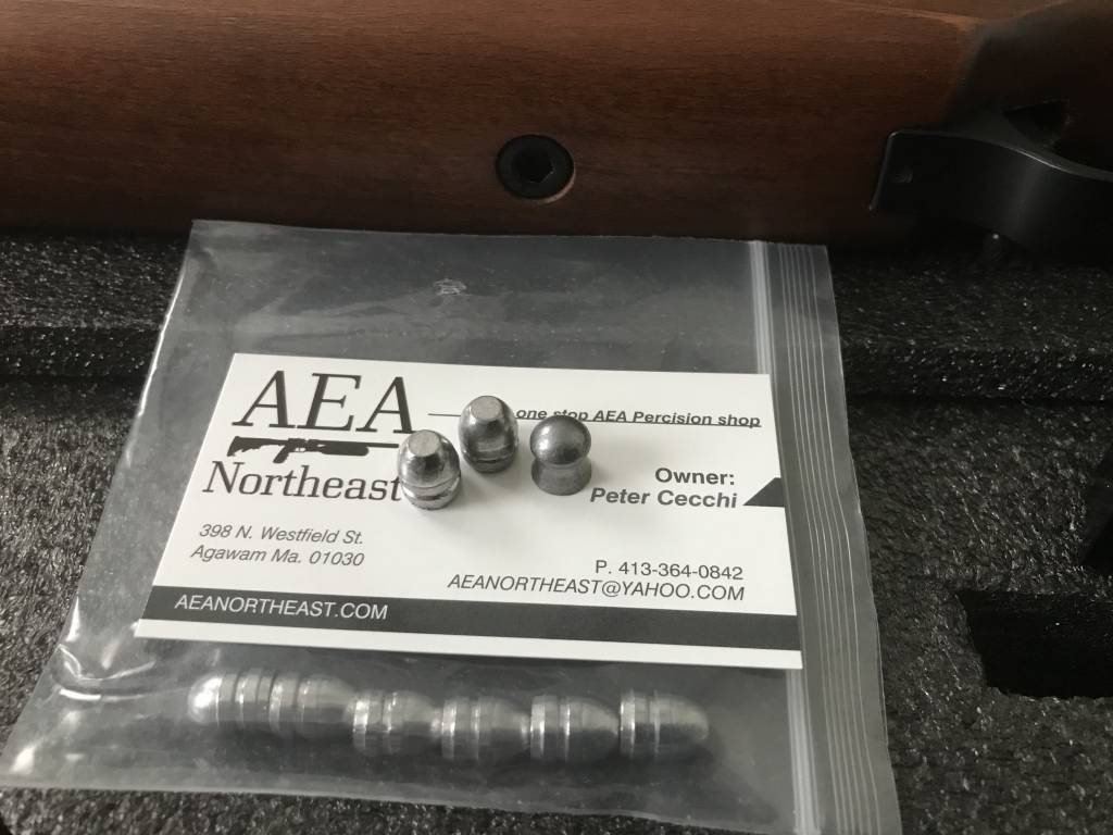

Good question! I juts got my .357 yesterday and took my first shots today, I tried to chamber a .358, that was a no-go, I sized it to .356 and it chambered nicely and the Lee 358-105-SWC was stacking at 30 & 50 yards, I hit steel at 100 yards but need to put them on paper to see what the group size is like.
I'm trying the LEE TL356-124-TC next, powder coated of course.
I am loading one by one, too long for the magazine but will break out the LEE TL356-95-RF for magazines and see how that one shoots.

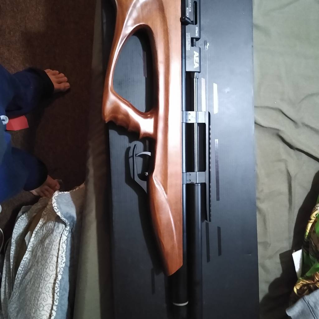

AEA .357 challenger standard big bore w/side leaver 212fpe with a 81gr jsb pellet 1085.5fps would be upto a 220gr lead at 820fps(thats the slowest my gun shoots that rd at first shot) for 322 and a half fpe (my airgun shoots better than these numbers for the most part 30fps higher on aberage).
it cost $609 without all the goodies like the emperor $240, utg 360 $73, extra 10 shot mag $35, slugs of various weight $200.
