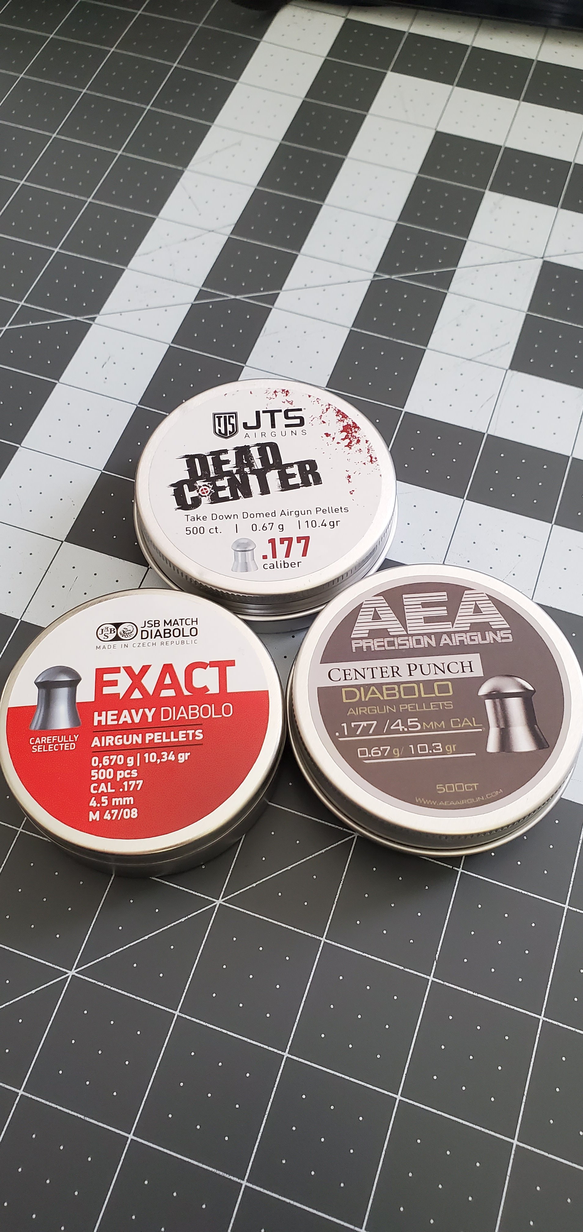

AEA and JTS .30 pellets 45 grain
Are these pellets the same exact but just in differently branded tins?
The look exactly the same, same shape, same cavity, same weight. Even the black foam in the tins.
The JTS come in 100 count tins and the AEA in 150, but other than that they are identical.
Kinda like JSB with FX and other JSB variants.

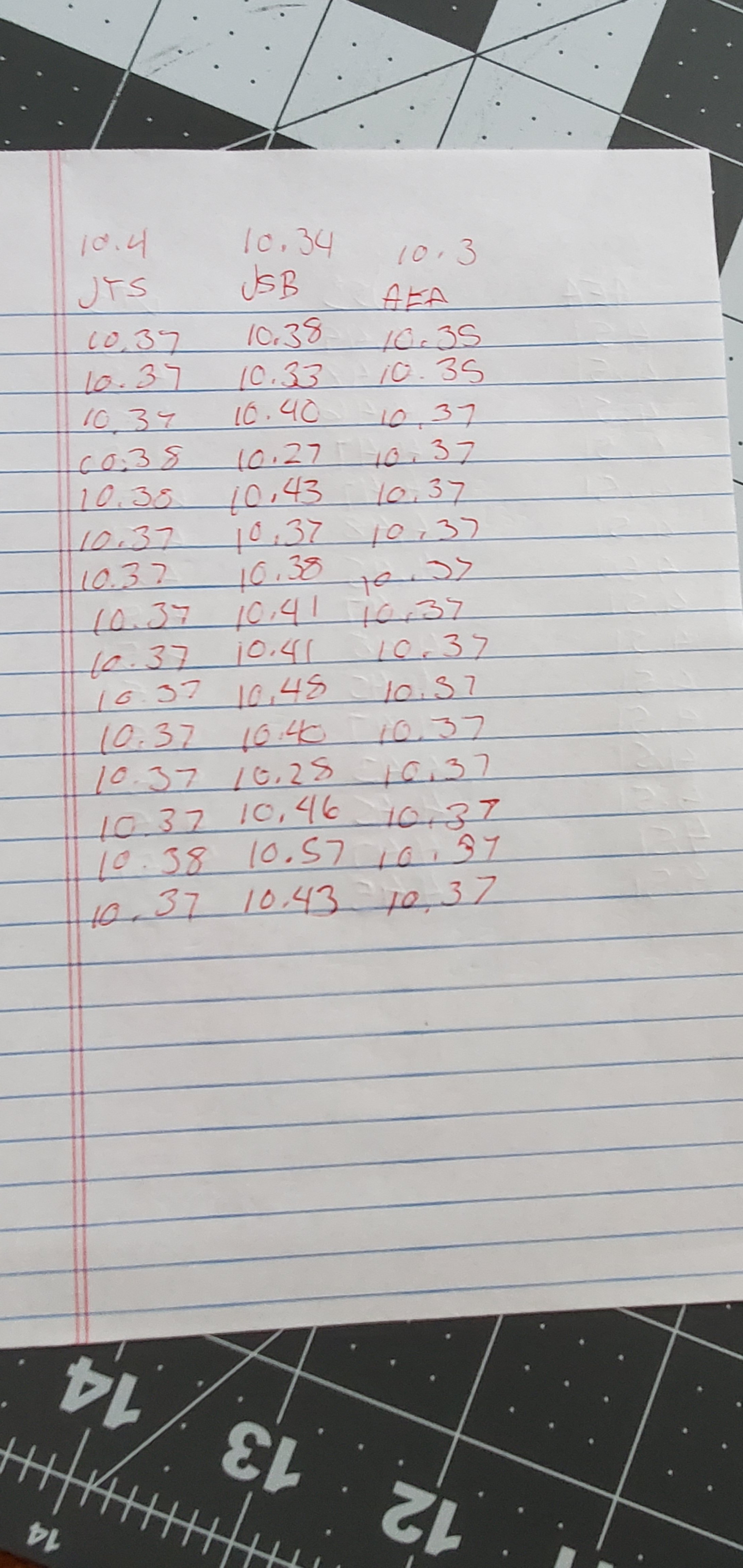

I can't speak on the .30cal but the .177 JTS 10.4gr and AEA 10.3gr are remarkable similar they look the same measure the same shoot the same taste the same. Are they the same, I can't give a definitive yes or no but I am definitely leaning yes.

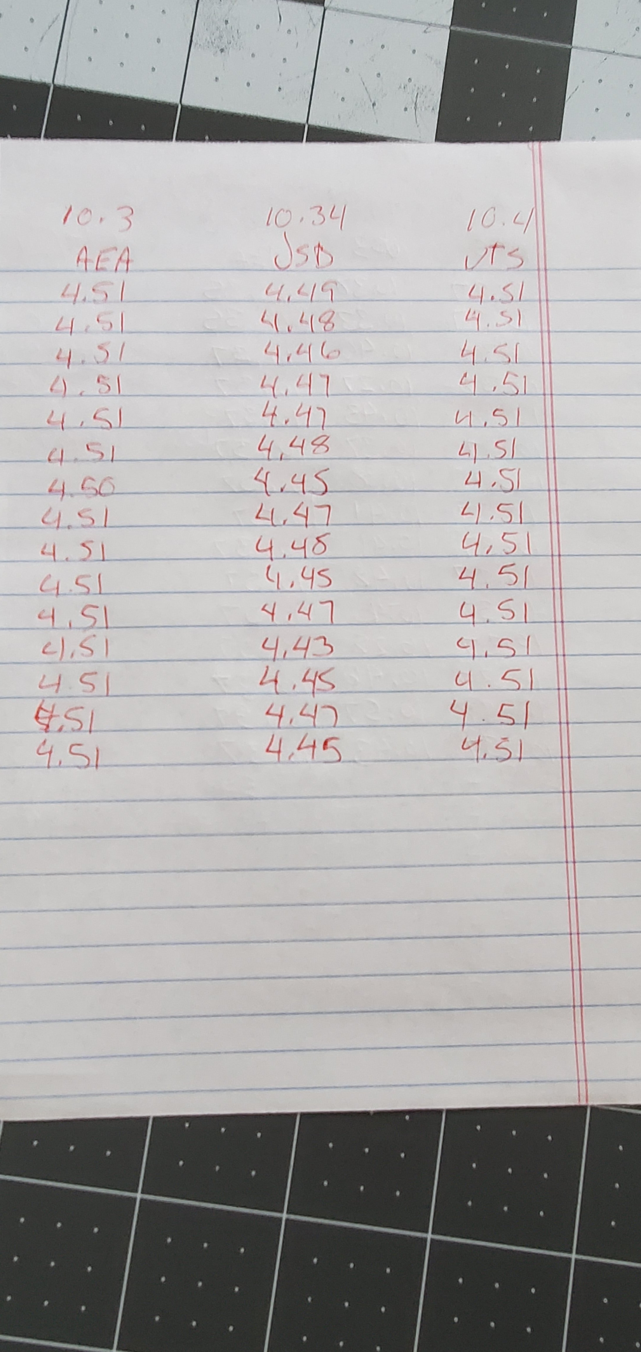

I have been comparing the two for about a week shooting and some measurements. Here are some weights and head sizes I wrote down .
I have had all the JTS offerings in .22 for a good while now and last week I received 3 different .22 AEA pellets that I haven't opened yet and I am expecting the same similarities. I will get to the .22s when I'm done playing wit the .177s.
View attachment 455421View attachment 455422View attachment 455420View attachment 455421
Daaaaamn! That is some insane consistency! You've definitely convinced me to get some AEA/JTS pellets I already dont buy JSB, usually just FX
Yes I have been extremely impressed with the consistency of the AEA and JTS pellets.
I don't really know how to say this but I'll do my best. I have also had great results with JSB pellets but the consistency from batch to batch or even tin to tin of the same batch is not there it feels like a crapshoot when ordering JSB pellets and I don't want to spend the time or money sorting the orders and sorting the pellets in each tin to get consistent performance.
I wasn't Into air guns when JSB pellets hit the market so I don't know if they where once as consistent as the JTS and AEAs are now and I guess only time will tell if JTS and AEA can maintain the consistency they currently have .

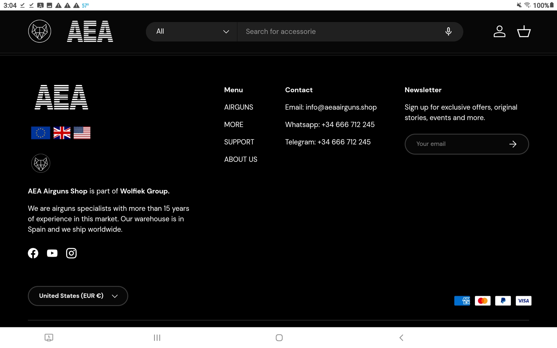

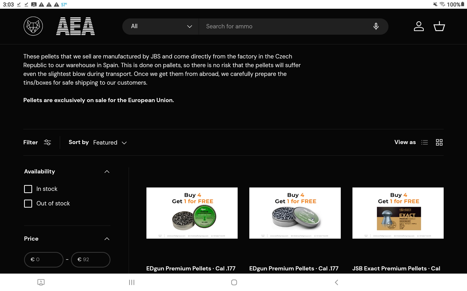

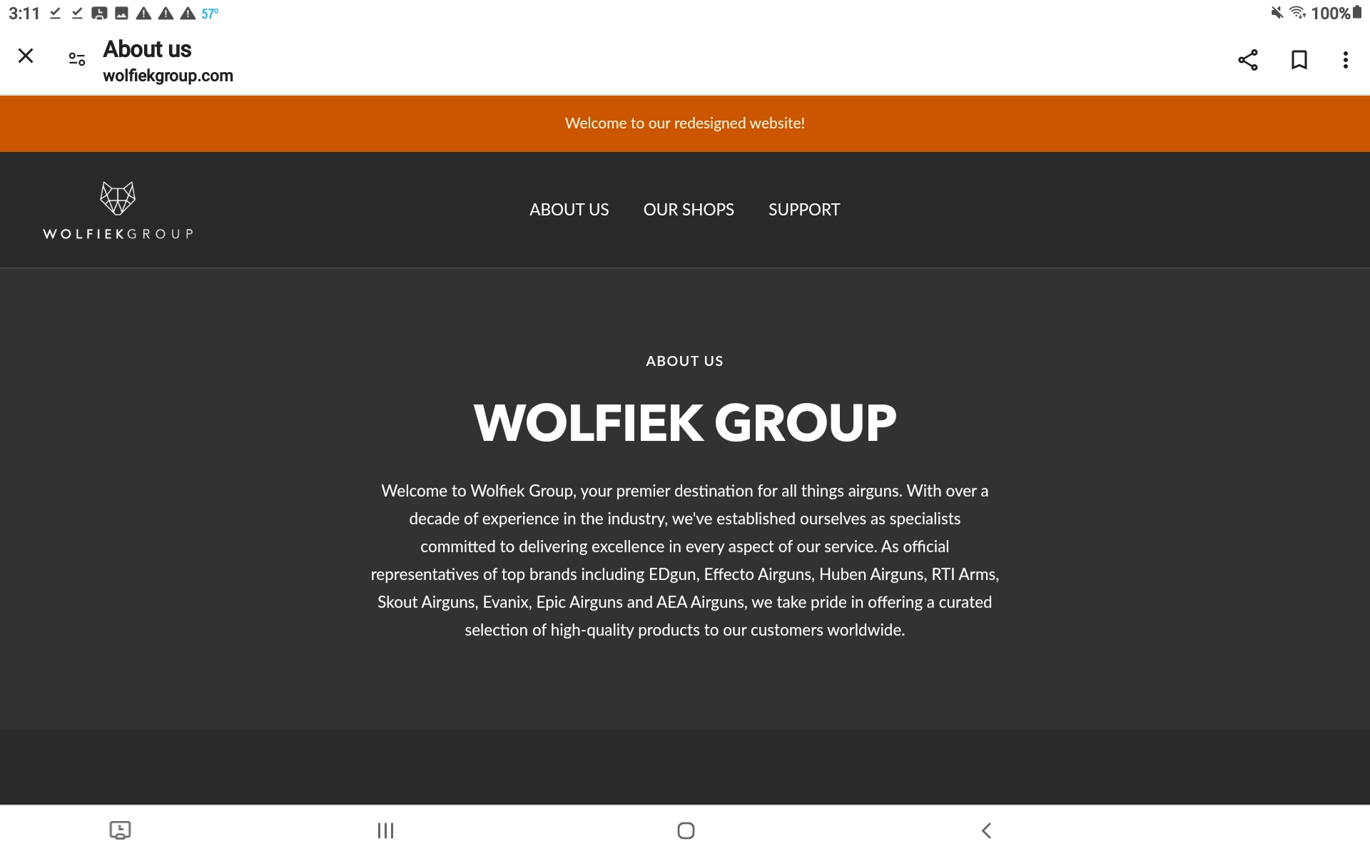

"These pellets that we sell are manufactured by JBS and come directly from the factory in the Czech Republic to our warehouse in Spain"
The above quote is directly from AEA website. I just Googled AEA pellets. (Pretty sure they meant JSB, not "JBS")
Hmm so same company, but different brand new and different dies?
That not an AEA website it's a Wolfiek group website they look like a reseller of sorts from Spain that represents several airgun brands and have a website for each of those brands.
On the site that quote is form they are talking about mostly edgun pellets ( JSB ) and also a couple styles of the JSB brand pellets. There are no AEA branded pellets on the site.
