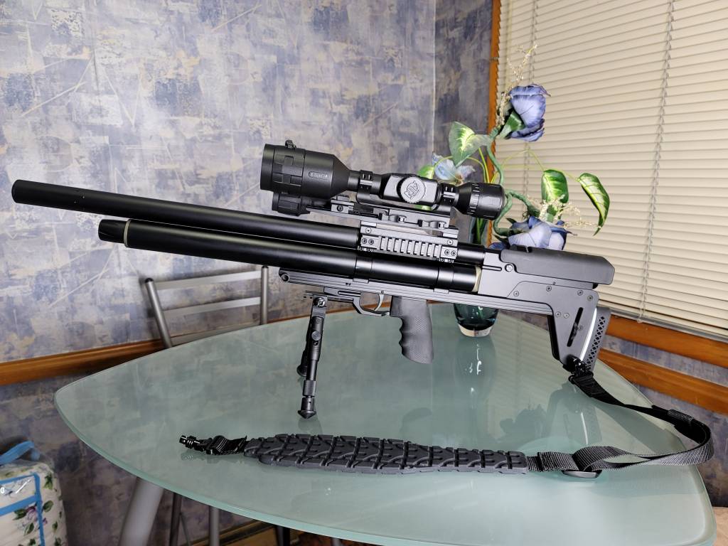

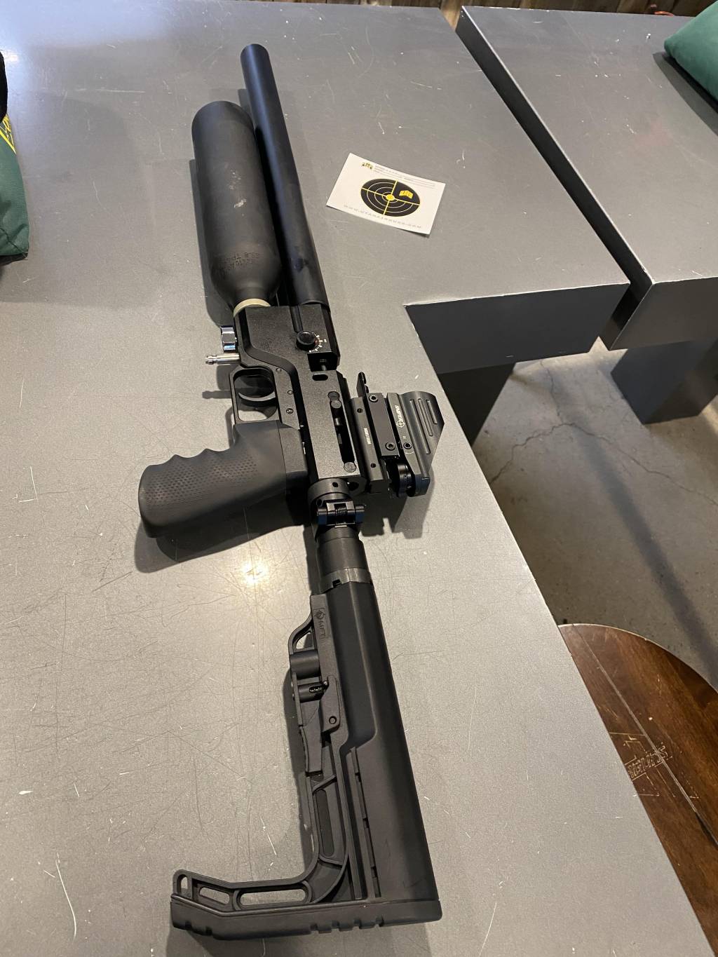

I had an AEA HPBP .25cal pictured below.
I cannot recommend them. Let me just list the issues I had with this gun before I sold it at a significant loss:
  • Semi-Auto function prone to jamming, and when it jams you may destroy a magazine. I destroyed two magazines that way.
  • The gun was supposed to be an 80fpe gun, but the one that I got was just a tad over 50fpe. I complained, and they said they would send me the strong spring to give me that power, but the spring never came.
  • You see the pic rail that the bipod is mounted on? That is only mounted to the frame with one screw, so with the least amount of force it will spin. It's also the same piece of metal for the trigger guard. Eventually, I sent it back, and they tapped another screw in to remedy it.
  • There are no sling mounts on the gun. I had to add my own MagPul style mounts so I could hunt with the gun.
  • You can't mount a suppressor to the gun, because that will mess up the semi-auto functionality.
  • Trigger pull was around 7.5 pounds
  • EDIT: Forgot to mention the bolt is so hard to pull back, I have to sit the gun on the ground butt first and put my body weight on it to cock. After doing that three times, the palm of my hand is too sore to do for a fourth, so I had to get a six inch long 2x4 to take the pressure off of my palm.
They push out models super fast, which makes you wonder how long you will even be able to get support for the model you just bought. Just count how many models they have come out with just this year, I think it's over 10 different models, and I'm not talking about different calibers, that is just the models! Add in the caliber differences and you may have over 50 different guns!
EDIT: They also make changes to their guns mid production run without changing the model name. Who in the world does that? How can you ever really know what you are getting>
They saturate the market at the low end pushing cheap semi-auto and big power. With all of that said, my gun was accurate, but they accuracy would suffer because of the super heavy trigger pull!

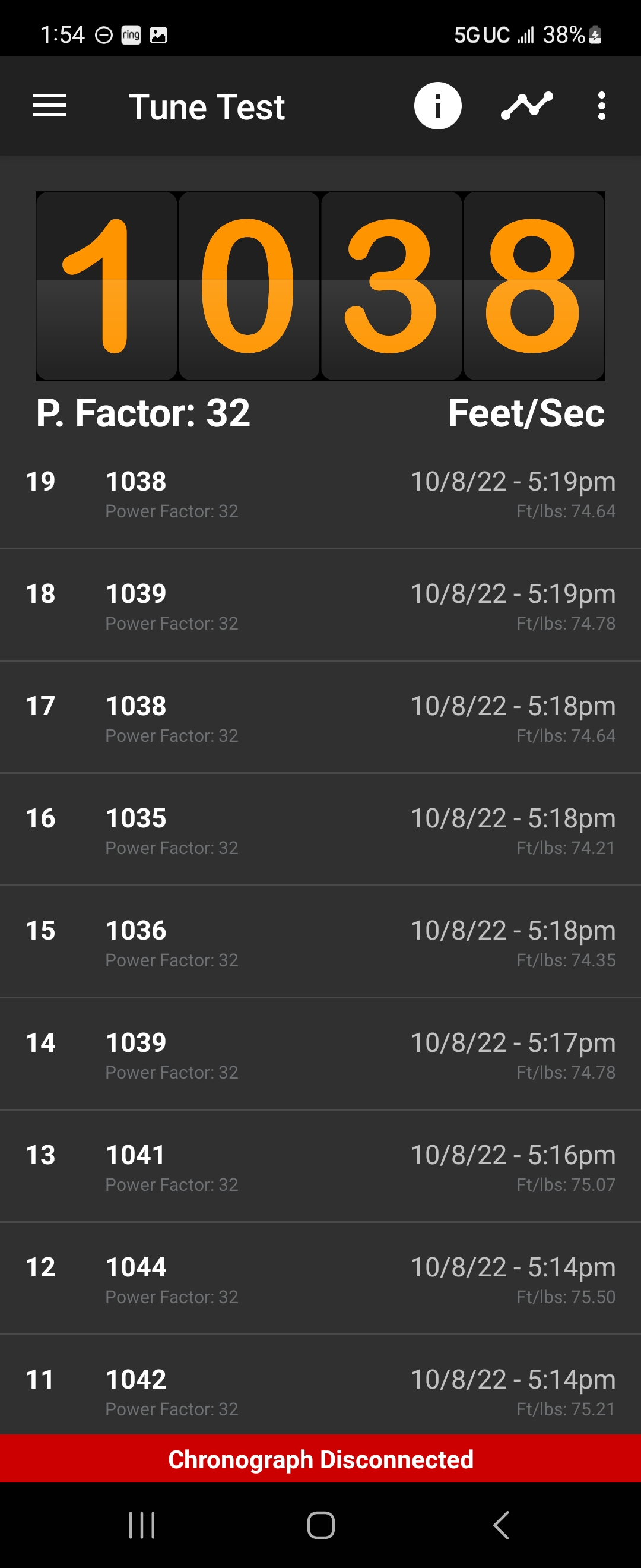

I just picked up the aea challenger pro 22 cal, And love it. Easy to tune and it comes with two hammer springs, and they are easy to change and has a barrel tensioner. This rifle is a pain in the butt to bleed out all of the air to make a reg change. But once you get it set, you shouldn't have to do it very often. Mine was shooting 1082fps at 81.10 fpe out of the box with nsa 31.2 slugs .218. I have since tuned it down to 1035 fps at 74.21 fpe and it seems to like it there. Moa to sub moa at 50 yards, still working on my scope and mounting. It's a lot of rifle for the money, trigger not that bad for me. Its alot better then my Gauntlet 2 was, Kinda the same as a hunting rifle for me. I do tend to do a trigger job on it soon. The cocking action is very easy and smooth, but the stock has some play in it where it latches. It's a milspec stock which you can find a replacement just about anywhere. I'm just going to shim mine, I don't intend on folding my stock any ways. The biggest drawback for me is that I only get about two 12 shoot mags (24 shots total) before I'm right at my reg pressure. So if you don't have a compressor or scba tank, you won't get much shooting in. That's one of the things I loved about my Gauntlet 2, I'm was getting around 60 shots in between refills. I only have about 150 rounds though it as of today, so I can't speak on reliability. But it does feel well built and a simple design. Like I said, I like it, I don't have any brand loyalty at this point. I picked this up to be a slug shooter, and it does it very well. I'm very optimistic about my future with it, and feel it's going to meet my needs easy. Good luck and hope you got some useful information from all of this rambling I'm doing, take care.
