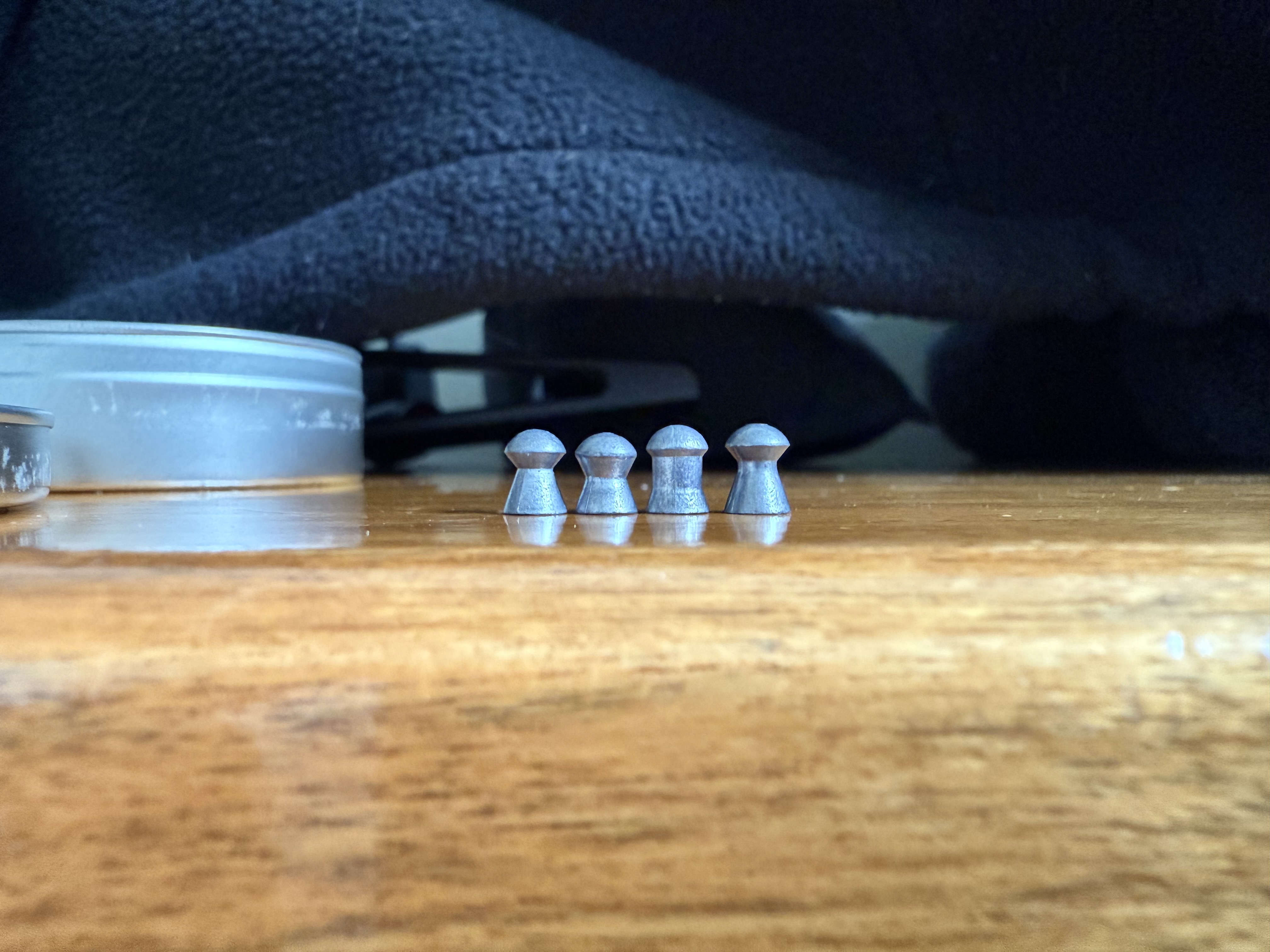

Given my success with AEA in my Ghost, I was thinking of giving the 8.72 a go. They kinda look like the H&N FTT 8.64.
The FTT 8.64 head size 4.52 you have to push a little harder than the JSB 10.3. Could be the harder lead, both H&N and AEA are harder than JSB.Ok, just finished testing multiple pellets. Each pellet was shot 5 times at 4 bulls at 10M off a sandbag rest. As you can see, my TX200 seems to like everything except the JSB 7.33 gr. The AEA 8.72 gr shot as well as the others, but the only thing I didn't like about them was that the head size seems to be a bit larger making it difficult to insert the pellet into the barrel. AEAs shot 779 fps and 11.8 fpe. FX 8.4 shot 809 fps at 12.3 fpe. Take your choice.
