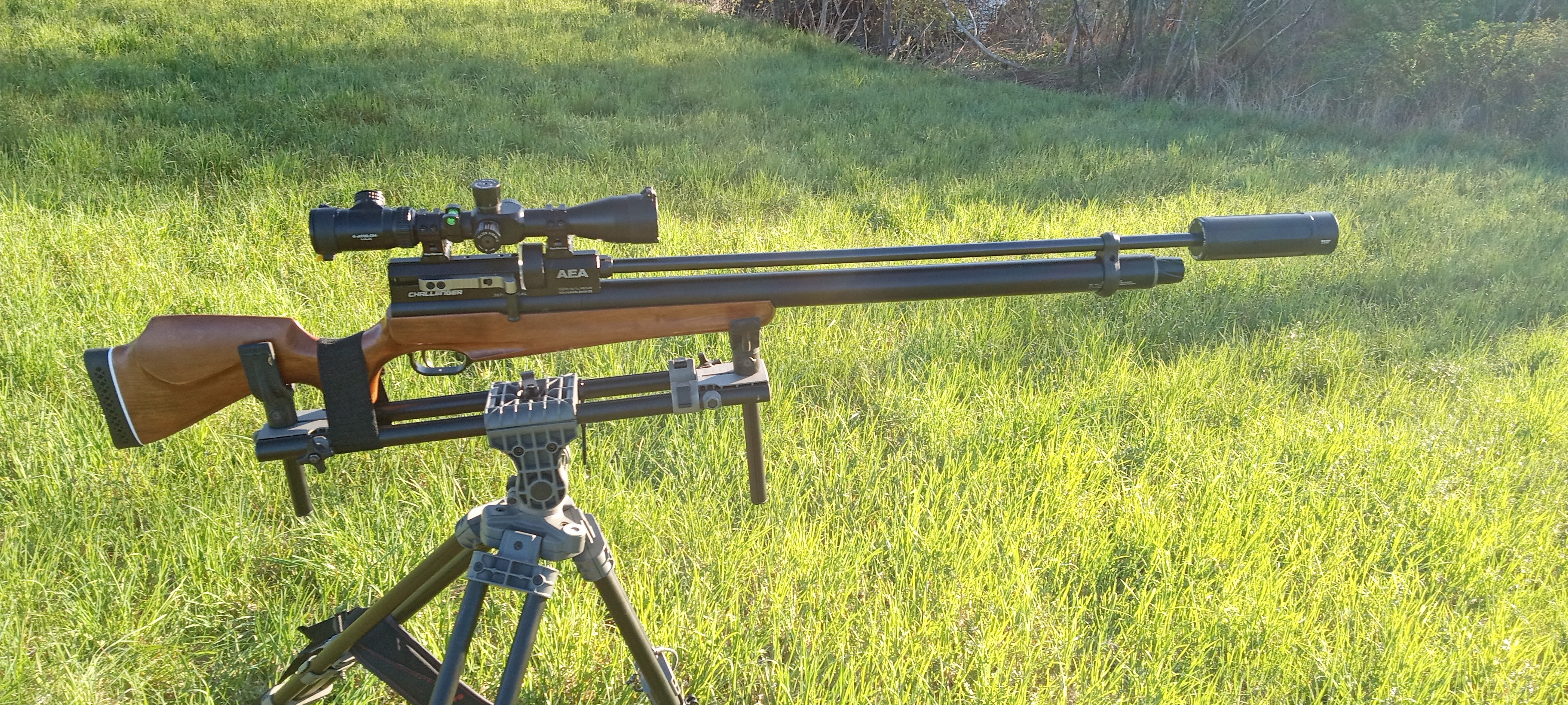

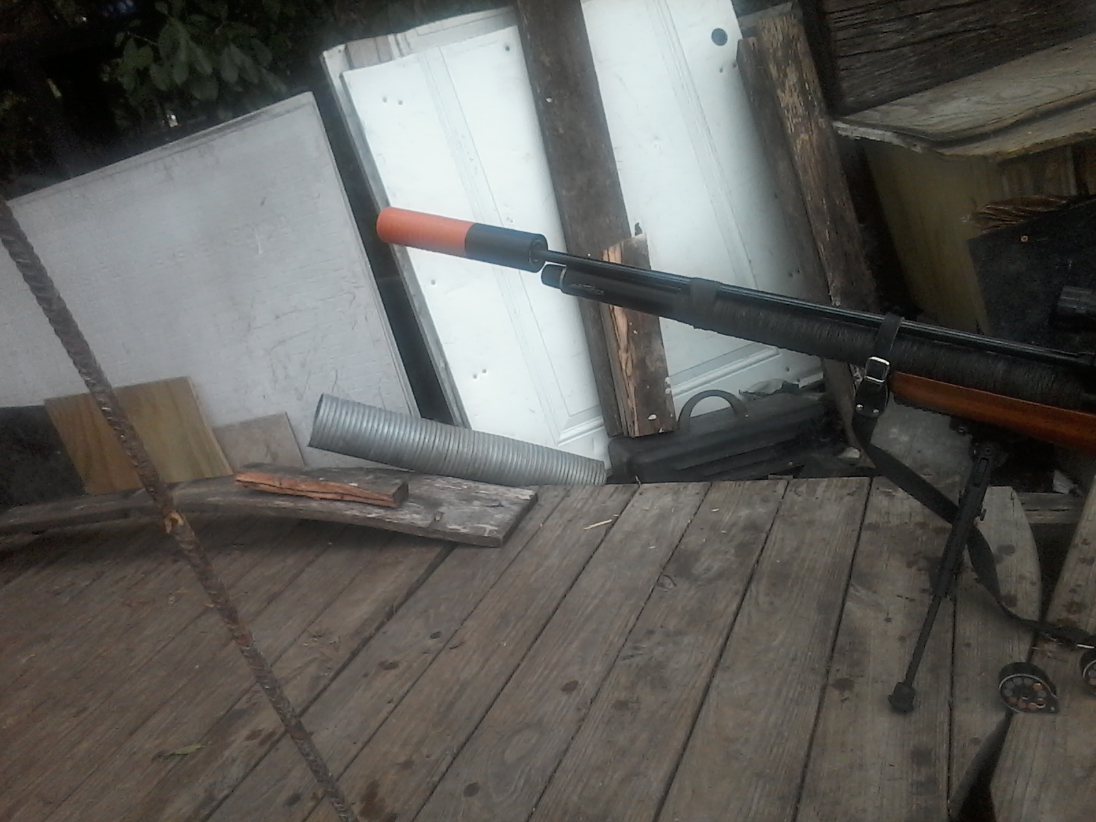

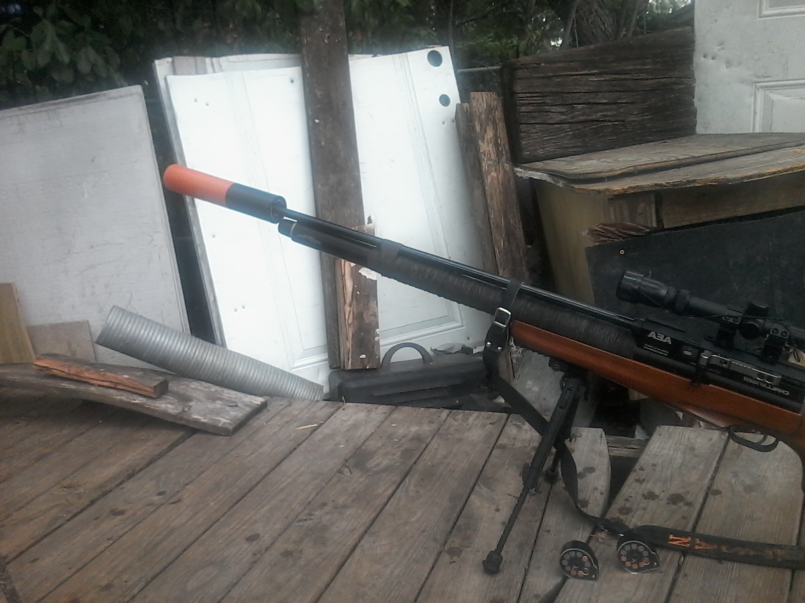

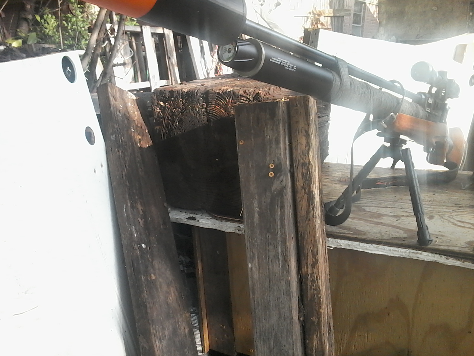

ive got this newest .357 big bore challenger it is the standard version has 10rd mag 600cc air cylinder, and really puts out alot of energy. ive added a 360 bipod think its utg and got the emperor moderator which ive took apart and done some stuff with it that makes it even quieter. removed baffles turned 90degrees and reinserted at front of mod, this gives more baffle and leaves a space near the back where there is a hole anyway, reinsert outer mesh and add flat pieces of rubber between outer mesh and outer casing, this makes the metal touching sound go away making a better moderator.

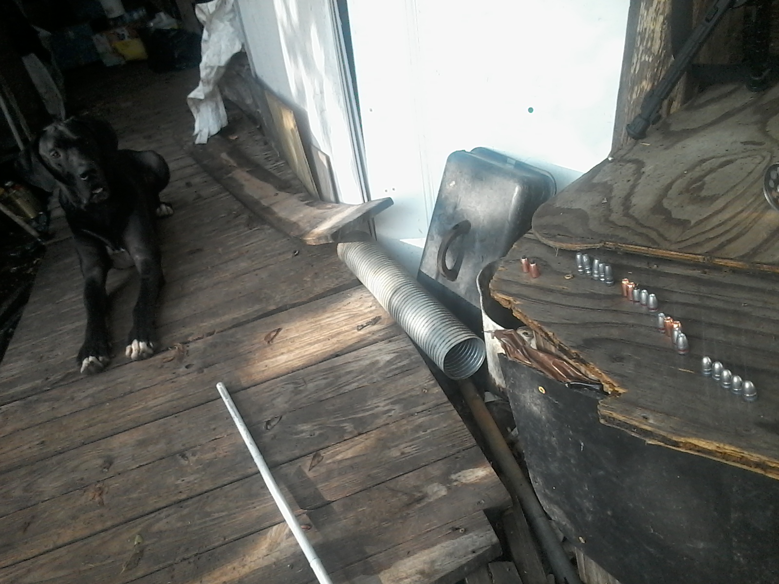

also doing my lead in with barrys bullets copper electroplated slugs, this will make the inside of my barrel shiny copper and even more accutrate than just the lead.(done this decades ago with a sherridan air rifle)
add a pick rail at the underside of stock to mount my bipod to. used a 5inch rail from end of wood stock holes drilled screws tapped its good bipod is set and air rifle can be balanced with less than 3lb force on stock.
added rubber recoil pad on top of original rubber recoil pad giving myself another inch and a bit more cushion, makes the operation of side leaver easier can now operate side leaver with one hand by using elbow against rubber recoil pad , can do so with right or left hand cool.

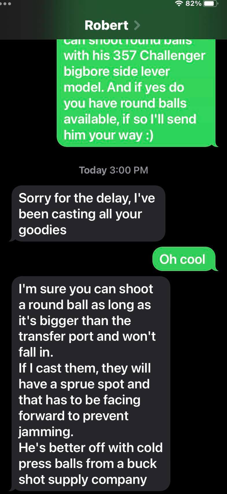

I'm just following advise from Mr Hollowpoint and Bin Lu T hey has for more experience then both of us put together. plus i don't really need it. below is what i was told . i'm not willing to go thru all that when i have so many slugs that i can use that do the job very well.

Your right, its not made for round ball, there are risks that i'm not willing to take,lol there just as dead with slugs.

Well, I can tell you that me and a ton of other people have shot .360 roundballs from Ballistic product out of all kinds of .357 guns and I've never heard of any problems and certainly not ever of Roundballs falling into the transfer port.
If you have a single shot gun cast roundballs are fine since you can place the ball the way you need, for magazine guns swagged balls are the go.

anyway i am still looking for a website that sells 180-220grain slugs in pure lead in .356 or a pure lead .357since the 200gr templar i use is .357 supposedly it says .357 but it gores into the breach as well as the 125gr .356cal bullets i started with. those damn sexy ranger bullets.
do you know if our big bore .357 barrels are actually .357 or what, i mean can we put .358cal lead in these rifles?
im working with this gun know.. whats the best size you guys have found.. .357 .356 or .355 i have run some 357 they are doing ok at 50 yards but not as good as i would like them to be
well ive had .357 that shot good and some that scares me to shoot, the .356 seems to shoot better the barrys bullets copper electroplated .356 makes a screaming as it leaves the barrel which would be useful inside during an invasion but otherwise its just fingernails on a chalkboard, and the .356 that states 9mm and the .356 from the 38special/380acp both shoot different. the.355is the surest that will fire but also the least accurate..
course concerning accuracy the steel ball bearings 11/32 inch wrapped in a aluminum bubble gum wrapper is absolutly the most accurate but you will be better off with actual lead and i suggest the .356 for general lead bullet reloads from the reload sites, or the .357 from the high end pellet places like ksi and lucky 7 and mr hollowpoint cause those .357's will probably work . like the 200 grain templars are.357 and they work great better than the .356 from barrys. but just my opinion the barrys bullets and gt bullets are the best cost wise and they shoot fine. and of those i myself am going with the gt bullets 145gr its a semi-wadcutter and also a hollowpoint and they are great priced and the 130grs i just got shoot wonderfully, and that is saying something since they are 130s. so i am going with the 145s and then the 174 grains in .357.
if you can get a slug that is hollow base and hollow point in .356 it will be good no matter the weight but that slug at 140-160 would be my choice, since i cant find one in 180 gr...
