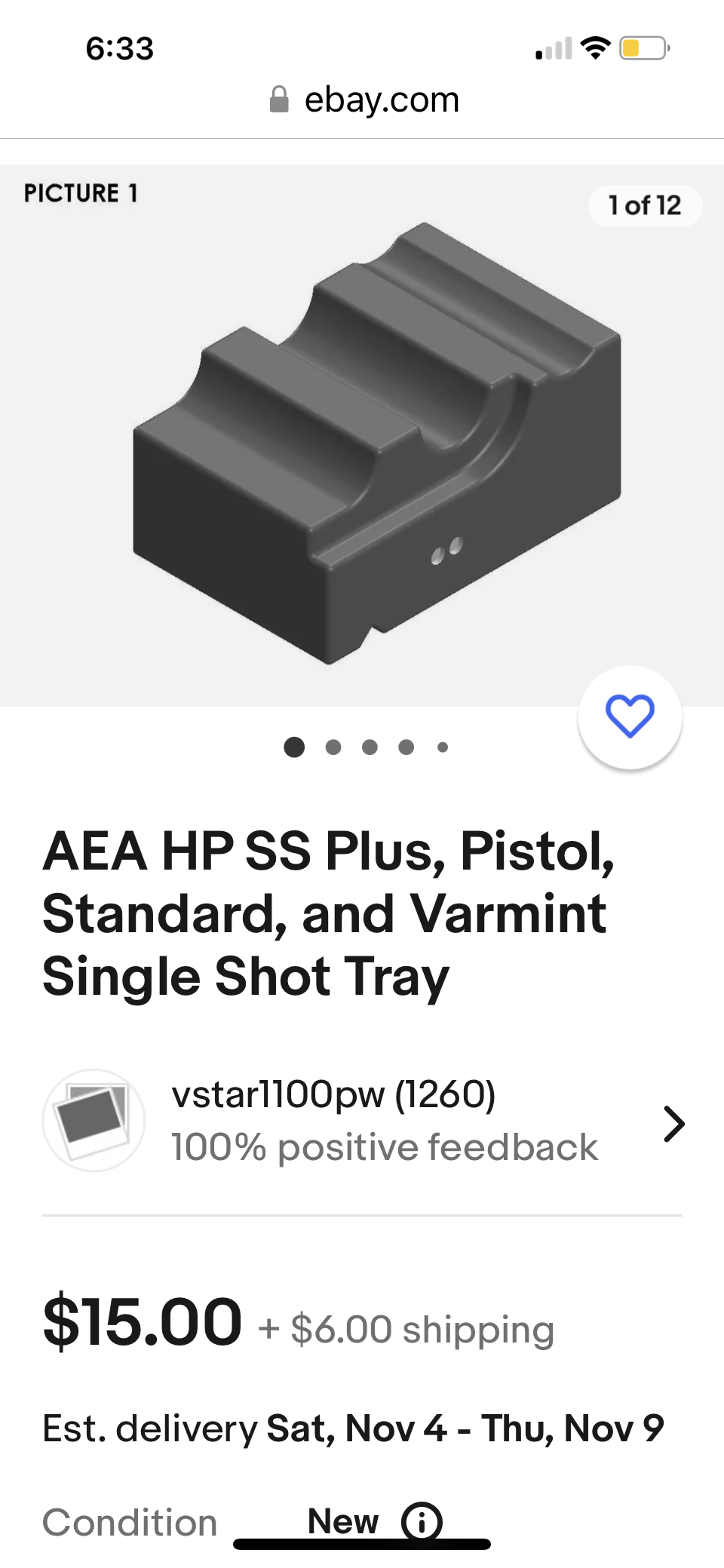

I wish I had the STL files to print single shot trays. @20 for a tray is a little much.

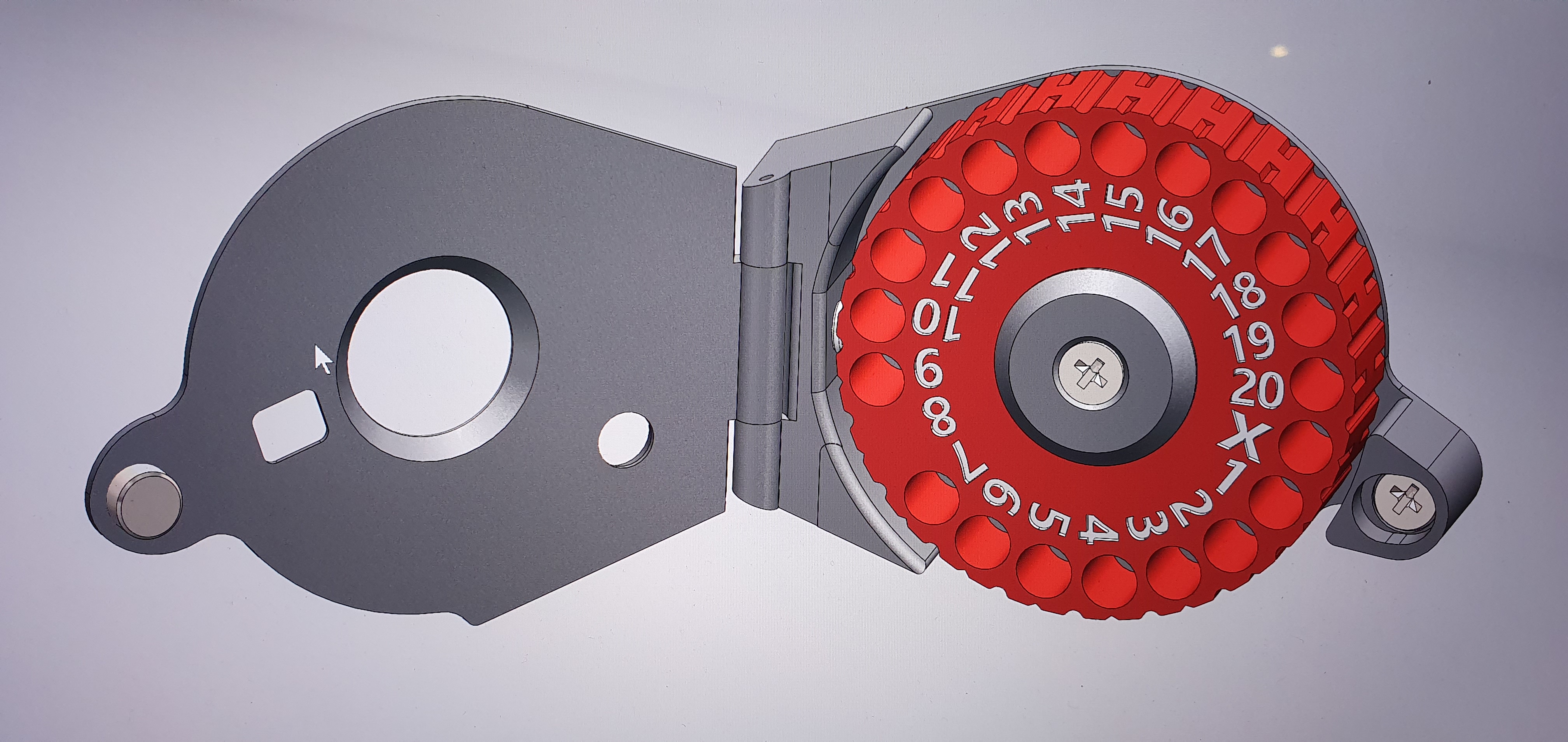

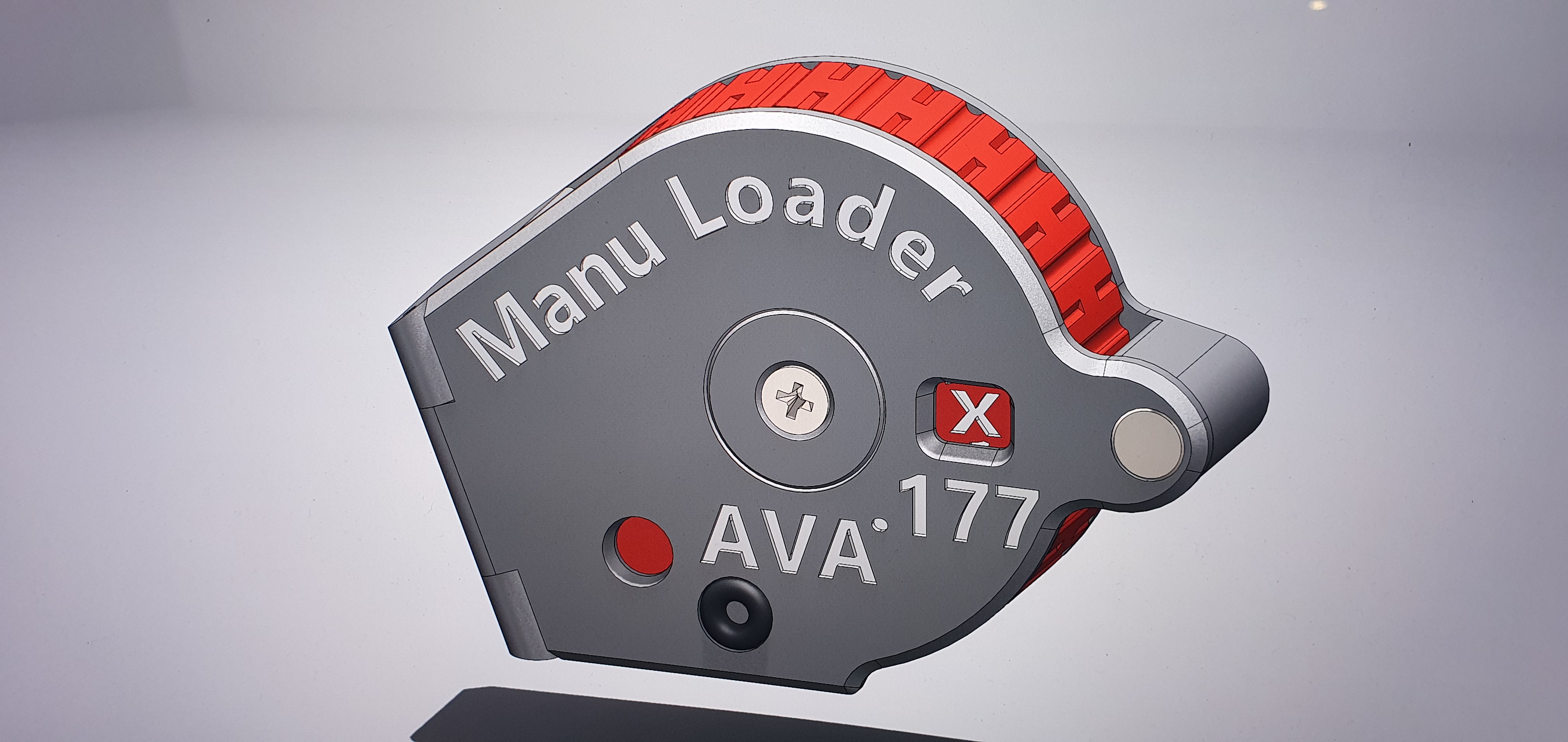

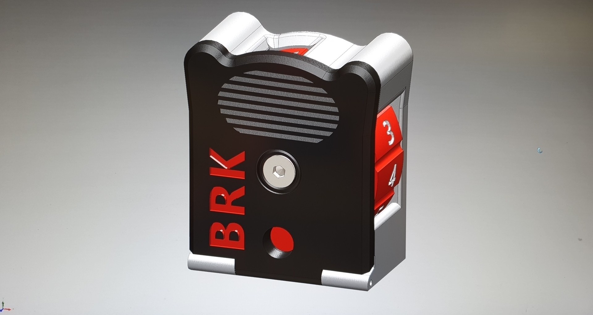

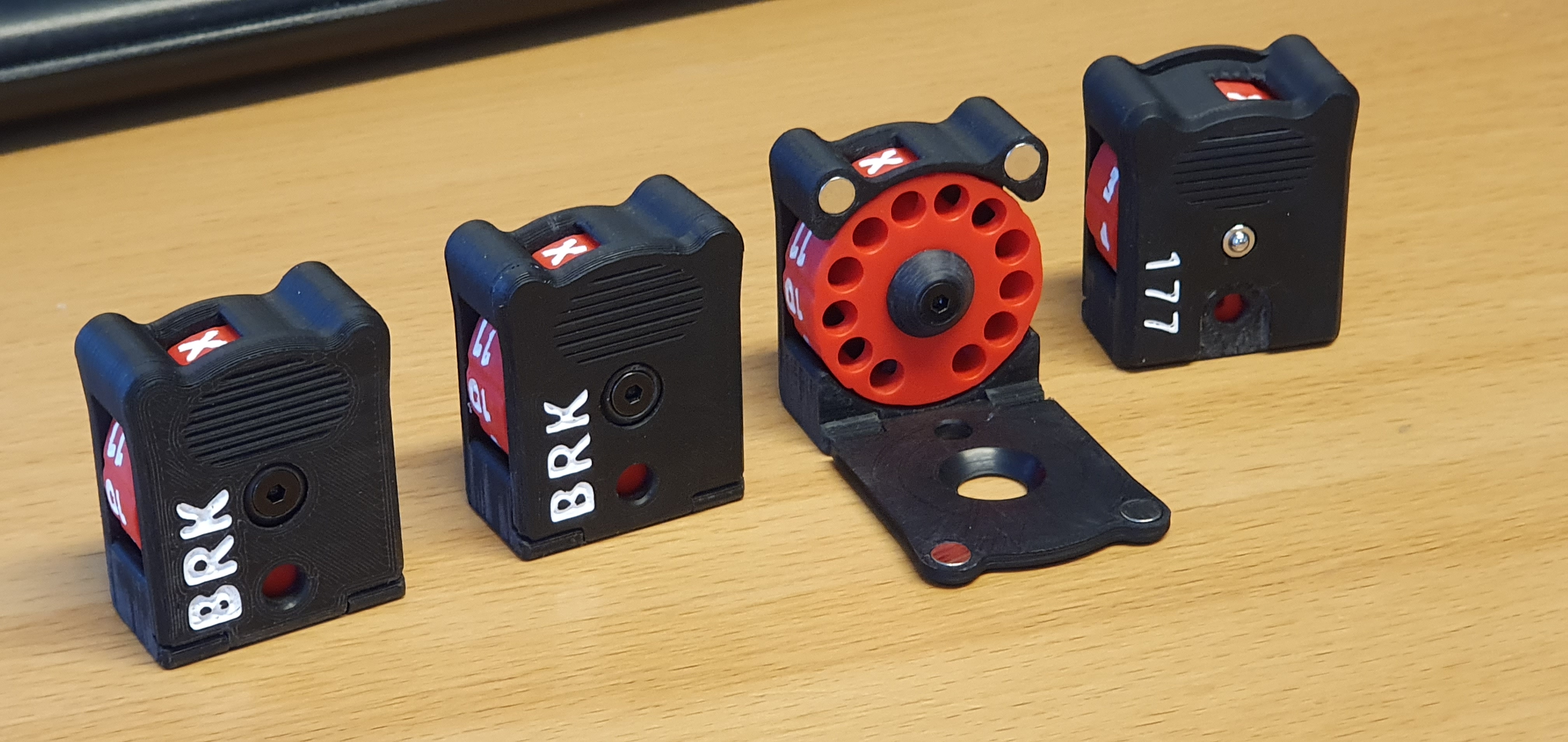

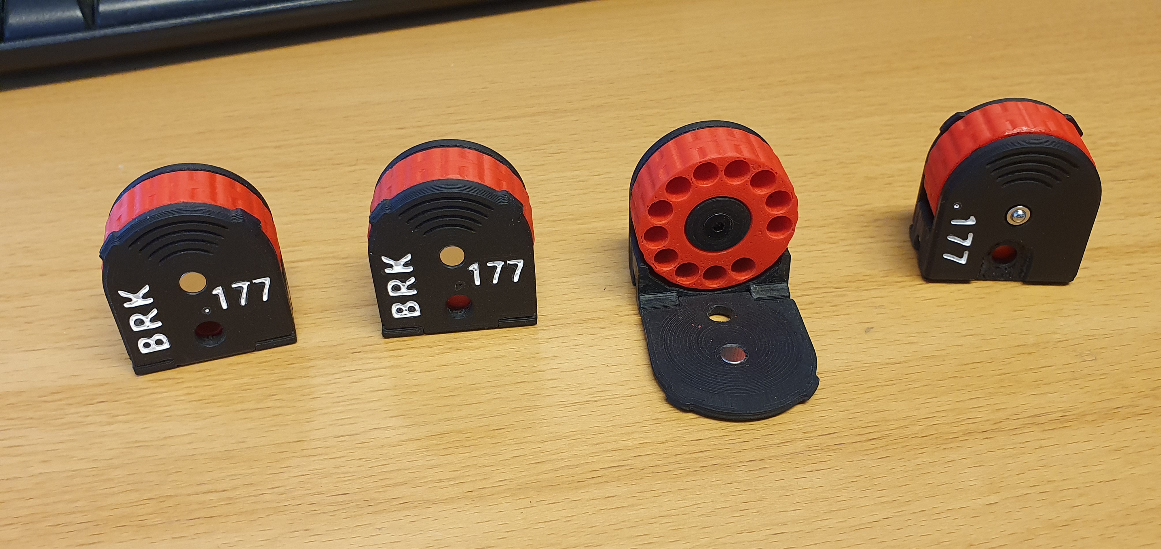

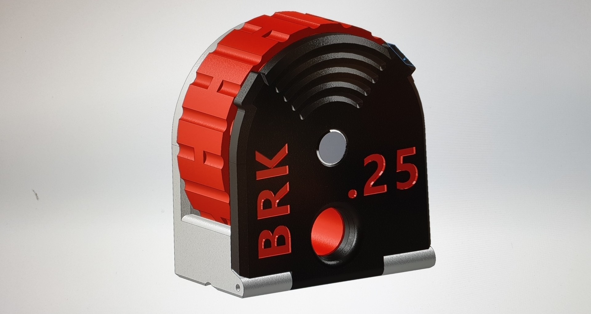

To Perle - and just as info to other shooting friends.

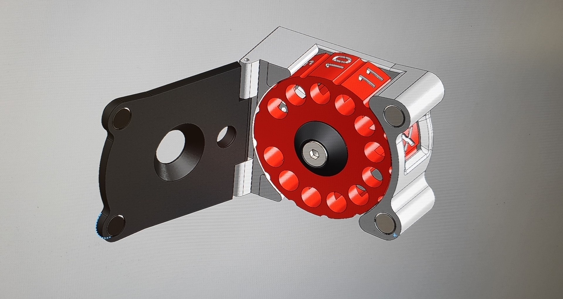

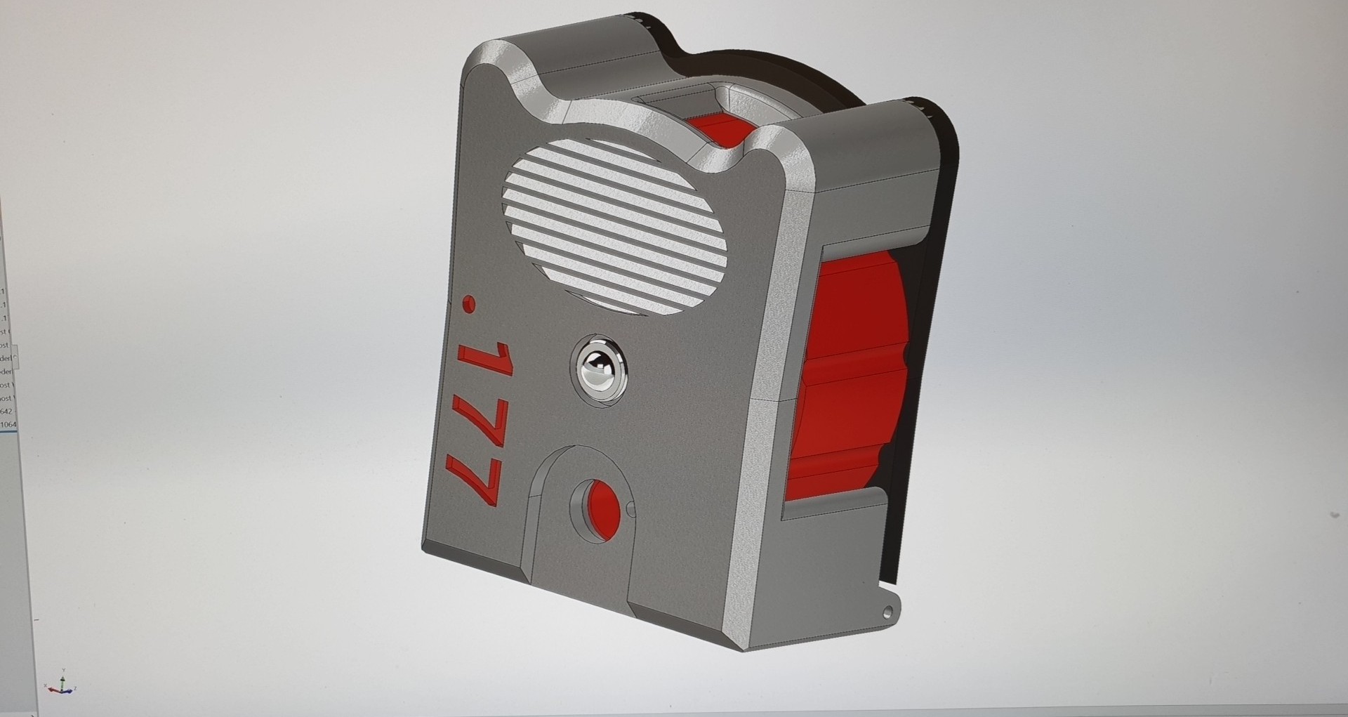

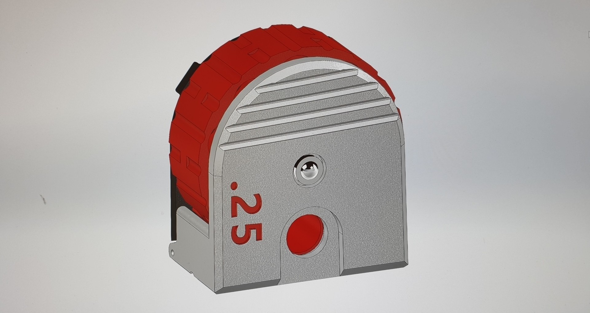

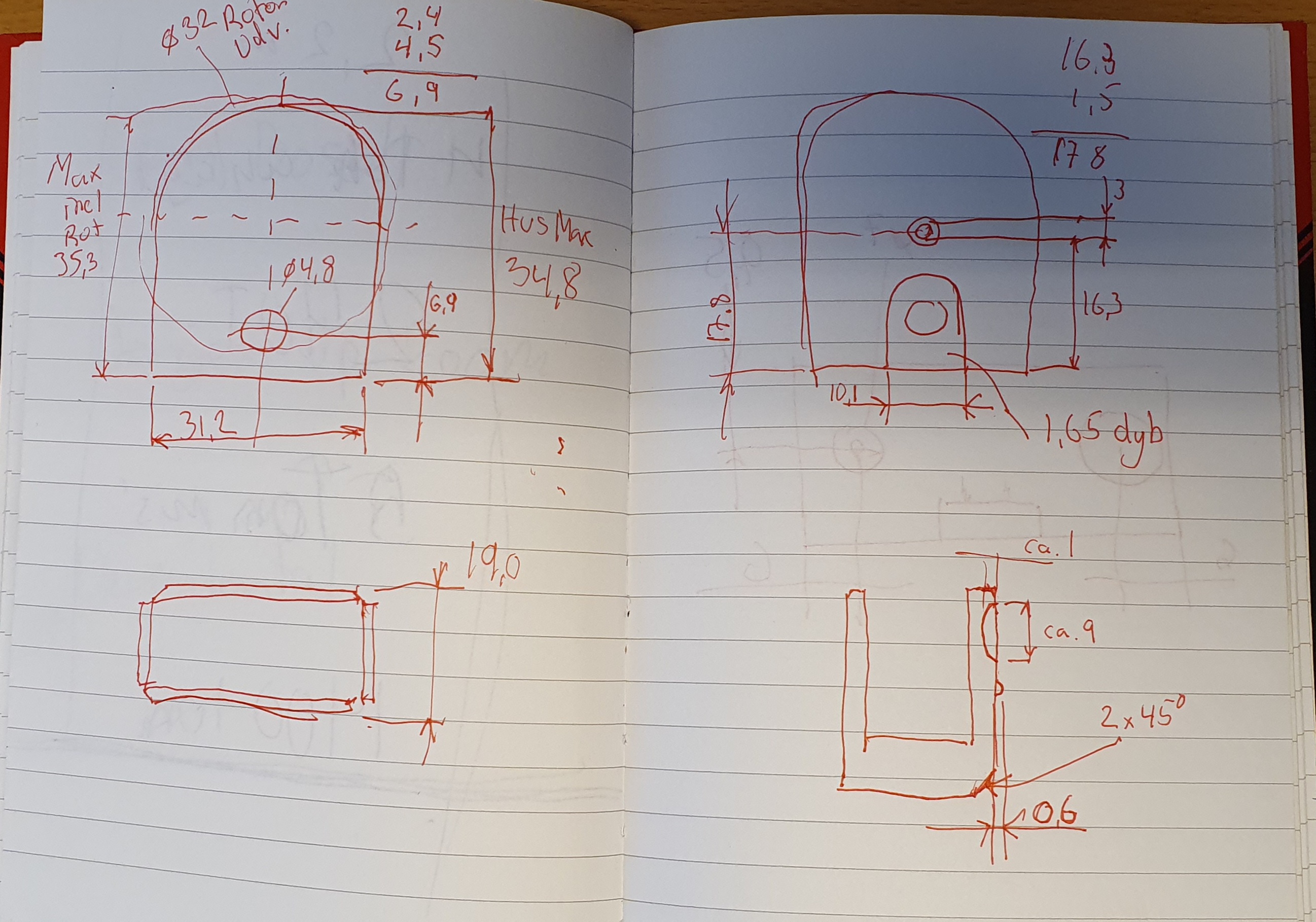

I am about to release the 3d Print files for AVA multi single loaders in .177 and .22 and .25 in this weekend.
Here you achieve the same accuracy as with a single loader.
It works in the way that you load the mag. with pellets og slugs, insert the mag.
Now turn the rotor one click manually by hand - a small spring loaded steel ball secures the 100% alignment of the rotor to the barrel.
Shoot and and cock the rifle again - turn the rotor another click.
The remaining shot counts can be seen in the small window.

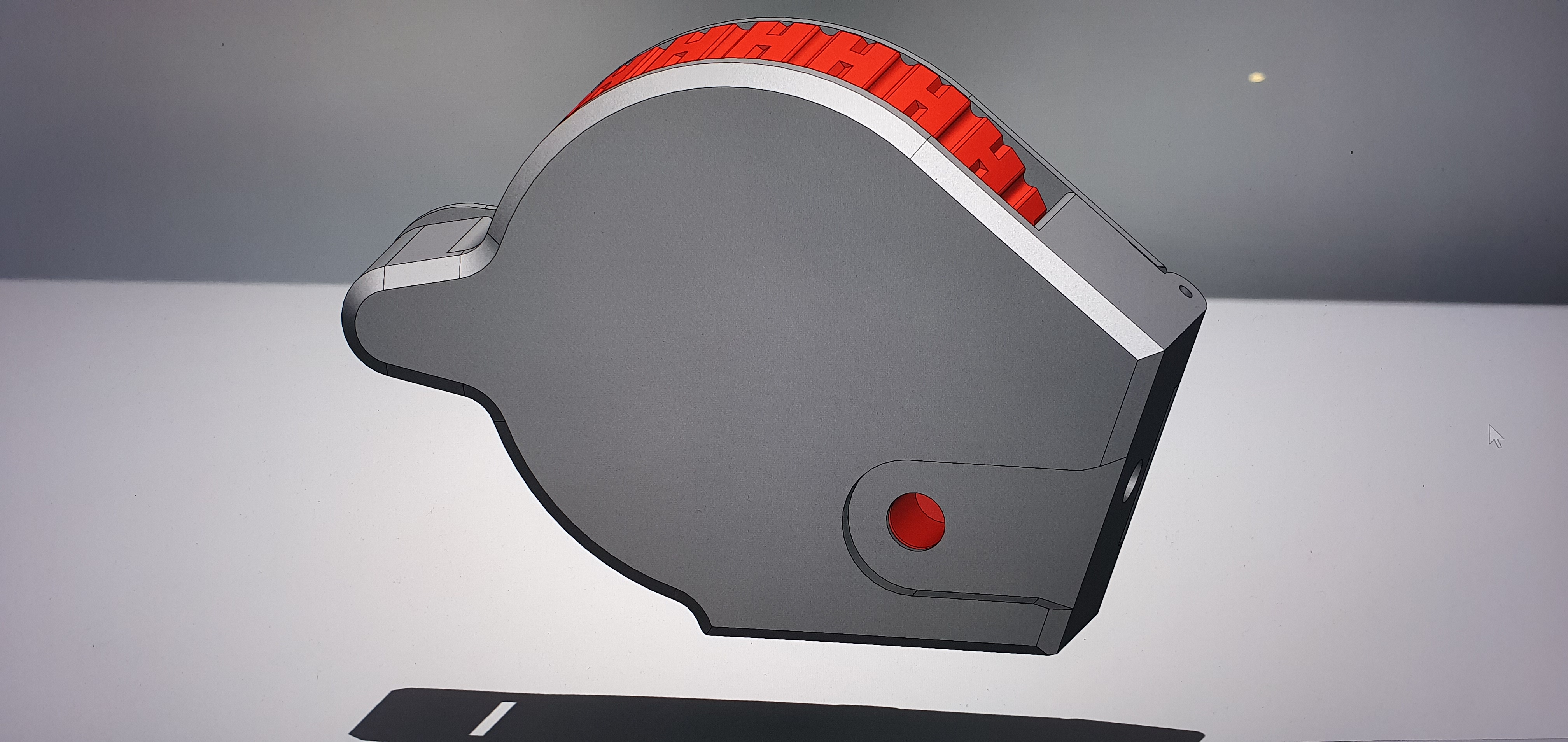

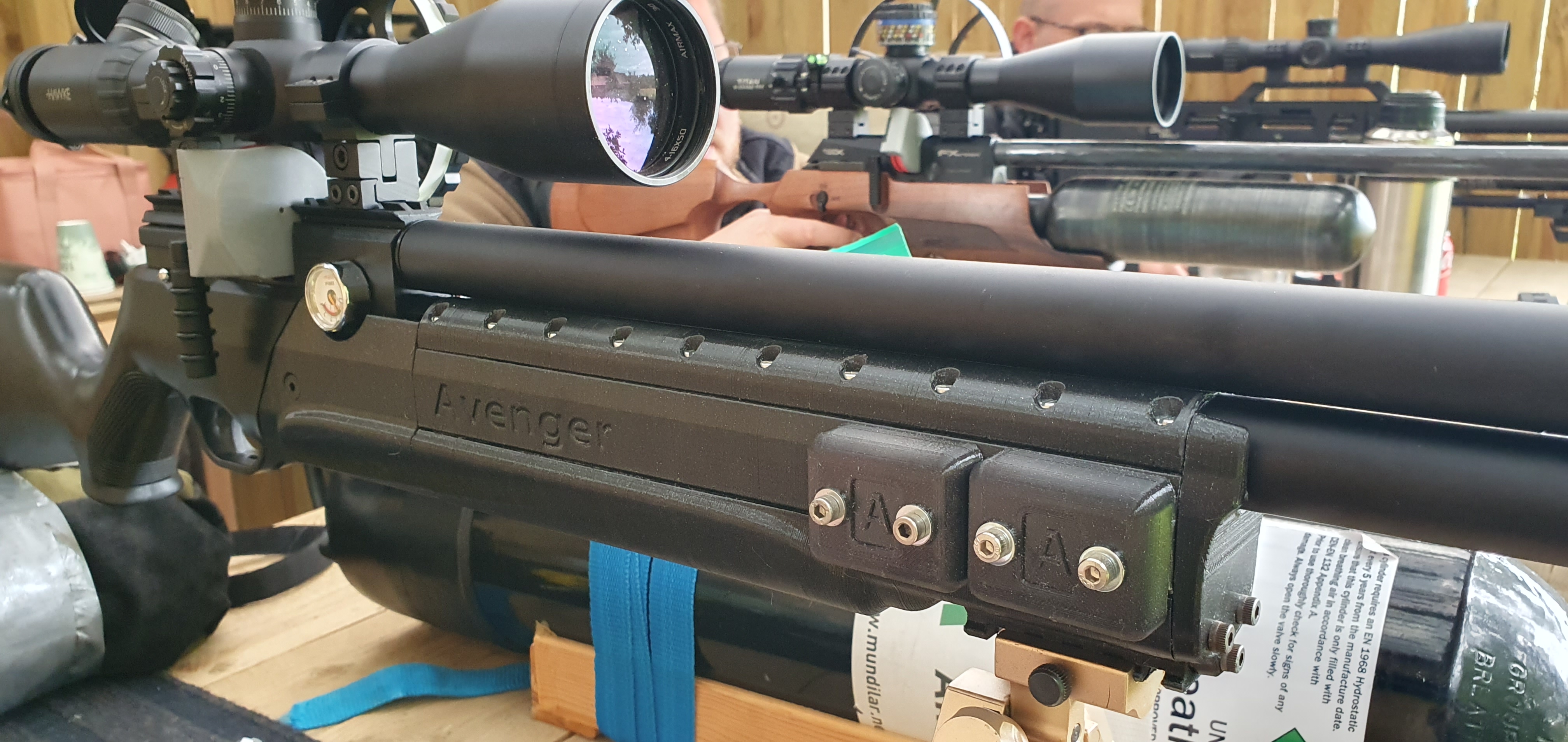

When i shoot pellets in my Redwolf, Avenger, or Crown I always use my Manu Loader (hand feeding) system. And accuracy is on pair to if i feed the barrel manually.
I also offer Avenger and other brand files for traditionally magazines both in Slug versions and also for my Pellet Care Versions.
The print files will be uploaded and available from here:
Please note I currently have no interest in selling the finished magazines.
I just find it funny to design, test and continue optimizing the design until i achieve a perfect and satisfying result.
Then I 3D print and finish magazines to myself and to my best friends.. That is enough for me - I continue to the next design projects.

View attachment 402590View attachment 402591View attachment 402592
