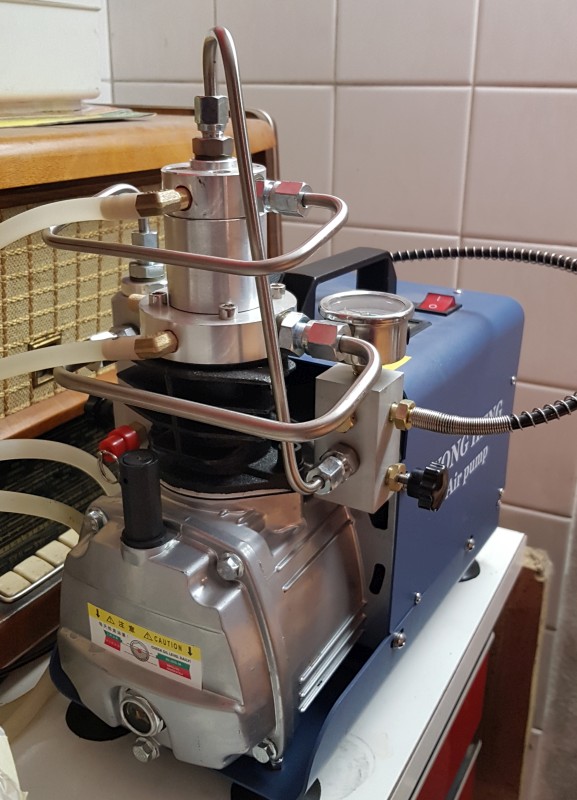

My story with yong heng in short... the begin of March 2020 I bough yong heng compressor from the AliExpress. But in this time started 1st lock down in Europe so I ordered the compressor from one one seller in Polland who have only SIMPLE VERSION but I wanted hardcover with cyclone filter. Unfortunately I did not have any chance buy it from EU store. After the one week I receive yong heng of course simple version. As time passed I still thinking how to I could add missing parts During digging on aliexpress I found this https://www.aliexpress.com/item/32850995186.html?spm=a2g0s.9042311.0.0.27424c4d1kPCUw I though it will be finally everything what I needed but error!! One part has been missing. After that I though the mission failed but big thanks to biohazardman advice me in this thread https://www.airgunnation.com/topic/help-identify-one-yong-heng-part/?referrer=1 small part which is needed swap from original one.
Last week I tried successfully to rebuilt my simple version to hardcover
Before
AFTER
Before
AFTER
