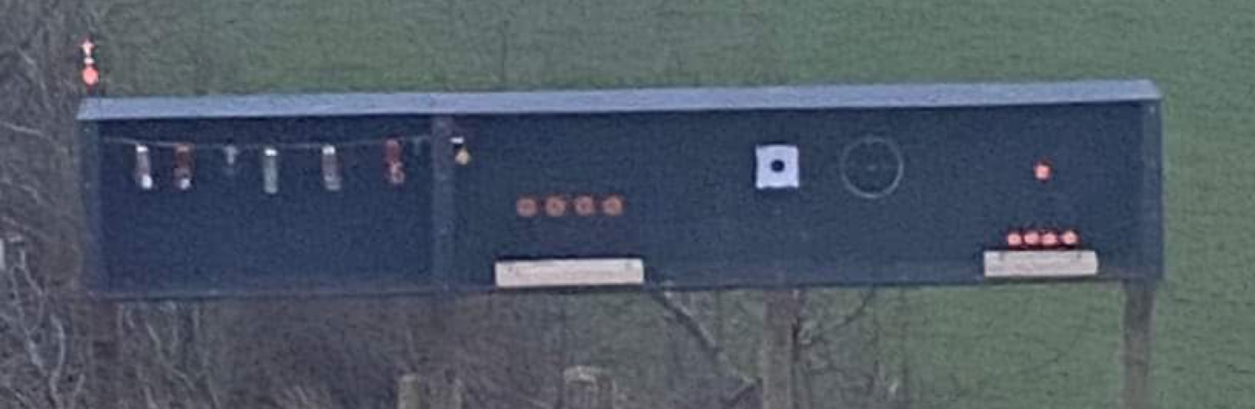

Yes sorry. It’s a regulated Airarms S510 ultimate sporter. Just shooting for sport at my new targetboard in photo below. Know nothing about curves r chronographs or other technical stuff that I have been reading here 😂😂 I read the manual. It says to fill to 250 and refill at 150
