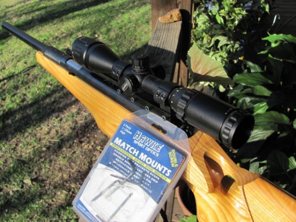

On my FT rig ( RWS 48/52) I used the Hawke one piece mount ( not using the stop pin )and never had a issue.

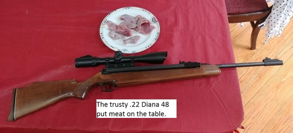

My '48 likes Crosman Premier Domes, H&N Field Target Trophy and JSB Exact 14.3. Both the tightest and loosest groups come from the Crosman pellets. The best average groups come from the H&N FTTs. (smaller head size) I took down a couple of skunks that were stinking up my neighborhood with mine, late this summer. It shoots Predator Polymags well, which is a bonus. They are devastating on game. Here's a squirrel I took down with mine. I have some detailed photos with forensics anlaysis, if you're interested. The scope is a UTG 4-16x44, 30mm tube, side focus "SWAT". A great value. They make one in the same series, but a fixed 10X. I'd probably get that one if I had it to do again. My '48 was made in the 90s.

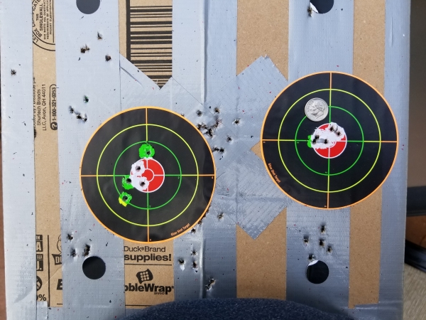

Today we got back from vacation. I setup a 20 yard range in my backyard. Shot 5 to zero in the scope. Then we each shot a 5 pellet group for practice. Then we did another "scored" 5 pellet group. My 9 year old had a blast and was getting pretty competitive with it. Here are the results of our 2nd and final 5 shot groups. She wasn't happy that I beat her (she was on left and I was on right), but I was happy with both of our performance (and the performance of the 48)!
