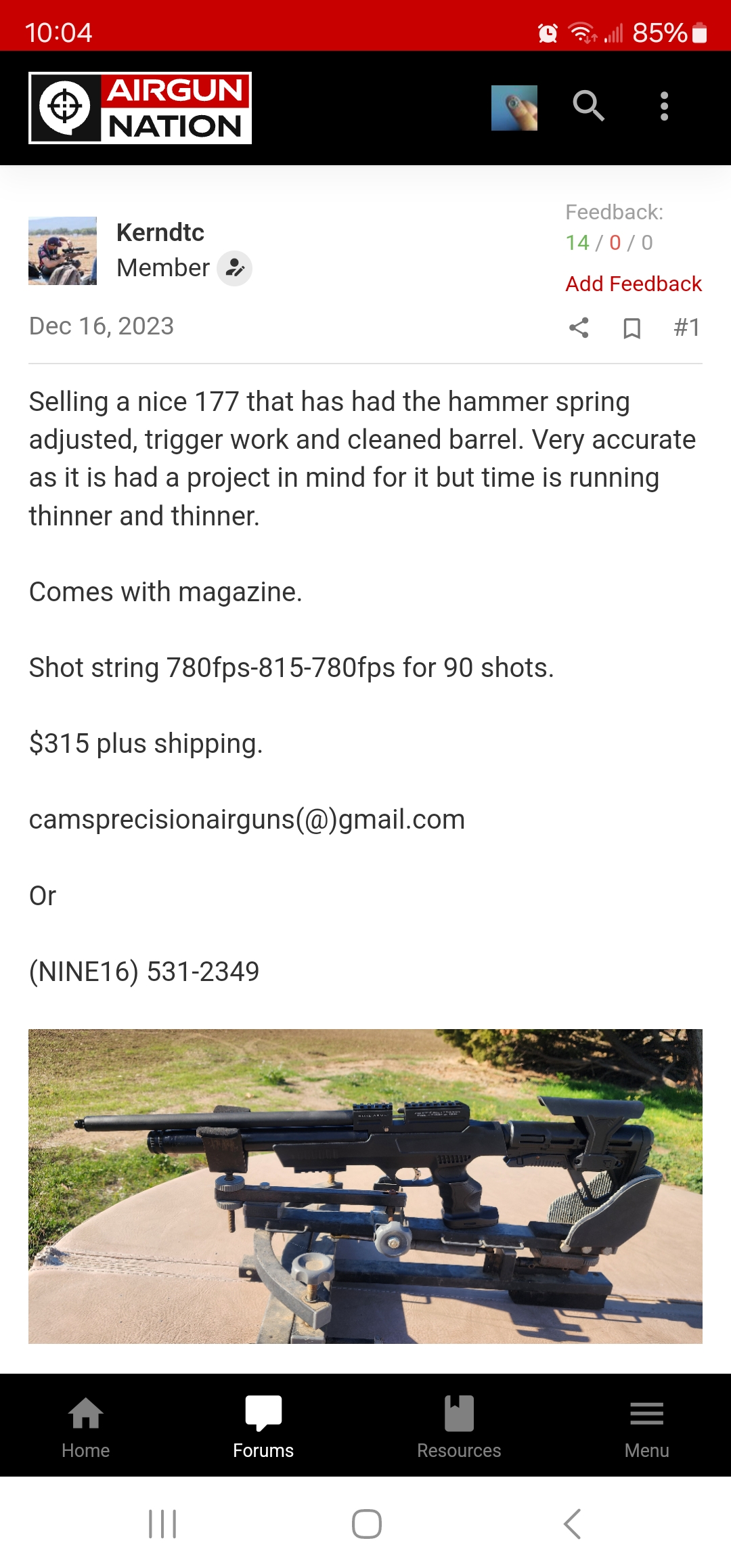

You can vet a $60 hand pump and there is a Kral NP03 for sale in the classifieds that would do all you need. Zero movement and easy to adjust triggers.
If you can swing it, that Kral w/ a $60 pump + a cheap Hawke Vantage 2-7 scope (all in for about $450 after a tin of pellets), that would be an ideal setup that would serve you extremely well and would likely vastly outperform anything else you would be able to find in your budget.
It will be very difficult to find a PCP setup all in for $200-$300. You need a way to fill it, and the vast majority of them require an optic which at the MINIMUM will run about $50 for anything decent.
