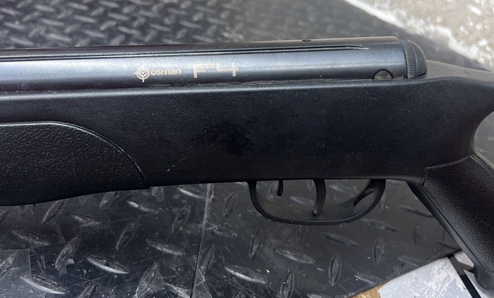

I thought we were talking about a multi-pump pneumatic. This gun is a gas-piston break barrel.
I found a picture of the top rail, but it's hard to tell what the dovetail size is. But that leads to another issue. You'll need scope rings with a recoil stop screw to keep the scope from creeping backwards. The rifle does have a stop pin hole already drilled, you can see it towards the rear of the receiver. I agree with Hateful McNasty that an 11mm would be your best bet. Assuming your scope is a 1" tube, 1" medium height Sportsmatch or Hawke rings with a recoil stop pin/screw should work.

thanks a lot. I will go with option one.
