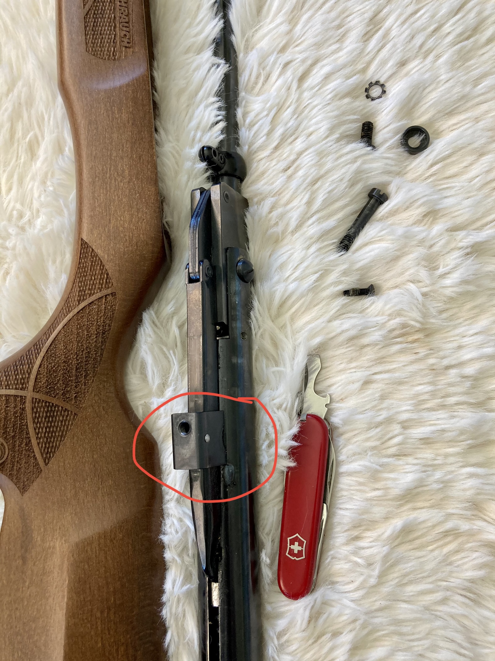

Advice for new Weihrauch HW30S - defective action weld
That sure looks like a warranty issue to me. Hard to imagine anything you could have done to create that failure. Warranties are covered by the manufacturer, I would start with Weihrauch and see what they recommend. They may have a US based option for you that would at least save the cost of shipping overseas. I would expect they will want to replace your defective gun, and have it shipped back to Germany to figure out what went wrong.

Well, my rifle is currently on its way back to Krale. Will see how that goes. In meantime, I discovered Tom Gaylord’s series on a new HW30S in 2021 had some discussion of the exact same less-than-stellar welding on the “bridge”.
It makes me wonder how many of the newer HW30S have the same kind of welding (and potential issues, as mine shows). Many of you have HW30es; if you’ve ever taken the stock off, have you noticed what your welds looks like?

Worst case if they won't help you anyone who is half decent with a MIG welder can easily fix that for ya. I just got a new MIG after being without for a few years due to some thieves who obviously need a few bumps of meth more than I needed a welder. This is an easy fix for someone with even intermediate skills. You will probably have to remove the spring and piston to avoid heat damage. Be sure to tell the welder to take precautions to avoid any splatter getting inside the tube and to avoid overheating the tube and getting it out of round. You can liberally lubricate the inside of the compression tube and that will make any splatter easy to remove. I would scratch some reference marks between the base and the compression tube to ensure proper placement as the welder is likely to grind away some of the old weld. Also try to get someone who is using shielding gas and not flux wire to minimize splatter. I wish you lived closer I could do the job in ten mins or less. Shipping both ways is going to tear up a hundred-dollar bill. Any reputable welder wont charge much at all to do the job. Best wishes and let us know how things turned out. Well never mind. I should have read all the way before posting. EDIT: Have you tried a couple drops of silicone chamber lube down the port that matches up to the bbl. where you put the pellet in? Some more silicone oil in the spring chamber might smooth cocking as sometimes these guns are shipped almost dry. Im putting a Macrri tune kit in my Diana M34 this weekend as the twentyfour year old spring finally gave up the ghost.
