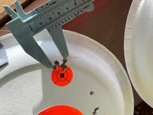

This was 2 days ago at 30 yards- the entire 7 shot magazine. Im going to try a few different pellets next & see if I can get the groups even tighter. This was with Crosman hollow-points. Now if I could just lighten the trigger...
