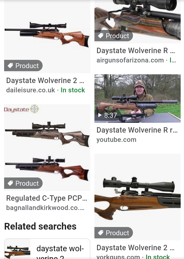

How does that UTG MOA Picatinny base set up even with adapter work for a Daystate Wolverine? I mean ditch the magazine ok no magazine use at all single shot tray only unless you machine that UTG drooper base well I guess so. It will have to be chopped in 2 places to clear the magazine and positioned perfect to not bend the scope tube when everything's put together if you catch my drift. Actually probably easier without the single shot tray and thumb in the pellets manually then close the bolt home. That should work.
Yea come to think of it yup it can be done just single shot tray no magazine use just roll the pellet into the single shot tray with your finger under that UTG Picatinny rail lifted up by those adapters. OK good idea!
Actually easier without the single shot tray thumb in the pellet without the tray for better finger loading clearance.
