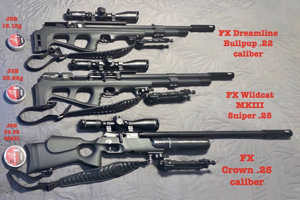

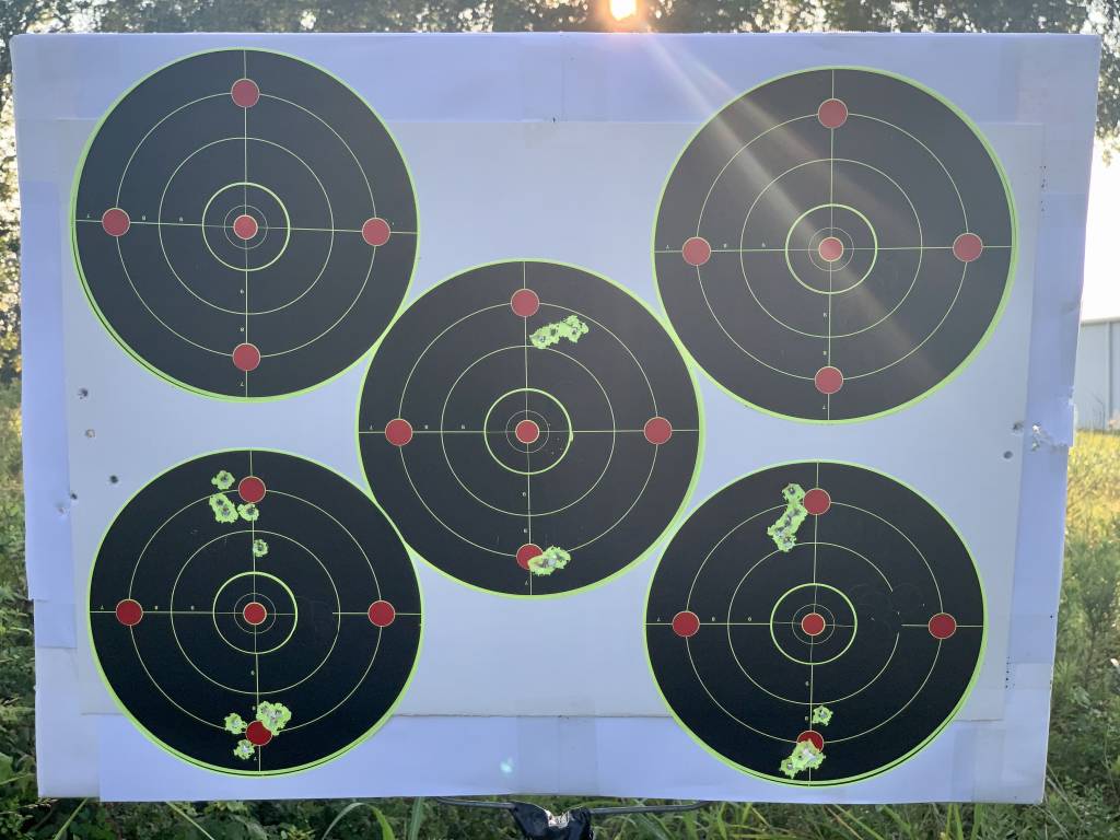

I’m gonna take three of my adjustable PCP’s and shoot them for groups at “ideal” and “power” velocities. How about 50 and 75 yards for the test ranges? Why not? And, I’ll use each PCP’s favorite heavy diabolo pellet..
Let’s Go!!!

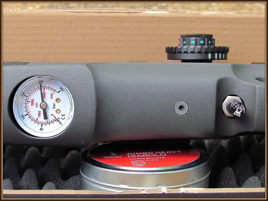

The PCP’s and the Heavy Diabolo pellets

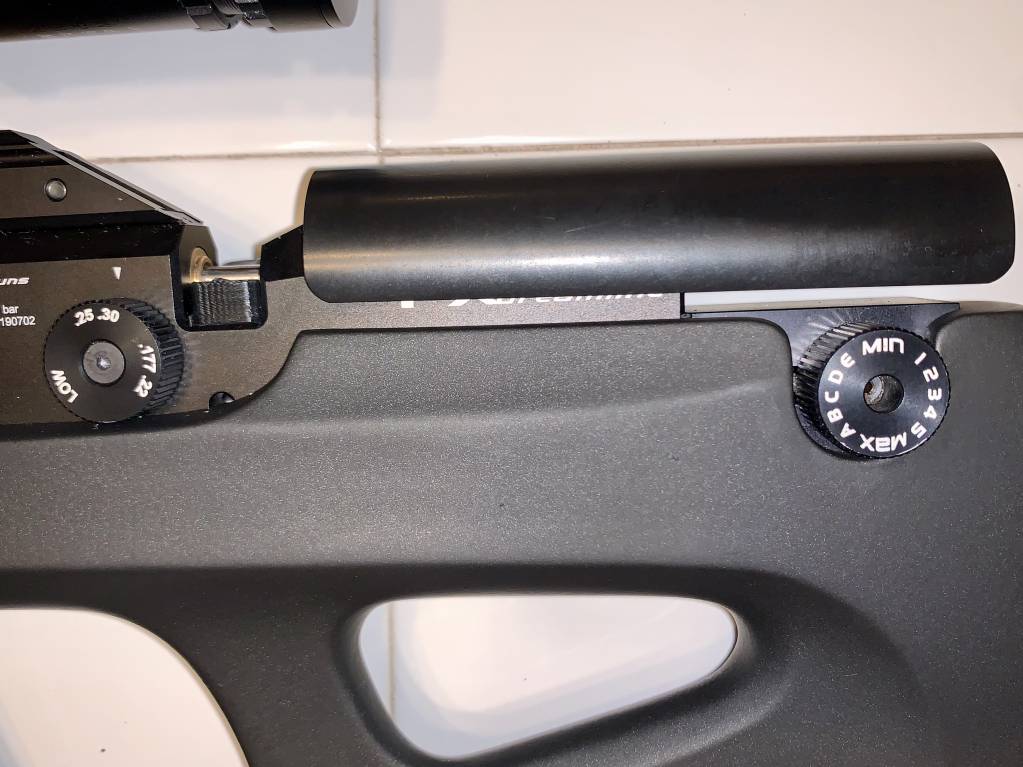

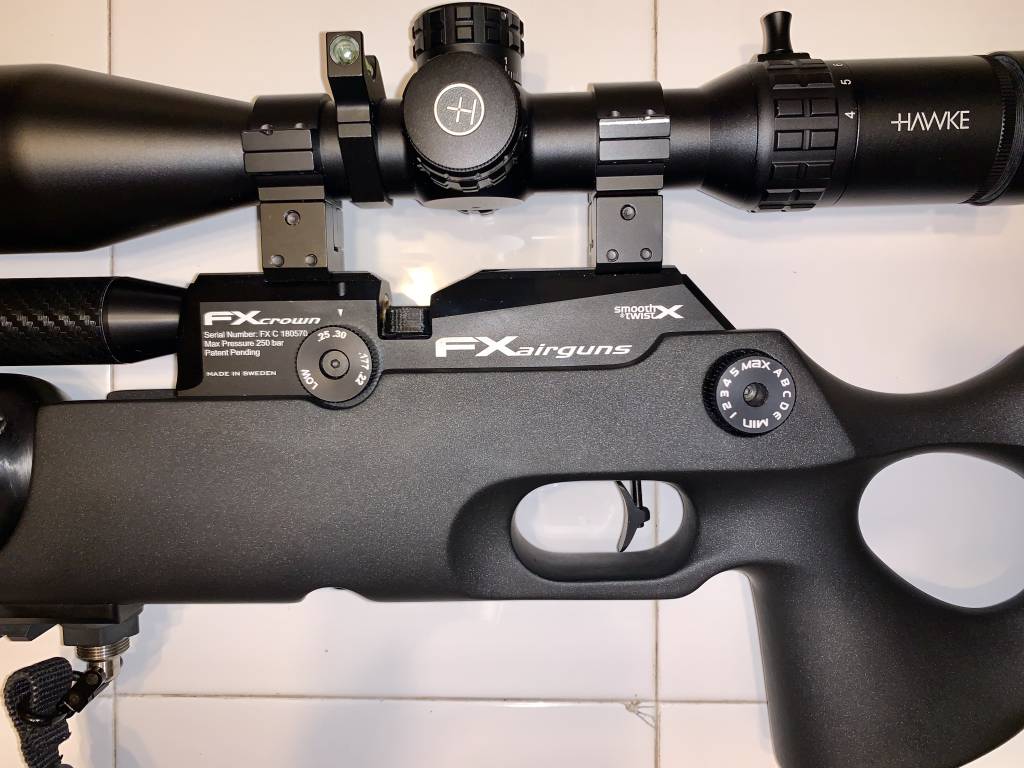

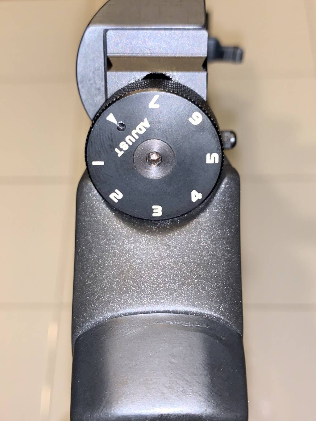

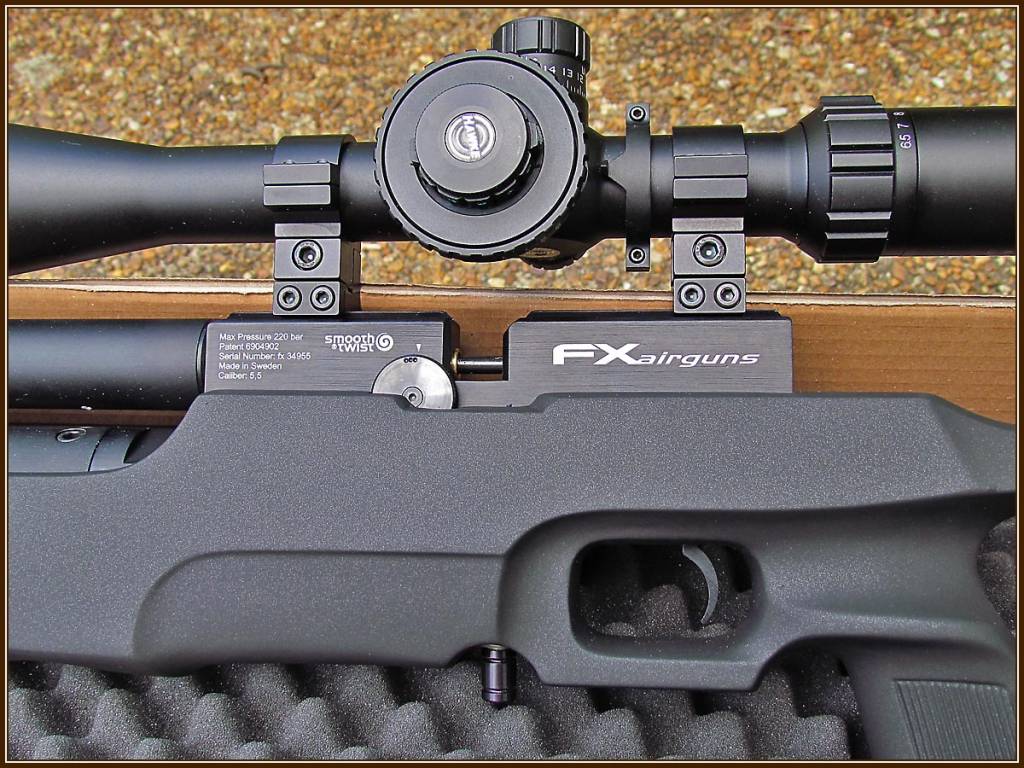

About the PCP’s

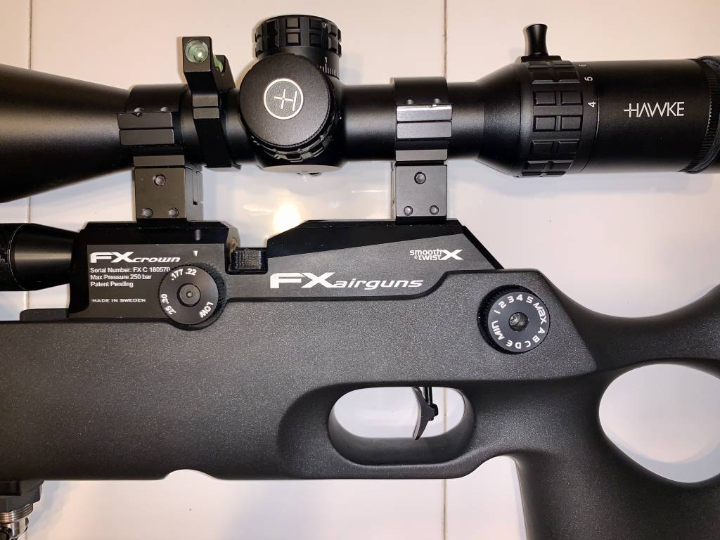

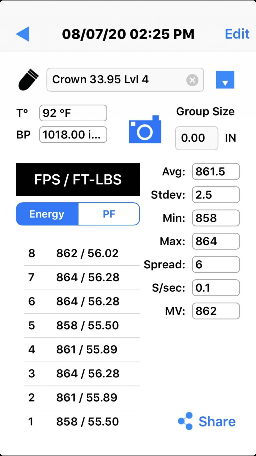

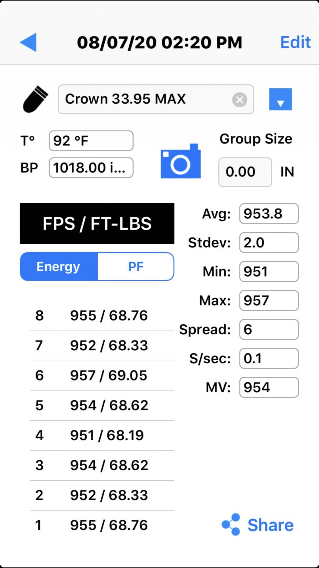

Ideal Speed Tune (.25/.30 & “MIN” HST)
Power Tune (.25/.30 & “4” HST)

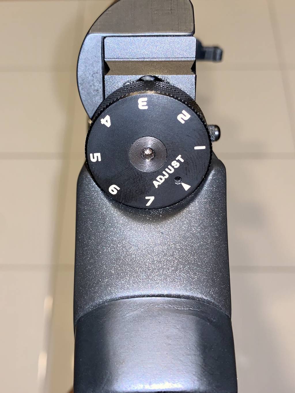

Ideal Speed Tune. (HST #3)
Power Tune (HST #7)
Ideal Speed Tune (.177/.22 & “4” HST)
Power tune (.25/.30 & “MAX” HST)

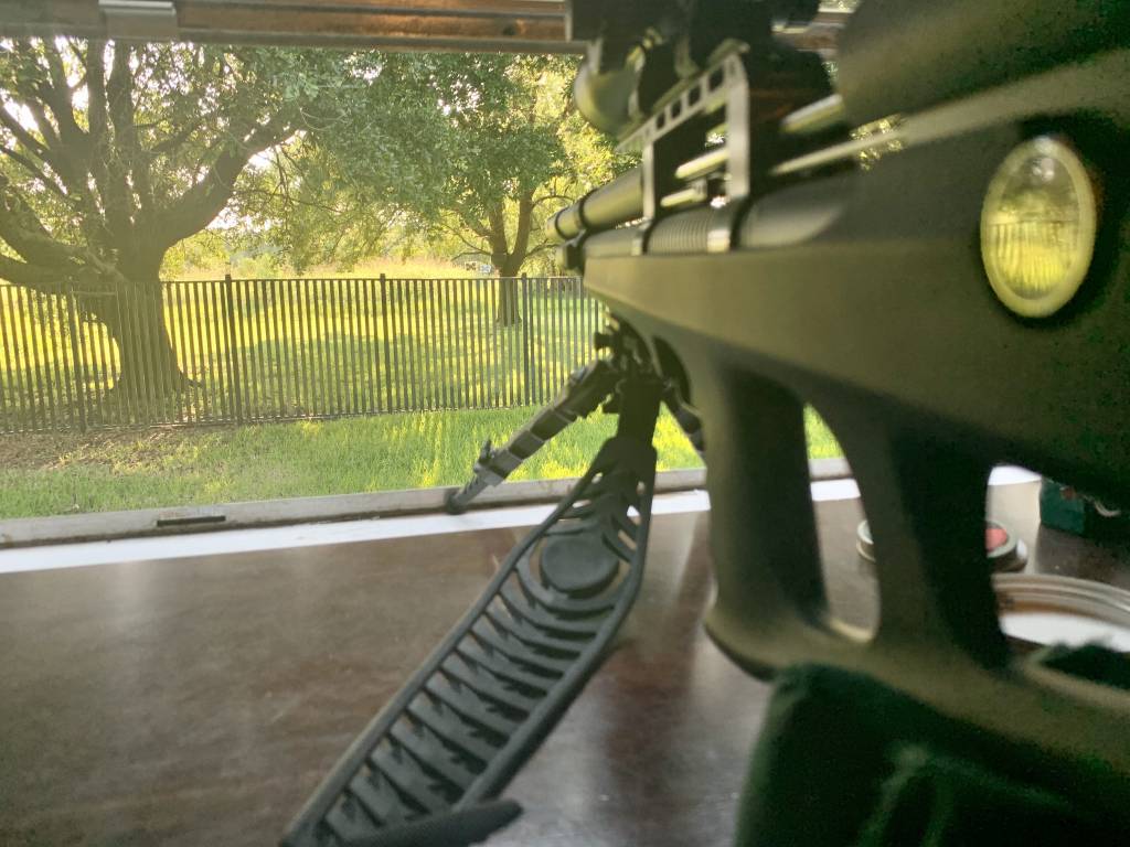

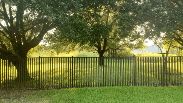

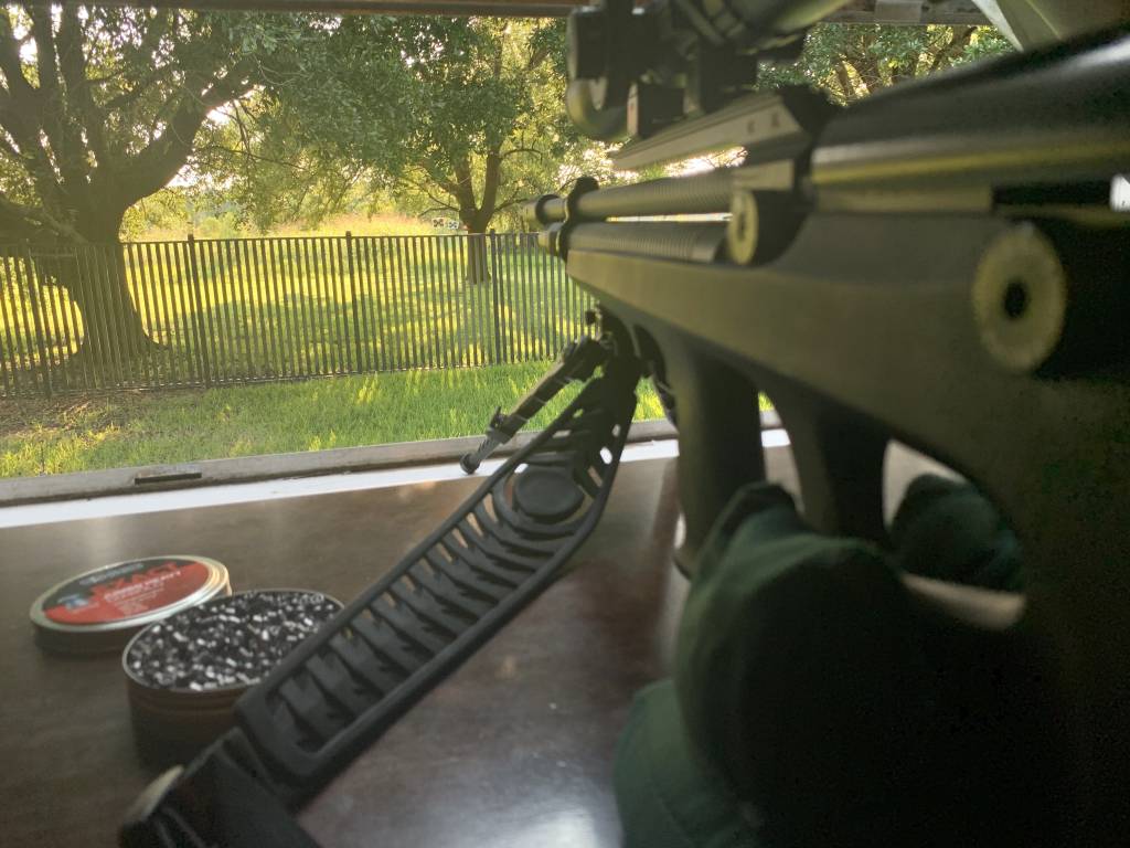

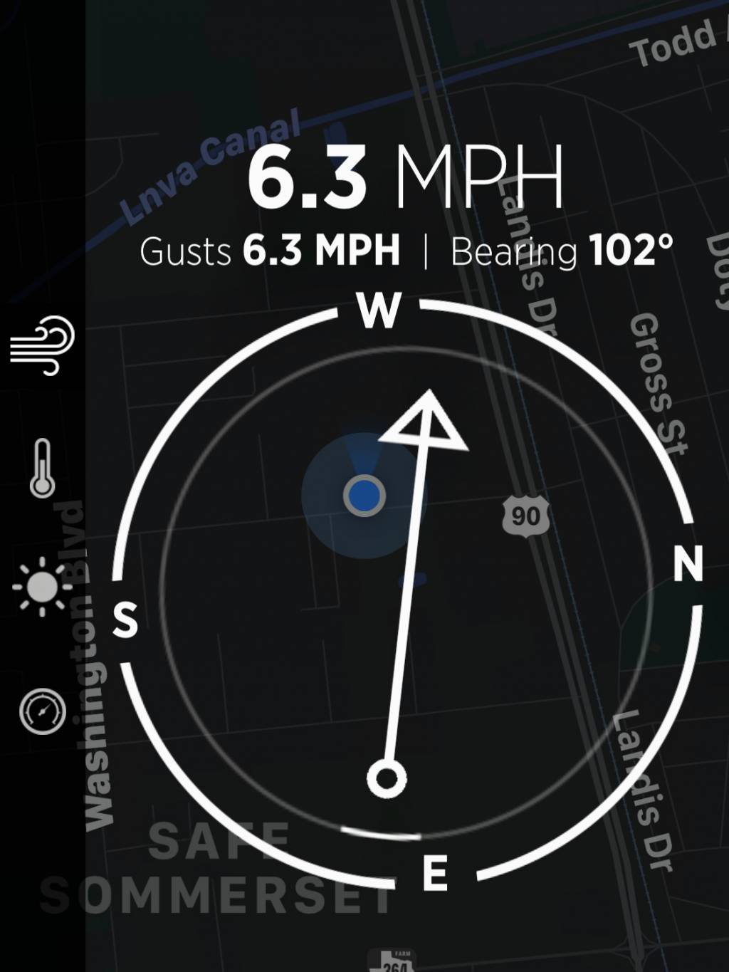

The range, the wind, and the shooting

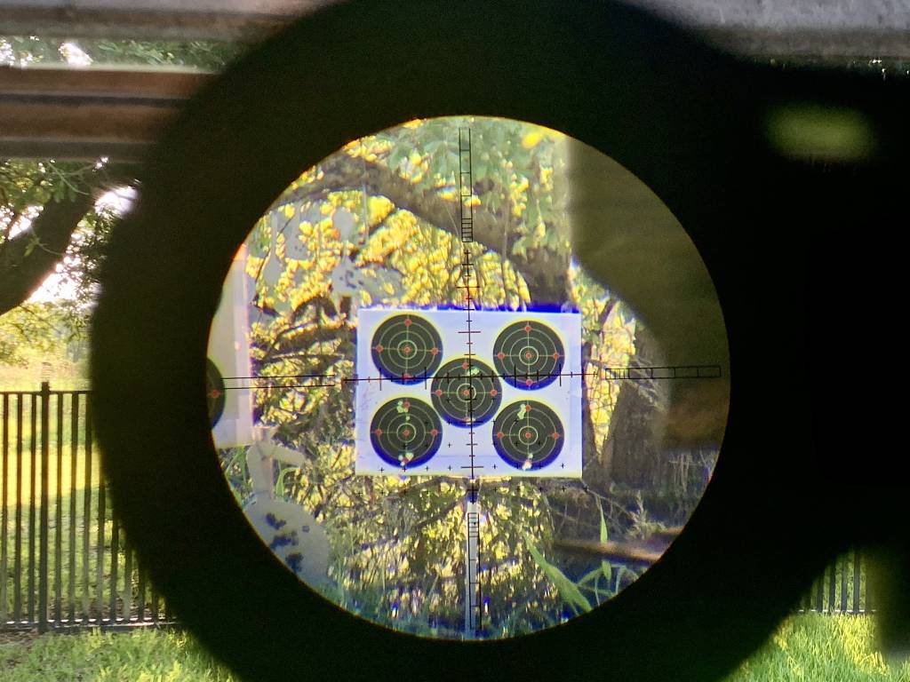

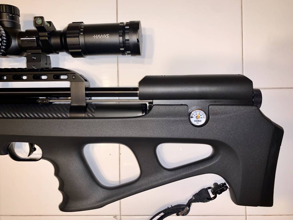

Scope-view (Dreamline-Bullpup .22 Hawke Sidewinder 16x zoom 75yards)

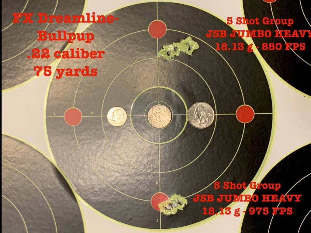

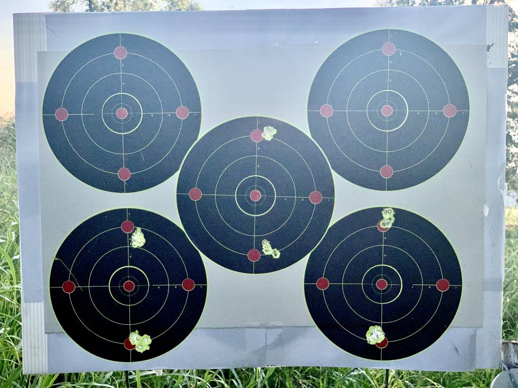

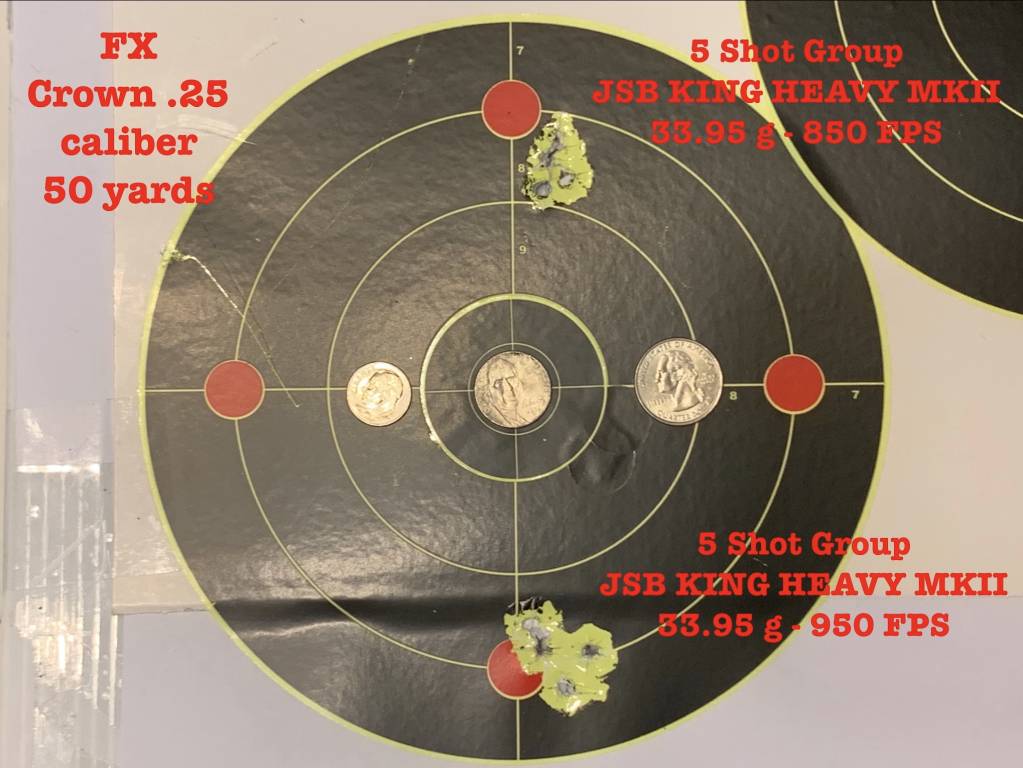

Targets, target close ups, and group breakdowns
50 yards (left to right: Crown, Dreamline, Wildcat)
75 yards (left to right: Crown, Dreamline, Wildcat)

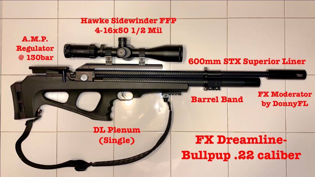

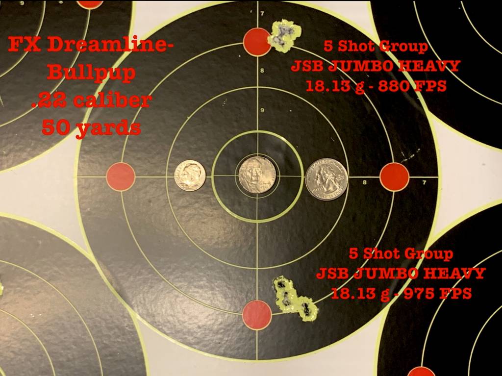

Dreamline Bullpup .22
☝🏽Accuracy on Ideal tune or Power tune
Wildcat MKIII .25
☝🏽Accuracy on Ideal tune or Power tune. Here on the lower group @ 960 fps I botched one shot high because I forgot my hold over. I mistakenly held 1.5 mils when the holdover was only 1 mil. Messed up what was going to be a fine group, sucks when that happens! (1.5 mils is the holdover for the 860 fps tune)

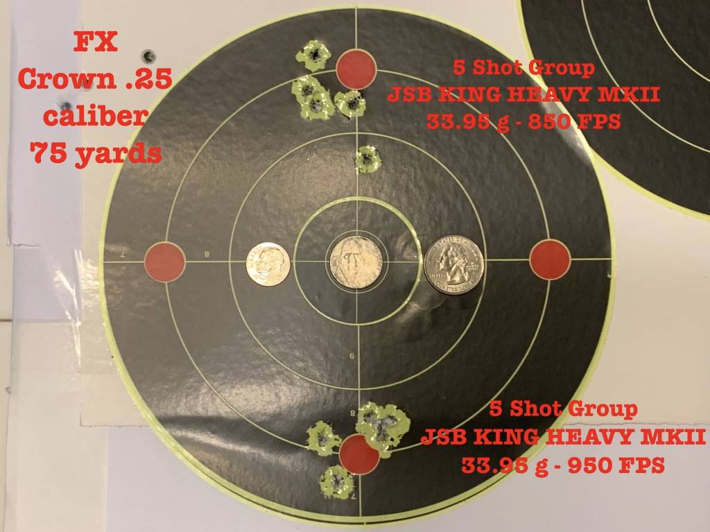

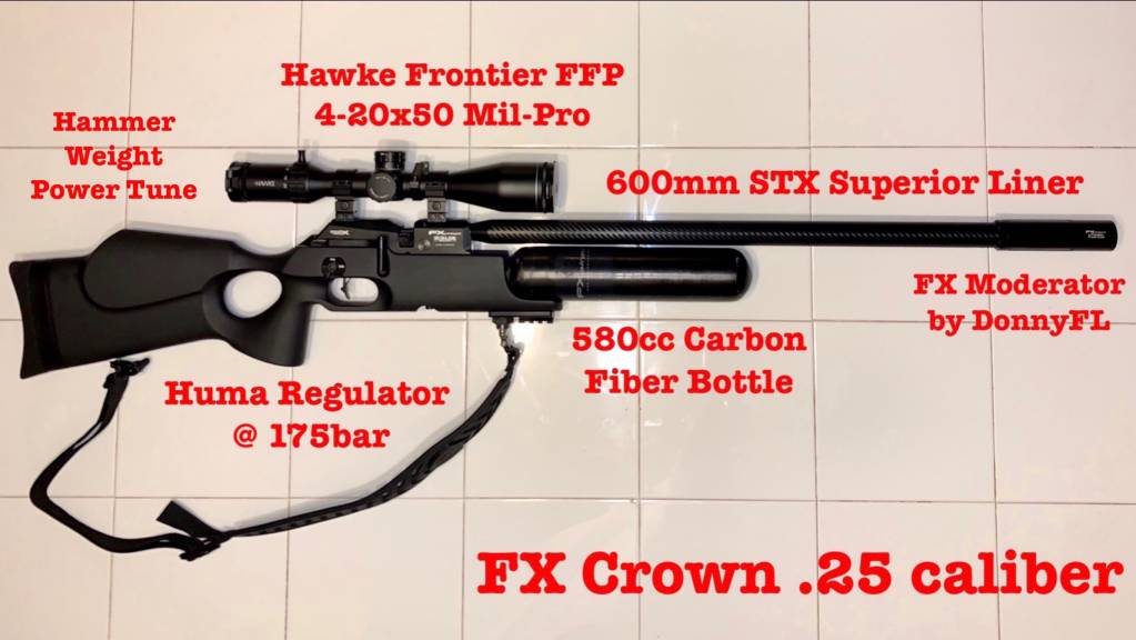

Crown .25
☝🏽Accuracy on Ideal or Power tune
☝🏽Accuracy on Ideal or Power tune. For the FX Crown, it was one of those not the greatest 75 yard group days. It’s done though and I have shot better groups with it, even @ 100 yards. Not the greatest or tightest groups, but they are honest. Even still, both groups are comparable in size!

Looks like these three power adjustable PCP’s do alright shooting at regular ideal velocities or powered up! Admittedly, I’ve done some upgrades, but only to beef up their speed and energy output for my uses. So, I suppose the external adjustability of these PCP’s are more than a gimmick. Because fair repeatable accuracy was achievable at respectable airgun distances. My question is; “How does your PCP perform on it’s variable power settings”?

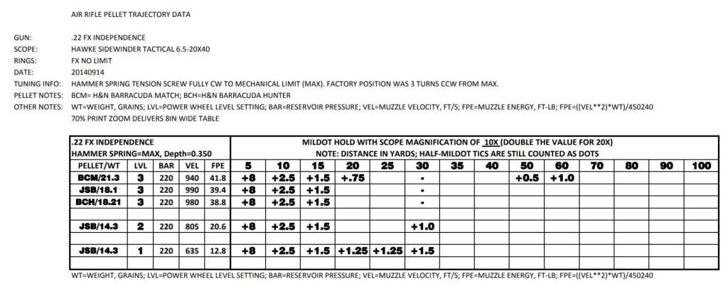

In my experience with the .22 FX Independence, which has 3 power settings in its dial wheel transfer port restrictor mechanism, I needed to evaluate and select a 'best pellet' independently for each power level (pun intended LOL). The flight and stabilization characteristics will change with large variations in velocity.
If I'm not mistaken, the FX Independence receiver mechanism is the same as the FX Royale 400, and my results may apply to those and similar designs as well.
I maxed out the hammer spring in mine and left it fixed. The next variable was to choose a consistent target plenum pressure to pump to for each shot; analogous to setting the regulator pressure in a regulated gun. With the pump onboard, you become the regulator by pumping after each shot for consistent plenum pressures. I have been using 220 BAR/3200 psi. Yes I know, that's high! After some testing, you quickly learn how many pumps to use after the shot for each of the 3 power levels to return the plenum pressure back to your desired target level.
But something very good happens in this gun with high plenum pressure and restricted transfer port at the lower power settings: the report gets very quiet while still maintaining good velocities. I think it's more efficient with air as well.
See the attached photo of my trajectory table/range card, with separated sections for each of the three power wheel settings. There are many variations possible, so you have to just FIX some variables/settings, and roll with the rest. I don't like to keep disturbing the hammer spring tension, for instance.
So finally, we get to my point: the most accurate pellet at low & medium is the JSB 14.3gr, while others are better on high.
I do most of my shooting on medium, where the JSB 14.3 @ 805 FPS is extremely effective on skverls, gives a zero crossing at 20 & 30 yd ( my most common ranges), the report is VERY discrete, and only 3 pumps are required to recharge for each shot.
Low power at 635 FPS, is super duper for all day plinking, with just 1 pump required to recharge for each shot. All I need for all day PCP fun are the gun, pellets, fun targets, and the air that I breathe.
High power, btw, requires 5 pumps per shot to recharge, and I found it to be no more effective on skverls at my short distances.
Since 2014 when I developed this tuning for the Independence, I have learned that diabolo pellets tend to have a sweet spot for accuracy around 875ish FPS. If I ever decide to revisit the tuning for this gun, I think I would start by dialing the hammer spring back to deliver 875 FPS on high and evaluate pellets all over again at each power level. This is a LOT of work, with all new range tables and hold points. This would also detune the medium and low settings, making then slower. Re-experimenting with variations of target plenum pressure opens a whole new series of tests and possibilities, again analogous to finding the optimum regulator pressure for each power level. Swirly-head, here I come!

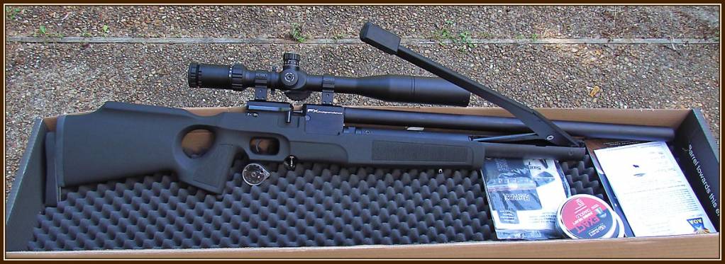

Feinwerk

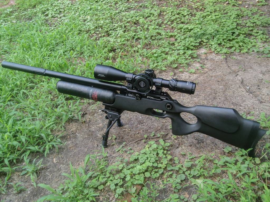

For those who've never seen one, here's a pic of my Independence when it was new in 2014, with the pump arm partially opened. Also a shot of the left side of the receiver, showing the transfer port power adjuster wheel ( "." ".." & "..." Markings). You can also see the markings stating max pressure rating of 220 BAR.
I have since printed and laminated my range table and taped it to the left side of the buttstock for quick reference.
