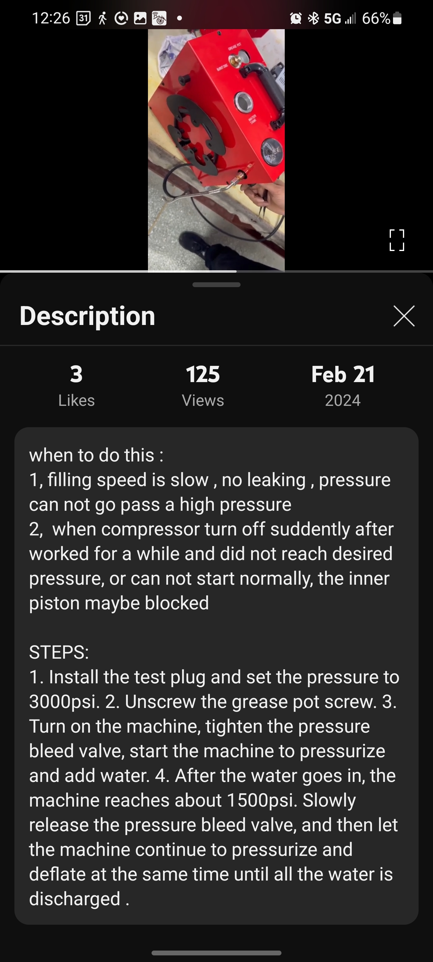

Grease pot supplies the cylinder, end of story. Open the video in youtube, and click on the description.

Look, if you don't want to trust the manufacturer's guidance to flush the cylinder with water, don't. The worst that will happen is you'll develop a leak that requires disassembly and cleaning (a rather simple task, really). But why would someone who makes such a fine compressor (thus far) and give instructions that would ruin it? That doesn't make any sense at all.

after watching the video at least 4 times, I couldn't help but notice the second time he put water in it didn't go down?
regardless of what manufacturer says, I'd never put water in any lubricant area.. in fact if I was rebuilding a engine, and had to pressure wash it out inside because it wouldn't fit in my solvent tank.. I always did a final spray of solvent after blowing it off with the compressor and then I still used assembly lube on the piston, cylinder, crank bearings and cam.. I likely missed listing something but you get the idea hopefully.

ok nothing getting into the crankcase is not necessarily true.. it's why the high speed oil bath compressor has to get it's oil changed frequently.. some amount of moisture gets past the rings.. this is the best advantage of the slow speed and oil less compressor.. likely it vapor out the vent.. instead of contaminating the oil in the crank case..
does the entire cylinder have a water jacket around it? couldn't tell from the picture.. man that would be the first thing I'd have to disassemble and likely need a seal kit.. there's got to be a water jacket and multiple cylinders inside it.. and depending on how tight the fit it would likely need a ring compressor if it has o rings for piston rings to keep from nicking one..
at the end of the day, I don't think I could bring myself to put water in the grease.. it's just something that doesn't mix.. and ultimately In normal life the water would keep the grease from lubricant properly, so it will be like running without lube for a bit.. and well I have seen a few too many diesel engines that lost a head gasket or EGR cooler and it put coolant into the engine and ejected the rod out the side of the block.. I just couldn't even force myself to try that and not expect disaster.
mark
Forgive me, I have already forgotten, but which model do you have? (Side note - I only became interested in the GX pumps after finding out a neighbor has the CS3; he invited me over for a top-up, and MAN was I impressed with the quietness, speed, and apparent quality of the CS3!! So that night I ordered a CS4.)
Well, I cannot say I would have come up with the idea of putting water into the grease pot to "clean things out", but knowing what little I know from having taken mine apart, I realize it won't do ANY damage to the unit.
Now, if I suspected debris inside the piston area, I would take the cylinder apart, wipe it clean, re-grease it by hand (light coat over all surfaces), and re-assemble it. I suspect GXO has put this video out for people who are reluctant (or unable) to disassemble their compressors.
Glad my pictures help in any way. By no means to I profess to know more than you nor ANYONE who has owned these CS compressors for awhile (I've only had mine for a minute or two), but as I said above, I like to KNOW how a machine works and therefore take them apart to get the functions in my mind's eye before I even turn it on. Been doing that since I was a kid (My dad once bought me a rather expensive bait-casting reel, and man was he MAD when he walked into my bedroom and saw parts laying on the floor from me taking it all apart!! But from that day forward, I could have taken it apart, trouble-shot it, and re-assembled it with no problems).
Sometimes I come across the wrong way; already, I have made a mortal enemy here on AGN by asking a question about HPA hoses in an Alkin thread (Some of those owners seem to be wound a bit tightly IMO), but I am always seeking knowledge, and the two best ways I know how to obtain it is:
1) Ask those who have gone before, and
2) Tear it apart and figger it out myself!
Thanks for the constructive dialogue. This forum is awesome because it allows each of us to share our knowledge and experiences. Alone, we are individuals with basic knowledge. Together, we are a group with the COMBINED knowledge and experience.
Here's to many, MANY years of use of our CS pumps, and sharing what we all have learned. Though I have only been an AGN member for a short while, I am very pleased with the wealth of knowledge and skills presented here on these forums.

so picture 1.. the blue thing with white ends, is that the intake filter? do you know what they put inside, and is it serviceable or disposable?
have you removed the head and the grease pot or grease pot and air intake? interesting thing,my grease pot doesn't have a diaphragm..and I'm not sure how that would work.. seems like it would seal the grease to one side..the grease pot is pretty much identical to the grease caps on old machinery. reason I am asking is I have been fooled working on something that it appears to go to one place but they have intricate passages that take it elsewhere.. just wondering, possibly if you take it down at a later time you could pm me some more pictures.. yes I love pictures..
picture 2 looks suspicious, because the way the grease is around the rod and crank it really looks like my excavator or tractor when you grease a pin and it squeezes out.. makes me think it is more than just grease from assembly.. is there a hidden plug? ball joints on a F350 have a plug instead of a grease zerk.. I always replace it with a zerk to lubricate, especially loggers work truck because they get so much mud and grime and they are half a day work changing them, so with the grease zerk I can pump extra grease and flush it out and then just wipe up the excess.. my only other thought is that it has a split race, like a crank end rod bearing and they just packed it full before assembly? but since it's got a very good looking piston end rod bearing, looks like very good quality it doesn't seem like it would be any different on the crank bearings..
picture 2 and 4 and 5
you didn't post pictures of the cylinder dissembled.. so I am actually wondering what it looks like inside.. id think at minimum it's got to be a 3 stage or more.. so inside the cylinder housing there has to be more cylinders inside each other.. would be nice to see..
comments.. it's very nice to see the quality bearings, and not bushings.. makes me think that it will have a long life.. I'm not convinced by the picture that the grease actually goes into the intake.. id assume that but like I said, I have been personally fooled looking at a part and then finding out after disassemble that it had passages other places..
yes the water will bead and come out, especially if the cylinder walls have grease rub in.. I'm curious now if you have had the cylinder disassemble? are they using rubber o ring for piston rings? id assume that would be the weak spot if so, but I would expect rings like a hydraulic cylinder instead, longer life for the seals..id also assume that each stage has more than one ring on the piston?
I'm wondering what the inside of the cylinder is like.. I have a couple airbag compressor and they are not standard oil bath.. they are ceramic lined and coated with Teflon.. short duty cycle and they are high speed and get hot.. not so good for long life but they have been around a long time and still going..
makes me wonder how well the crankcase is vented, I wouldn't try it with the high pressure, unless I could verify it was safe but some high temperature high quality bearing grease in those roller bearings would make them last forever.. but if any vapor could get from them it could possibly go into the cylinder and diesel and then the compressor would be done at best.. could be pieces everywhere...
mark
Pic 1 is a desiccant air drier I made, but it's far too small for my local humidity. I plan to make one that is much larger in the future, if I find that my small filter and molecular sieve on the output side aren't drying the air sufficiently. There's a pic of before and after pumping in my CS4 thread: https://www.airgunnation.com/threads/2024-cs4-setup.1307075/post-1683019
Yes, I removed it all, and it appears to be a straight hole into the cavity between the piston head and cylinder wall, right next to the air intake.
The grease is just "slathered" on the crank bearings. There is no way that I say to get the grease inside the needle bearings other than by hand. I'll look harder next time, now that you made me think about it. But when I had it apart, I took some of the excess grease from the sides of the bearings and forced it inside the bearing, where the pin goes thru.
Yeah, I didn't want to fool with disassembly of the piston itself. I figure that will happen when this thing wears down and needs new seals. According to GXO, it's a 4-stage compressor.
The grease and air intake most likely have separate ports, but they enter the cylinder wall right next to each other from what I could tell.
Sorry, I failed to take a pic of the piston removed from the cylinder wall itself. My bad. The seals appeared to be of the "wiper" variety as opposed to round o-rings. IOW, it fits into a groove, and has a flap of rubber that sticks out a bit farther and rubs along the cylinder wall, sort of in a cupping motion, if that makes sense. (Had I taken that dog gone pic, it would be much more clear, grrr)
If you look at the last pic, you'll see the bottom of the piston assembly is solid, and seals against the cylinder wall around. Not saying a drop of water COULDN'T squeeze past that wiper seal, but I think it's unlikely. The crankcase vent is simply 7 small holes on the back of the machine; you can see it easily if you look at your machine. Nothing fancy, just allows air in and out as the piston moves.
There is no oil in this crankcase, just crank, grease, and air.
No, water does not circulate around the cylinder wall; look at how thin it is. Didn't measure it, but I'd guess 2-3mm thick. The water only seems to cool the head block. Only one cylinder and piston.
Don't try and equate this compressor to a diesel or gas engine. Totally different. I had no idea how different until I took it apart. I was trying to see how the 4 stages worked in concert. But short of taking the piston apart, I can only imagine that are two stages inside, and air is compressed in both directions, hence the 4 stages. Just a WAG at this point, however.
Hopefully I addressed all your questions. Feel free to ask about anything I may have missed, and I'll do my best to answer you!
