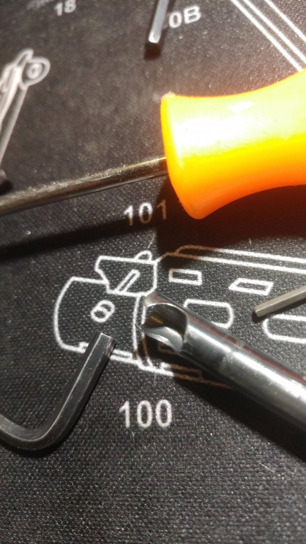

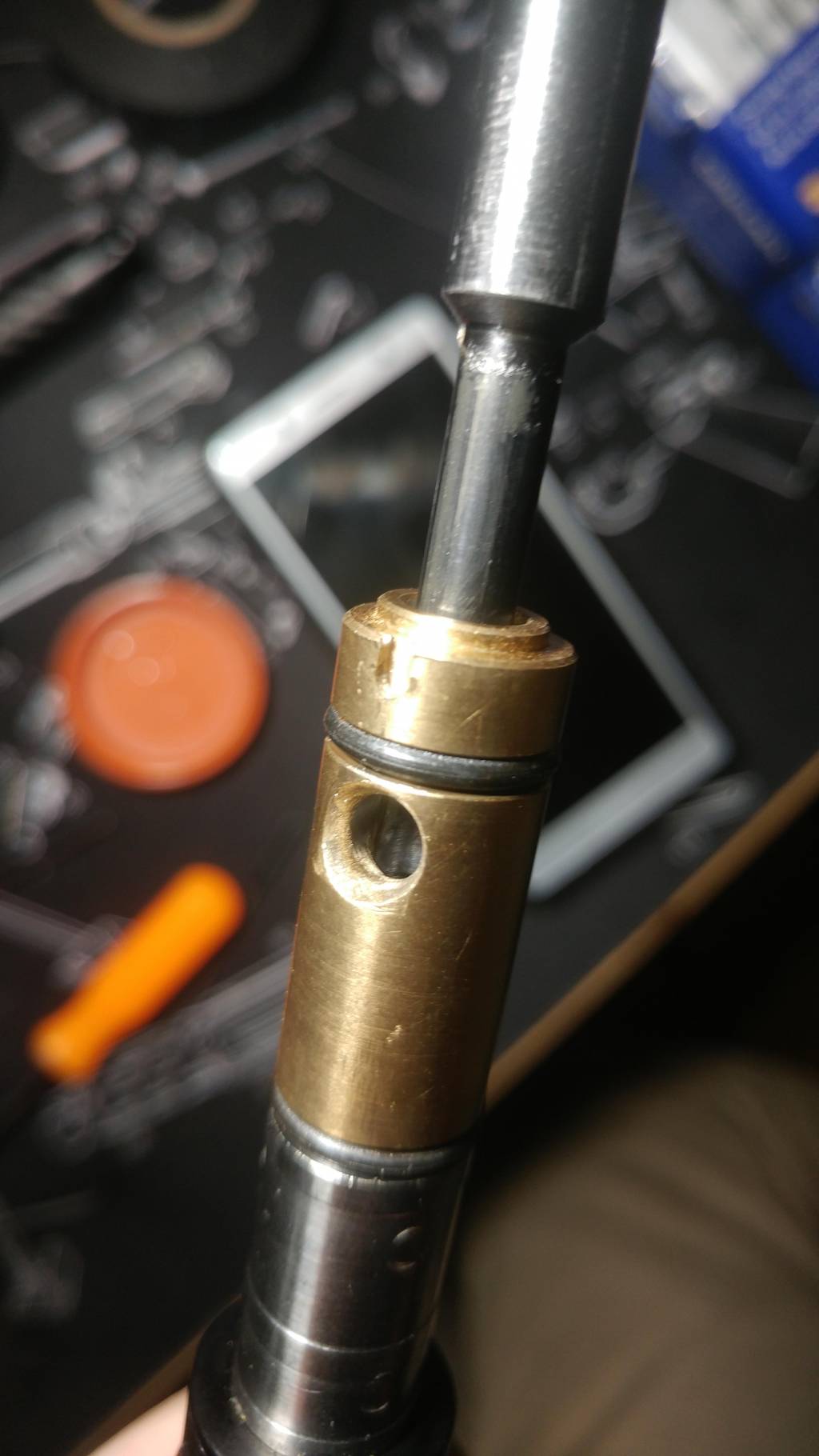

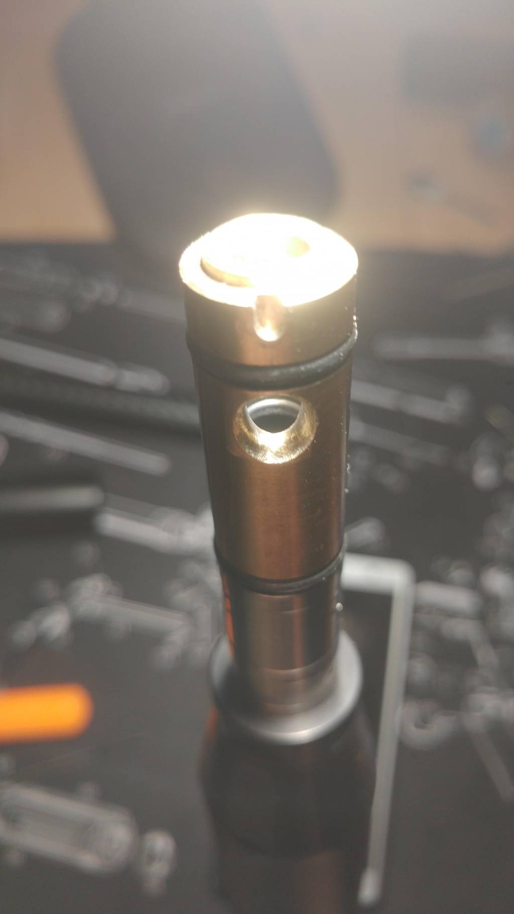

It peaked at 65. My reg gauge says 155 bar, but factory gauges have been known to be off. I use an additional 7gm hammer weight, and massaged the barrel port/pellet probe to streamline airflow. I run the gun on 30 cal transfer port, and bellmouthed the inlet of the barrel port to match the .30 opening
That's why mine was outputting more fpe. More weight and more pressure will get it around 75fpe
Like I said, I’m impressed. Not sure I’ll go to quite the extent you have, but I think I’m going to buy either the Huma or the Ernest Rowe modified barrel port and pellet probe.
