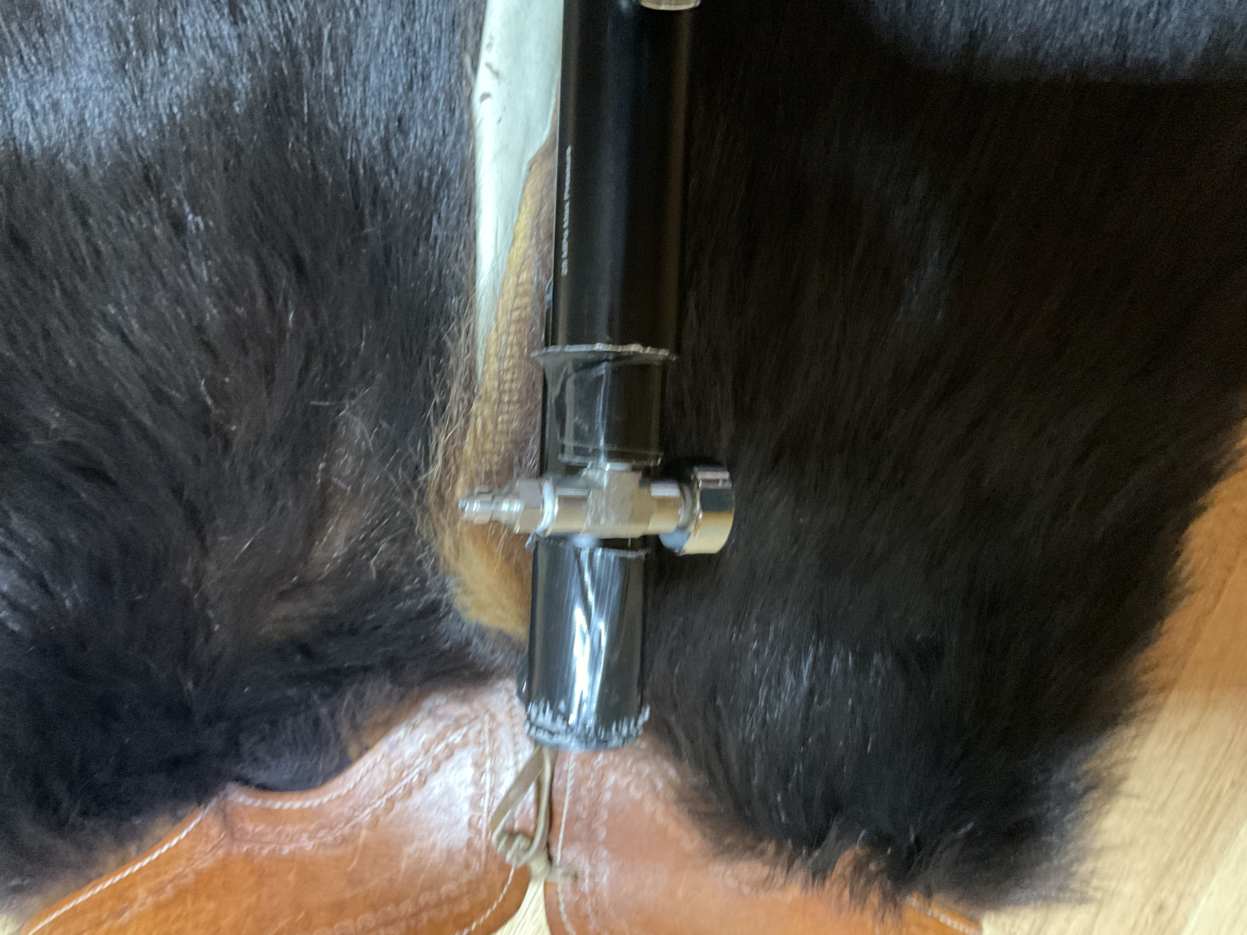

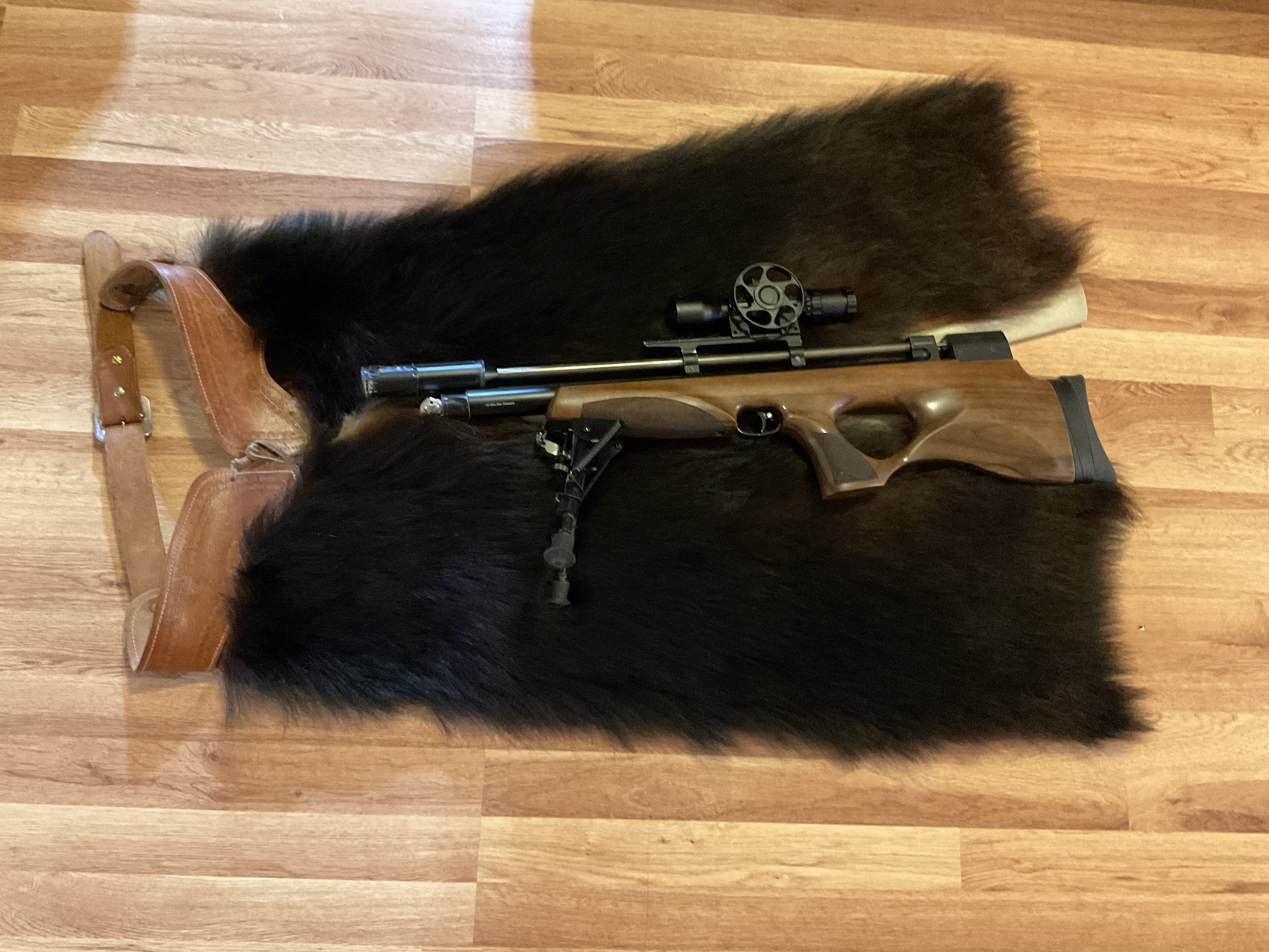

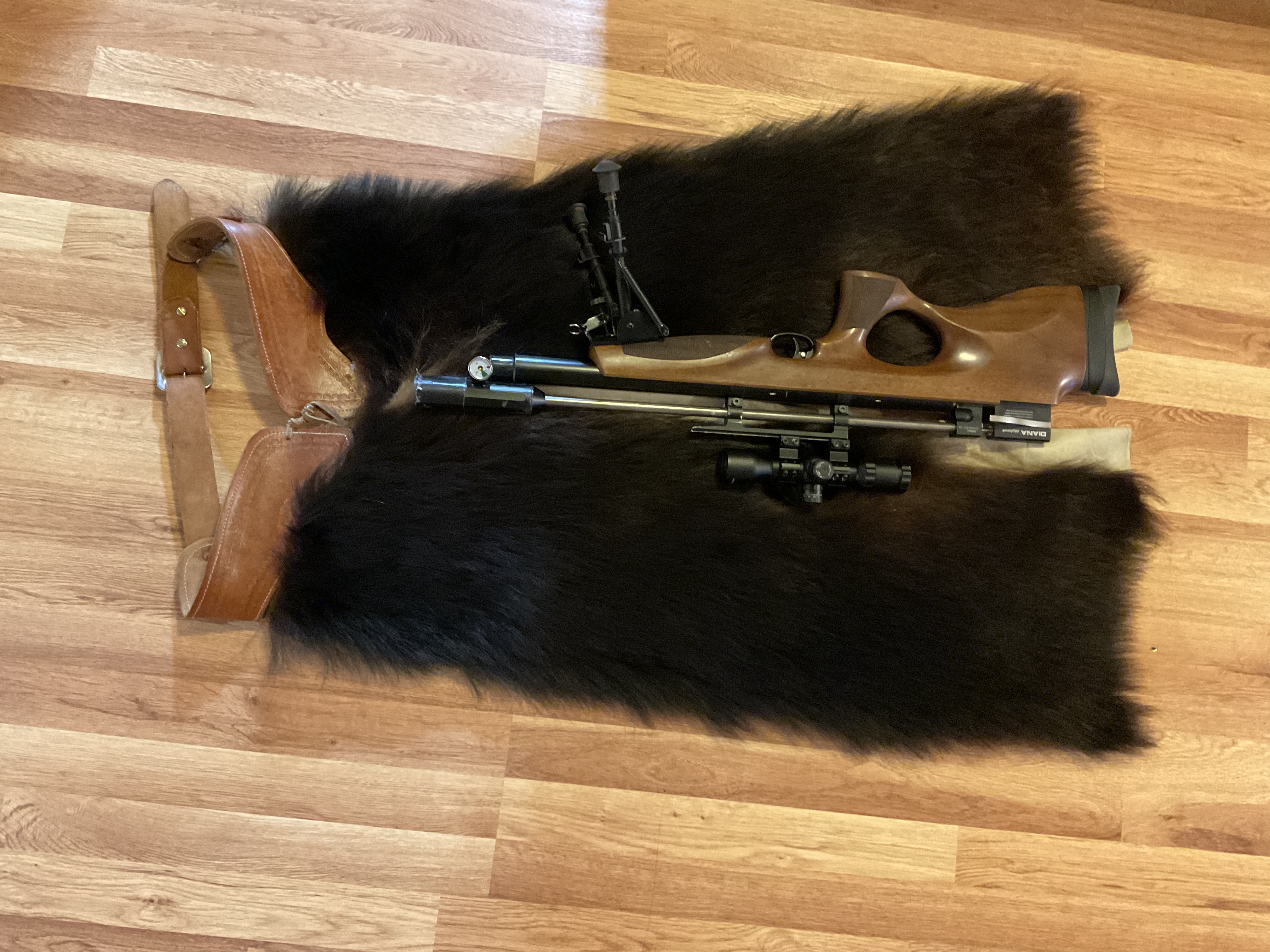

You can put a t fitting to re[place the fill nipple, then replace the nipple into the and a gauge on the other side.
Here is one on my Skyhawks, it cures the p-15 blown fill rings and makes it so your not looking down the barrel when reading the p-15 gauge, it should work well on your p-rod.

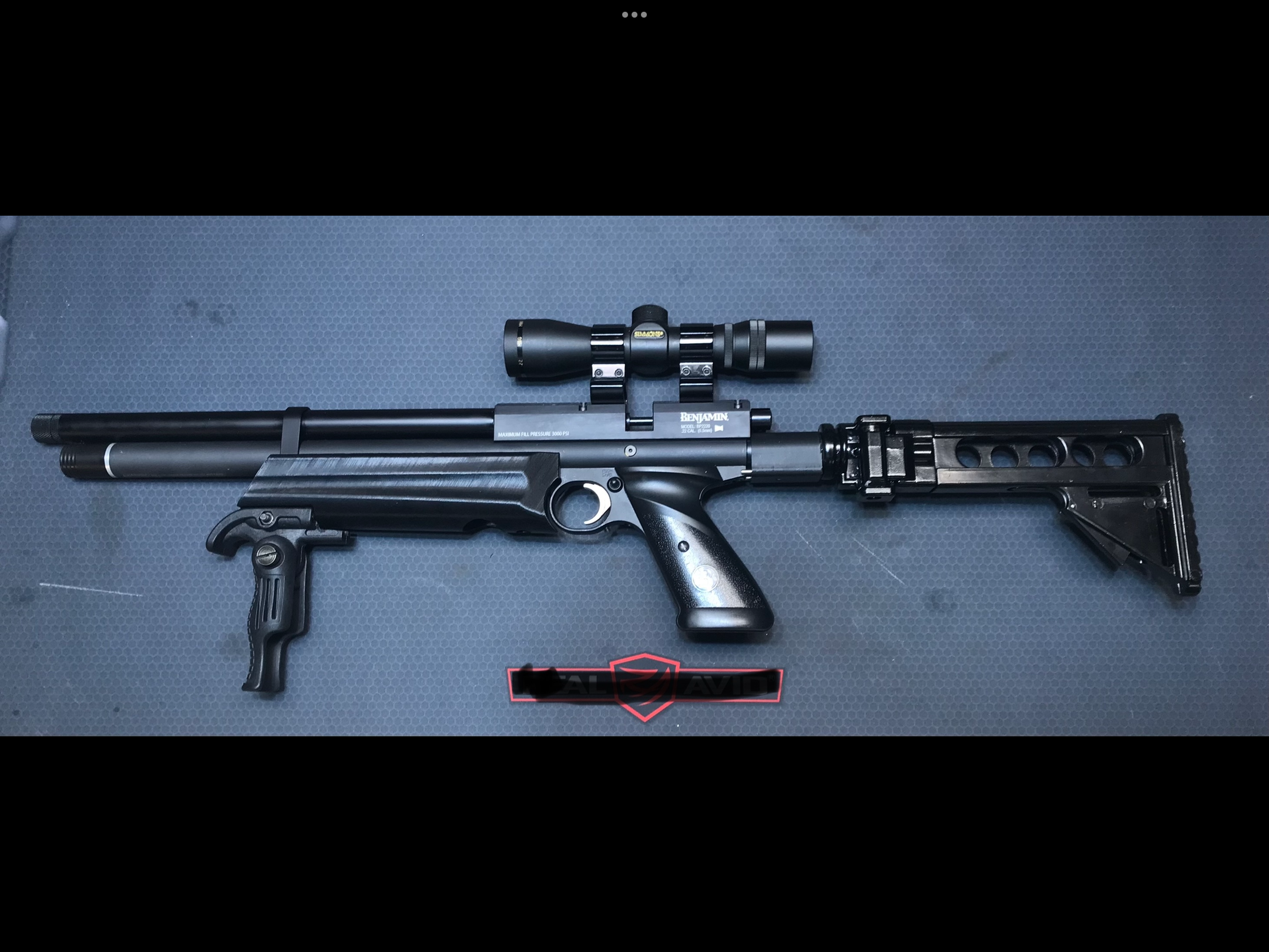

All I did to mine which took about 10 minutes was change the transfer port from the stock .081 to one that is .110. Shoots right at 22fpe with 18.13 pellets.View attachment 284770
Mike,
I'm not really looking for a huge gain in power. I like shooting the 14.3, 15.89 grain pellets at 620 ish. Just wish I could bump it up in power to 650 - 675, and add some more consistency. Get a flatter shot curve. Nice PROD set up :)
