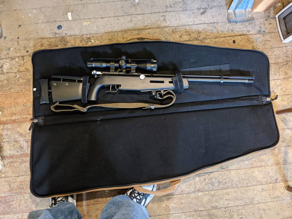

Accuracy?? I made a field target stock for my Challenger, and it is the backup to my Steyr LG 110 FT…. But! it is every bit as accurate as the Steyr only at 12 FPE compared to the Steyrs nearly 20 FPE.. In fact at my practice session this morning I out shot my Styer with the Challenger. Guess I was more aware of the wind with the 12 FPE gun…!!??
Here are a pics of the gun as it is now with the new FT style stock I made for it from a curly maple blank…took the plastic knobs off and replaced them withh aluminum Paul
