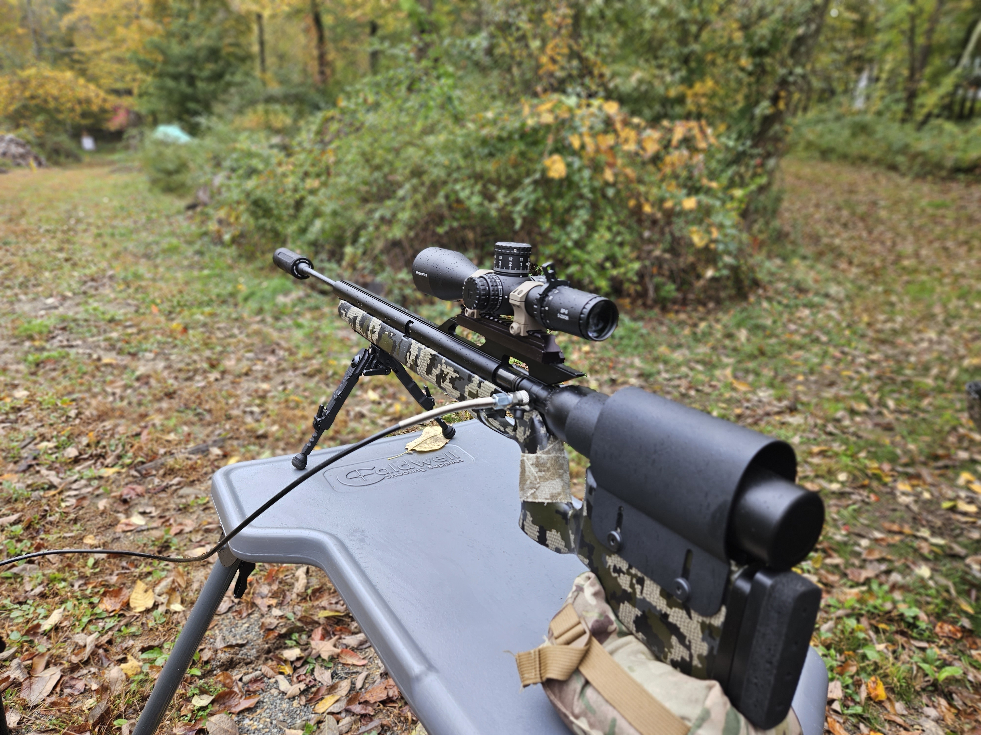

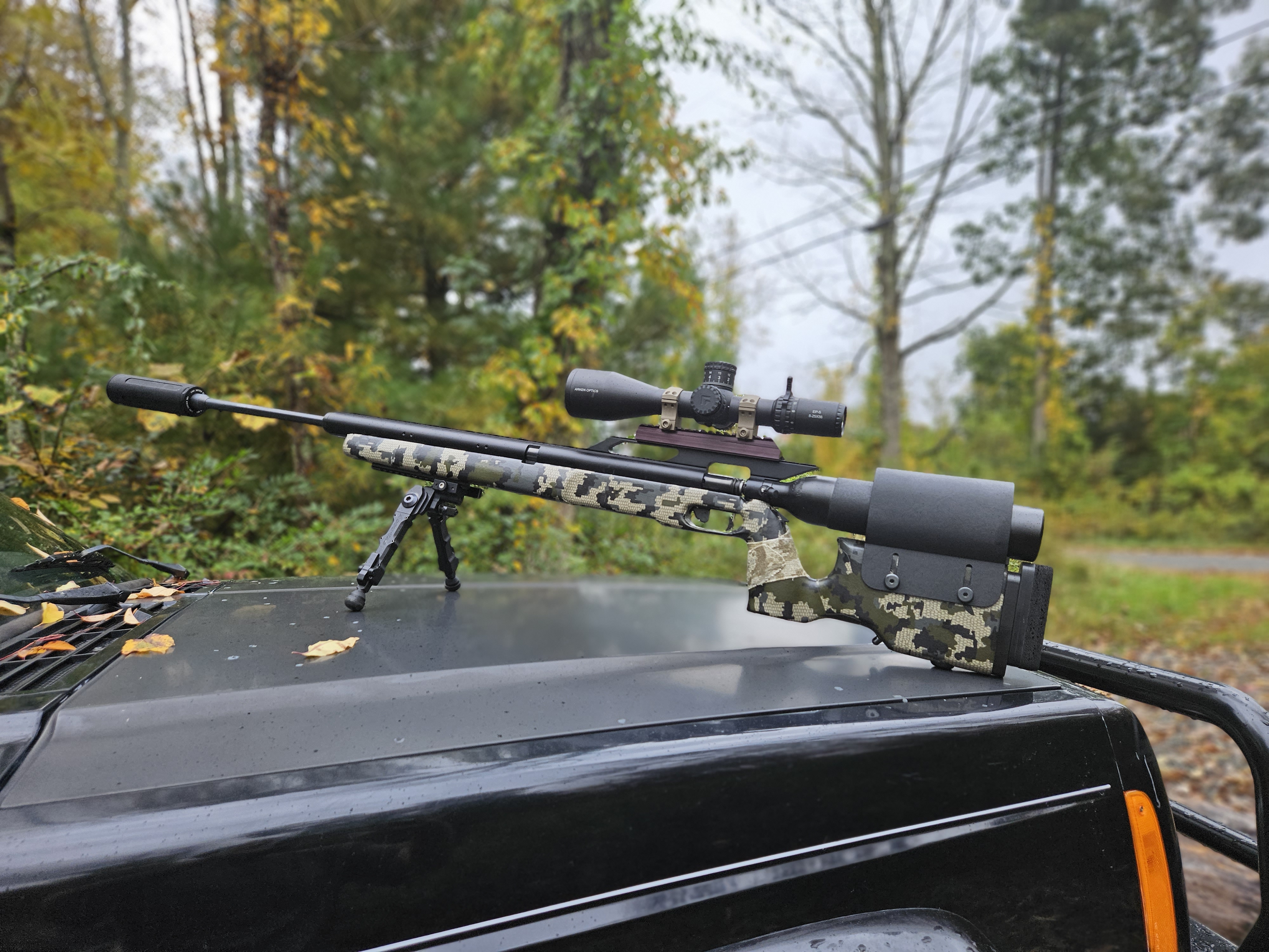

Added a Texan to my line up.... .257 named Freak.
I scored this .257 off the classifieds on Wednesday and had Tom at High Pressure Pneumatics ship everything else NDA and it all arrived in less than 24 hours!

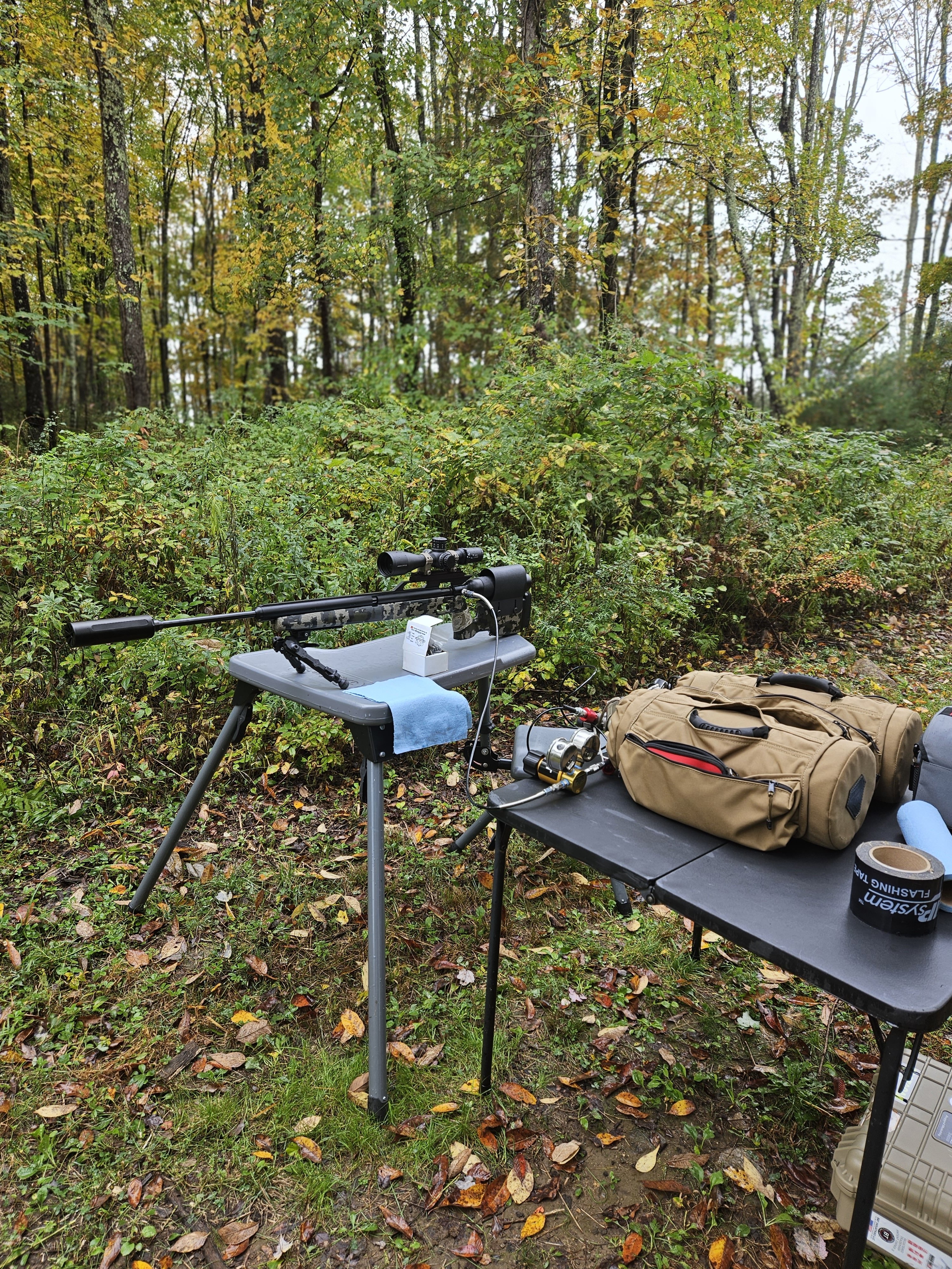

I had been itching to shoot it and I wasn't waiting for the rain today so I took Freak out to zero her.

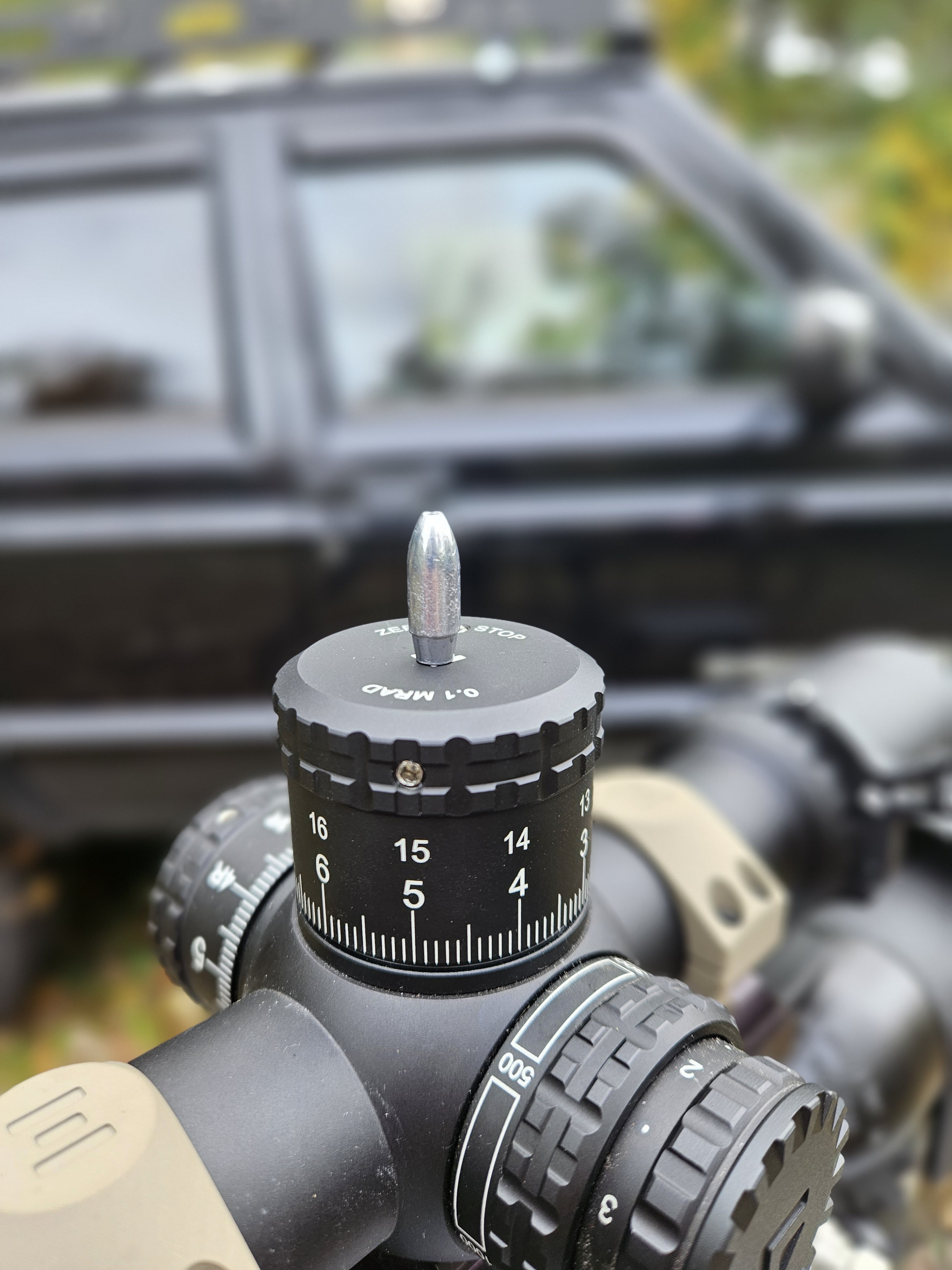

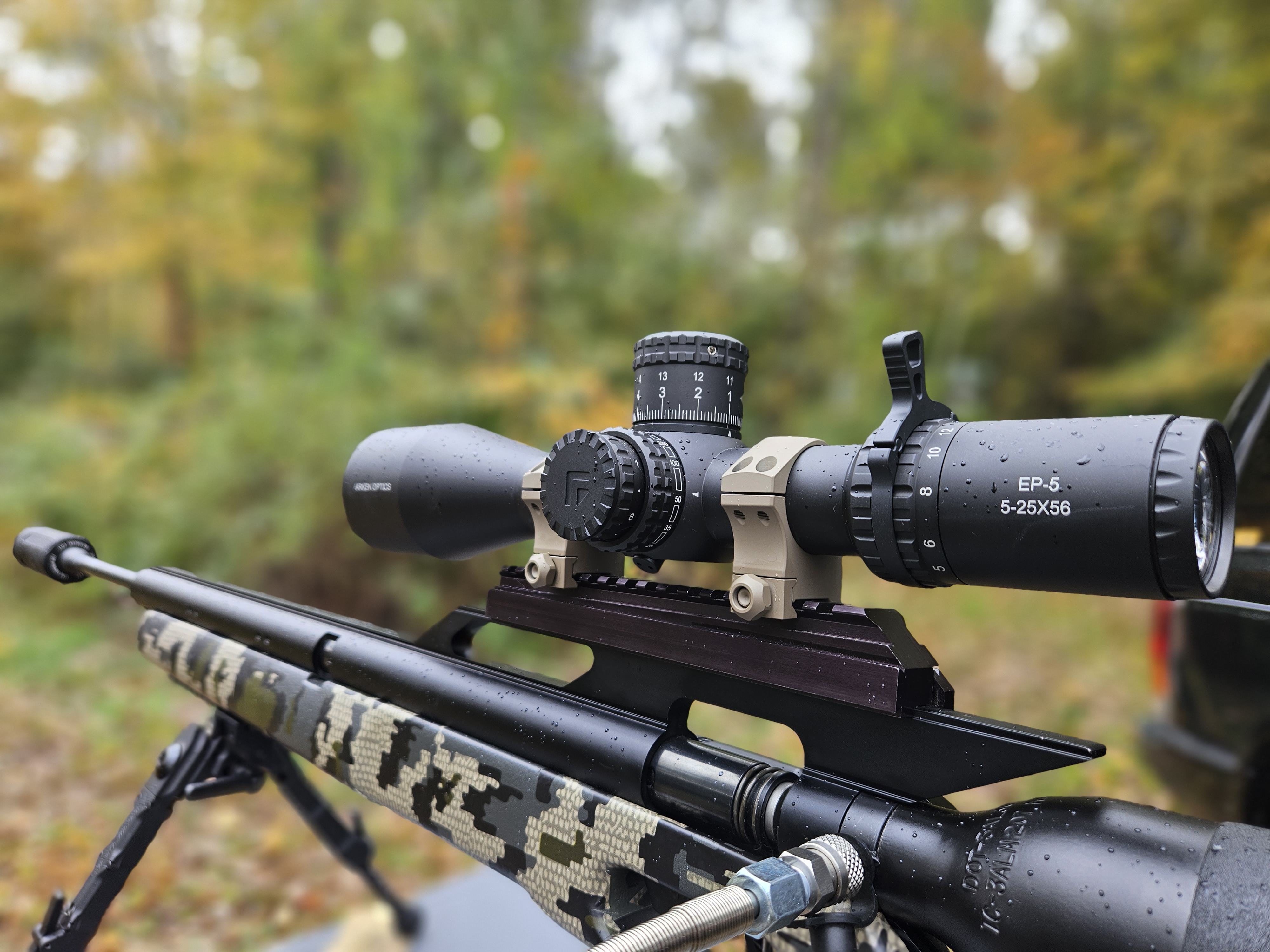

Well, I forgot my Allen wrenches so I literally had zero elevation adjustment and was using the top of the ep5 reticle at 25 and 100 yards 🤯🤪😅

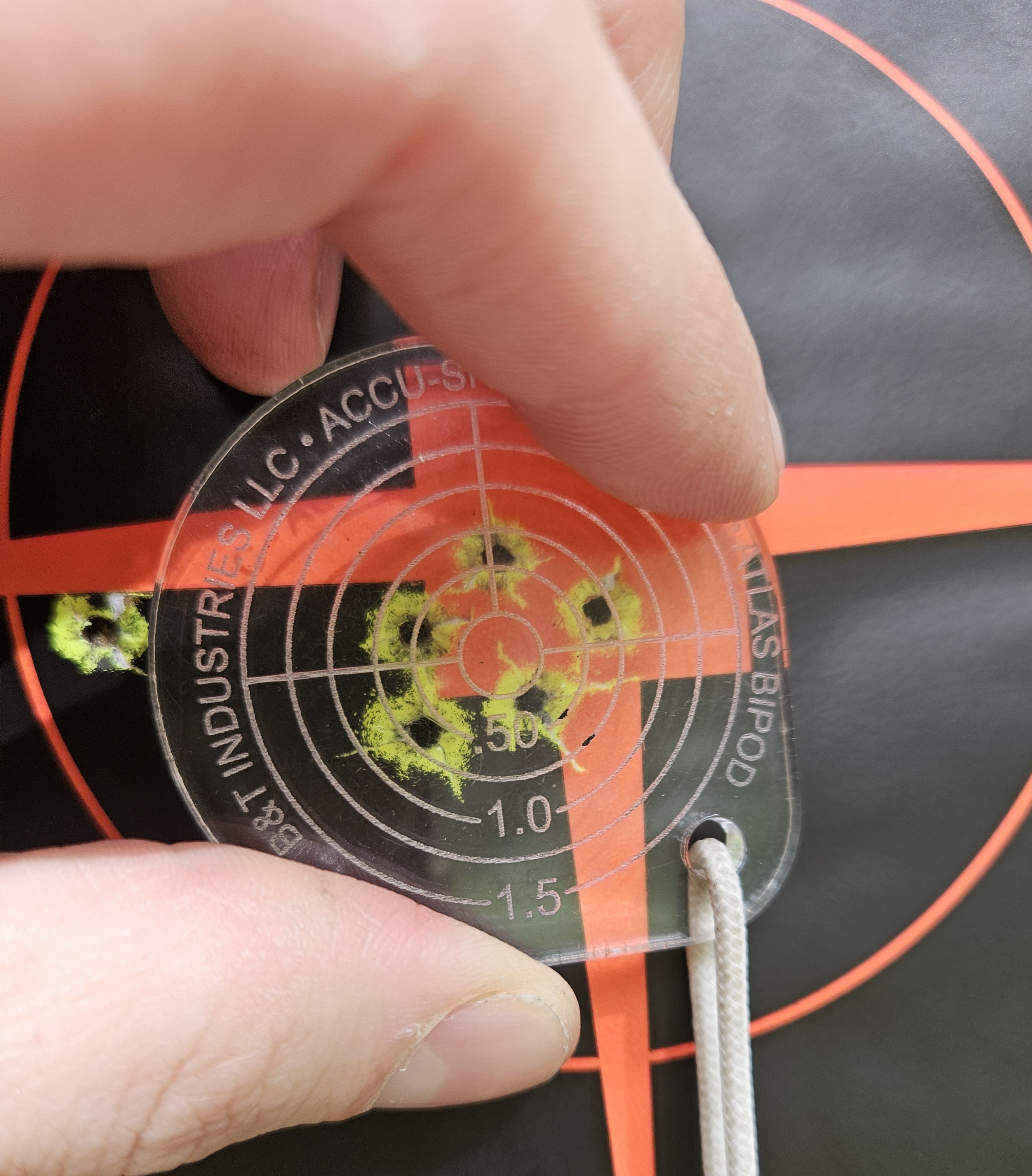

That didn't stop me from testing and tuning though, the @alkincompressors kept everything tight with an es of 7 fps while slinging these beautiful 85 grain #avsslugs boat tails at 975 fps for 180 fpe.
The first group was during the tuning, the far left was figuring the hold at 100. The second group of 4 speaks for itself.
Sub Half moa at 100 yards lolol. 😳
It is hold sensitive but I like it. It's like she's talking to me. Needless to say...
Freak is a killer and it's time to take her the distance

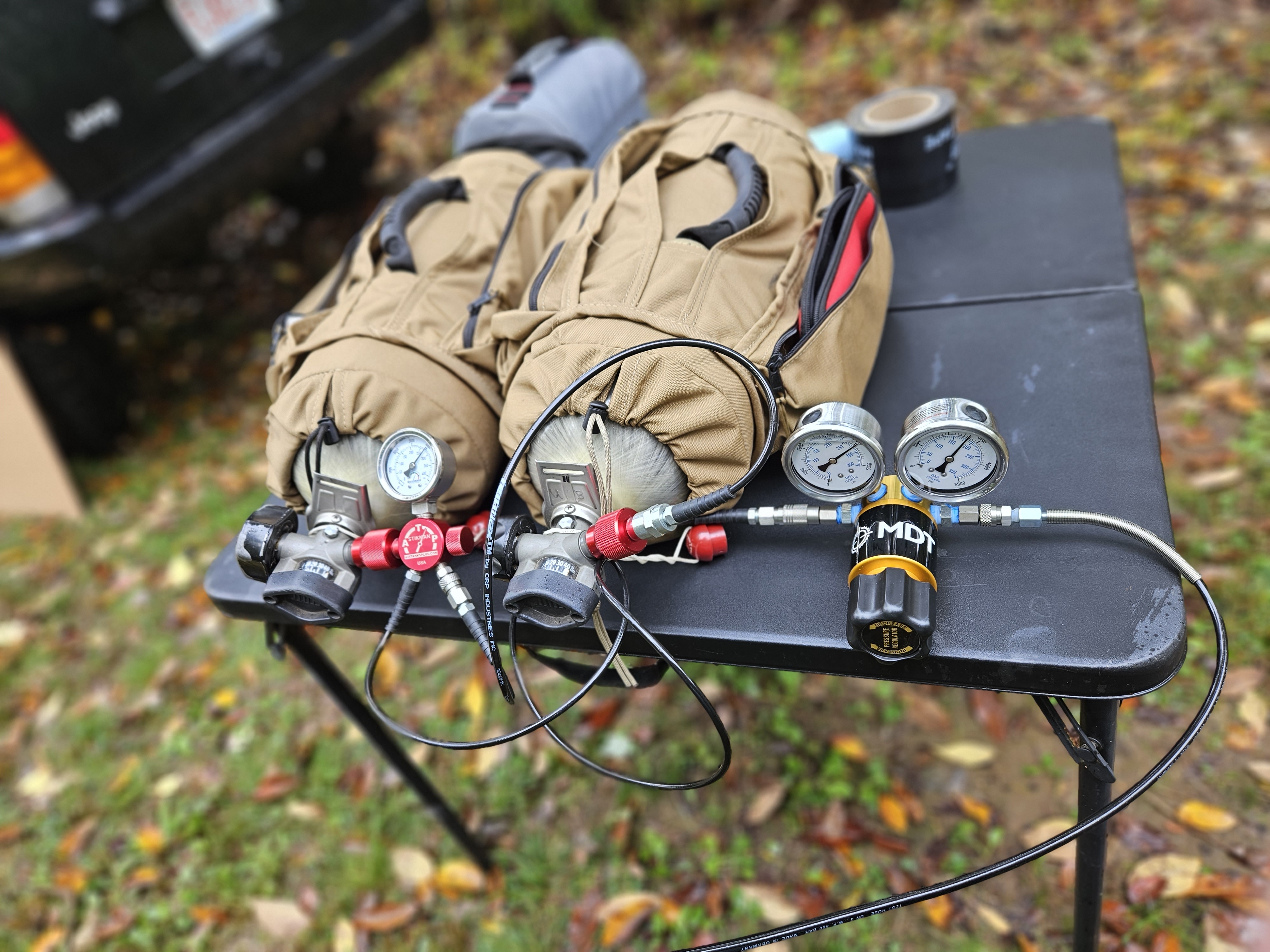

Wow...Amazing accuracy....257 definitely most accurate out of the Texans....I love your reg setup.... I have the same one ....but I like your plumbing setup much better..... So I take your barrel is smooth and uniform? No leading?? AVS seems to make excellent slugs from your results😀
I cleaned it tonight after shooting about 90 shots this afternoon and looking down the barrel it does look uniform. I will say though maybe I'm just spoiled but I instantly said omg this needs a polish as it is no where near the mirror finish inside my Evol barrel.
As far as the reg and plumbing, the reg did fantastic and goes really well with my airtanks plus fill/cascade setup.
