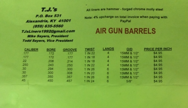

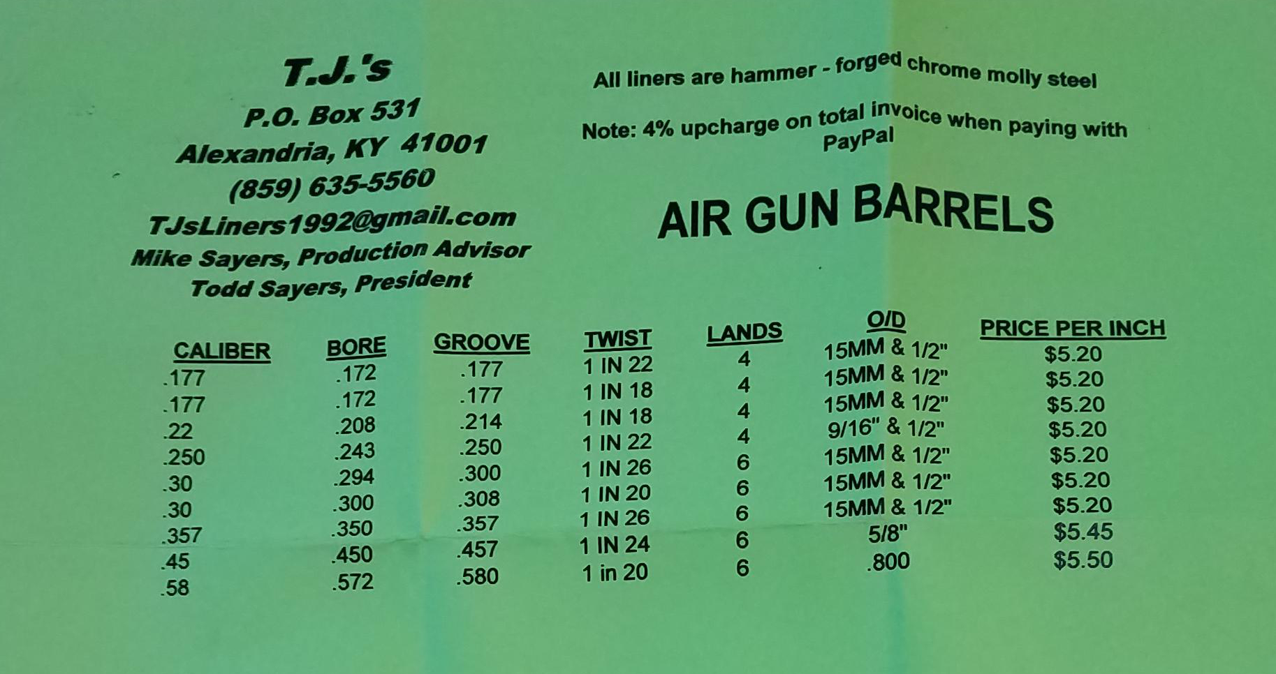

I recently bought a Western Airguns Rattler from AOA and curious about the actual bore size of the TJ barrel. I asked a couple of the guys there and really didn't get a concrete answer. So far the only specific information that I have found is that it is a 1 in 26 twist. Does anyone have a Rattler in .30 cal that has slugged their bore for the actual dimensions? If not, I'll do it when I take the barrel off for cleaning before range testing. It would be nice to get ahead of the game so I can order some molds to cast my own slugs which I do for all of the rest of my big bores. With the weather so cold and crappy here I was hoping to have my molds and sizing dies ready before the first range day. What say ye fellow Rattler owners?
