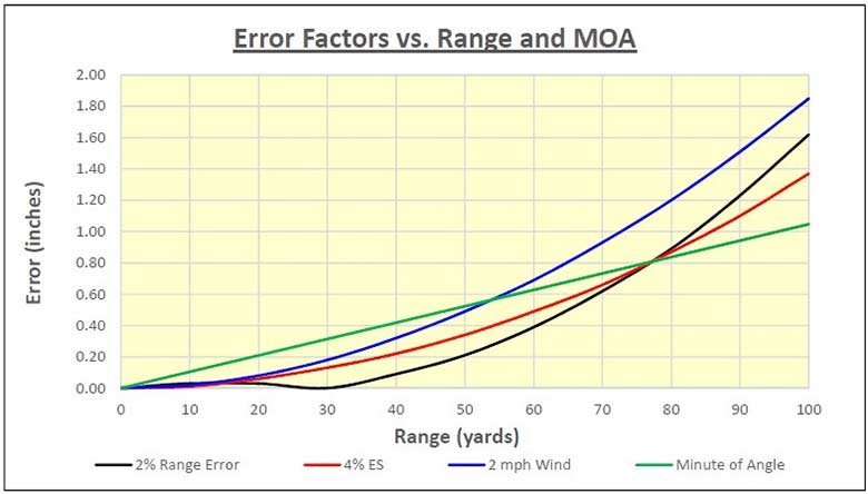

Bob Sterne, who mostly posts at www.GatewayToAirguns.org (GTA), has written an article about this that has opened my eyes to understand our shooting hobby at a whole new level — in just one simple chart Bob put four separate factors together that we usually don't see together.
See the chart below for yourself, it describes how much the following "errors" each affect the group size at different ranges:
• Extreme spread ES (muzzle velocity variation)
• Wind estimation error
• Ranging error
• Barrel precision (group size the gun is capable of)
Matthias
Ballistics.   Impact on Group Size  Of Wind Estimation Error  MV Variation ES  Ranging Error  ...jpg
Link to the article:
https://hardairmagazine.com/ham-columns/how-important-is-extreme-spread-to-accuracy/
• Ranging error
Matthias

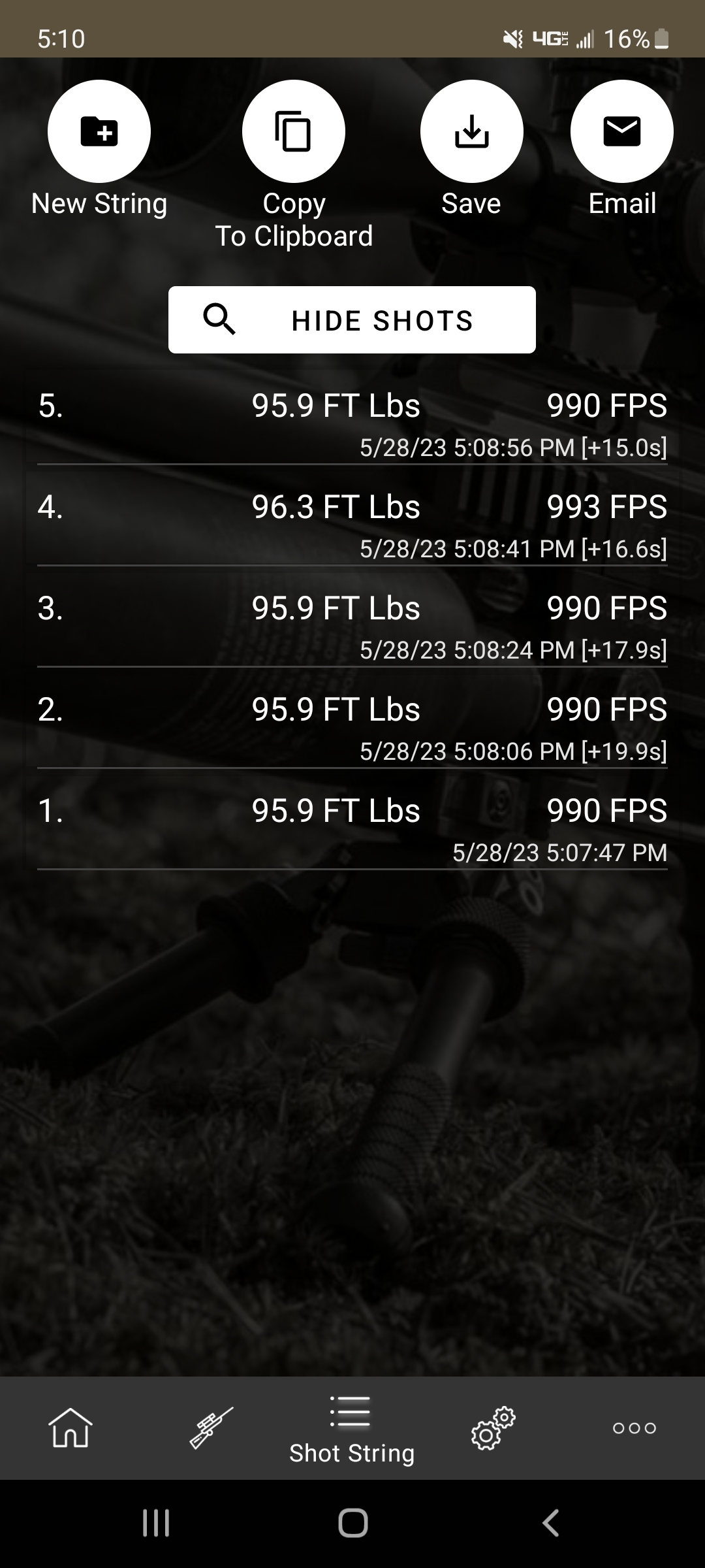

Im getting under a half inch at 50 yards and hitting eggs at 200 yards with my M3 and i had the same problem with a crazy spread, until i deleted my front reg. Now it takes less reg pressure to achieve the same velocity i was getting my reg set 20 bar higher than it is now. If your going for a power tune i would delete the front reg but if your shooting pellets then you need to find the right balance of hammer valve and reg. I get consistent 3-5fps spreads with my M3 .25.
