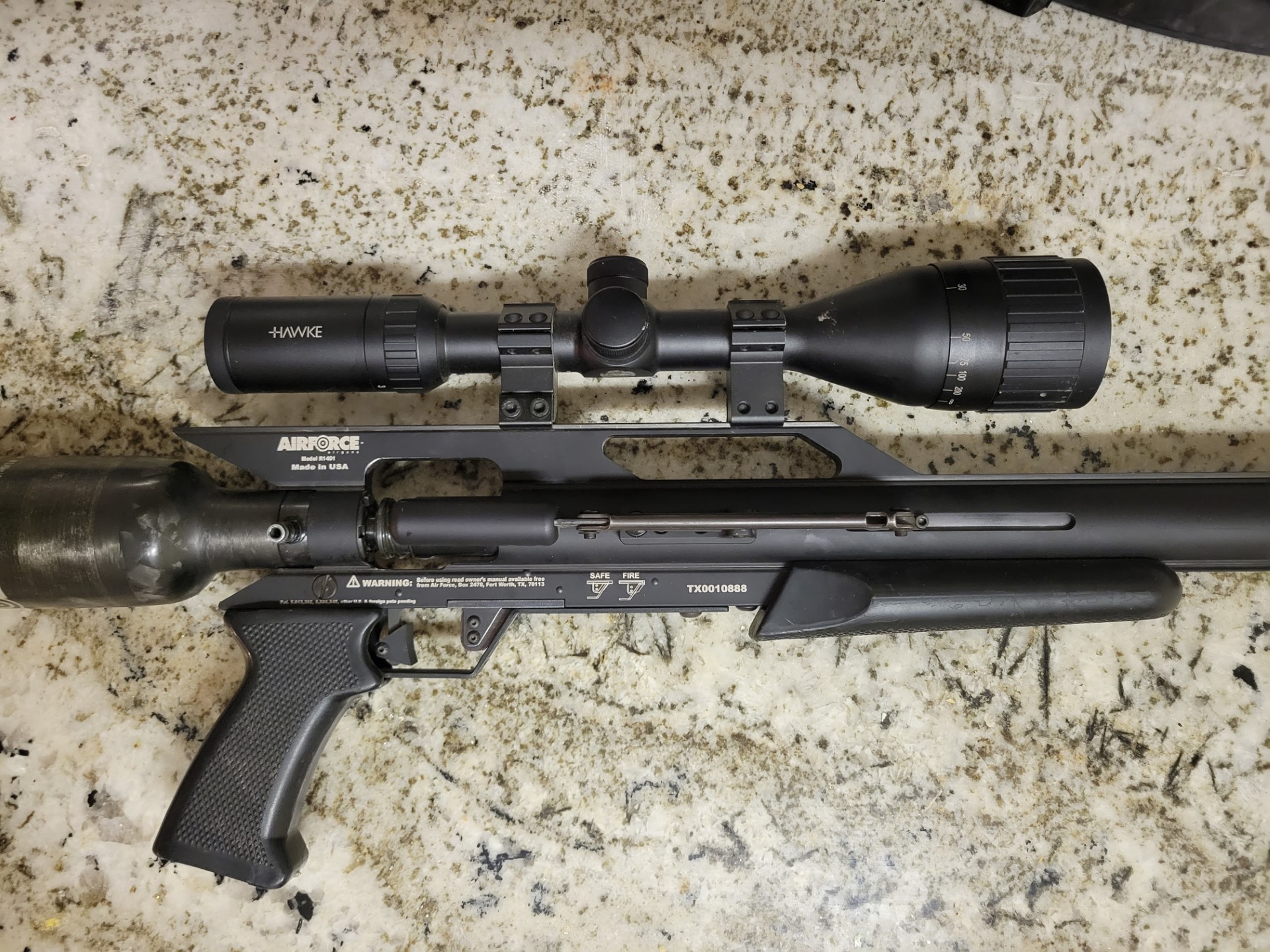

I've got a .457 Texan Carbine CF & a .457 AEA Element Max- both have a DonnyFl on them. I am having difficulty with accuracy at 90-100 yards. Usually I'm hunting axis deer so shot placement is pretty important. I'm currently using 240 grain, .457 hollow point from NSA. Any suggestions on how I can be more accurate? Is there a better gun, bullet weight, etc?

Dizzums- I'm willing to try just about anything at this point. If not a hollow point, what type do you suggest for deer hunting? I've been using 240 grain. Which one do you recommend I try next? Scope on both guns are pretty new & decent. Regarding compensating for a high-mounted scope- below is a pic of one of the guns. I don't think this is a high mounted scope- is it?
Those are some pretty big groups. I would first remove the moderators from both rifles and then shoot some test groups. Sometimes the projectile will clip the moderator on the way out causing accuracy problems.
If the groups are still big I would try testing different weight slugs both lighter and heavier.
Also make sure all the screws are tight on the gun and scope mounts.
