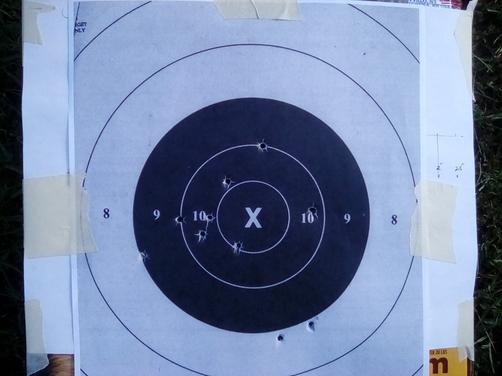

Acceptable offhand group size?

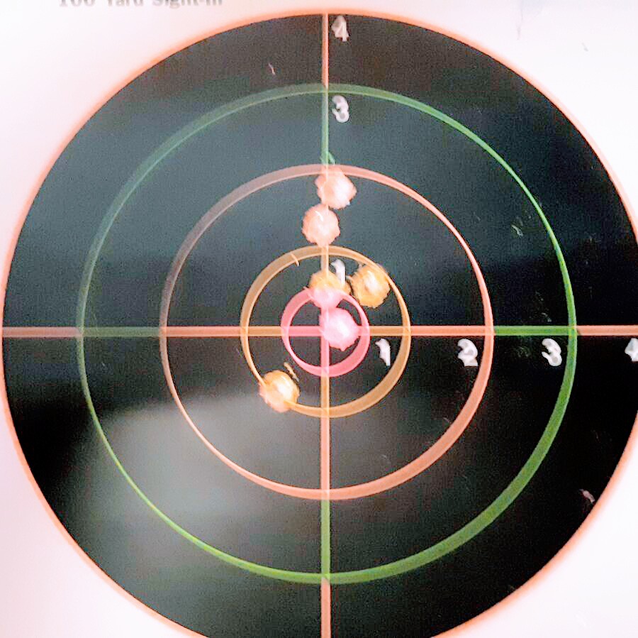

First thing this morning. Hatsan 130QE .30 at 40 yards open sights off hand.
Acceptable? I thought I shot five, but apparently shot six times.
That damn heat wave finally broke and I got the yard work done so I was finally able to get some shooting in.

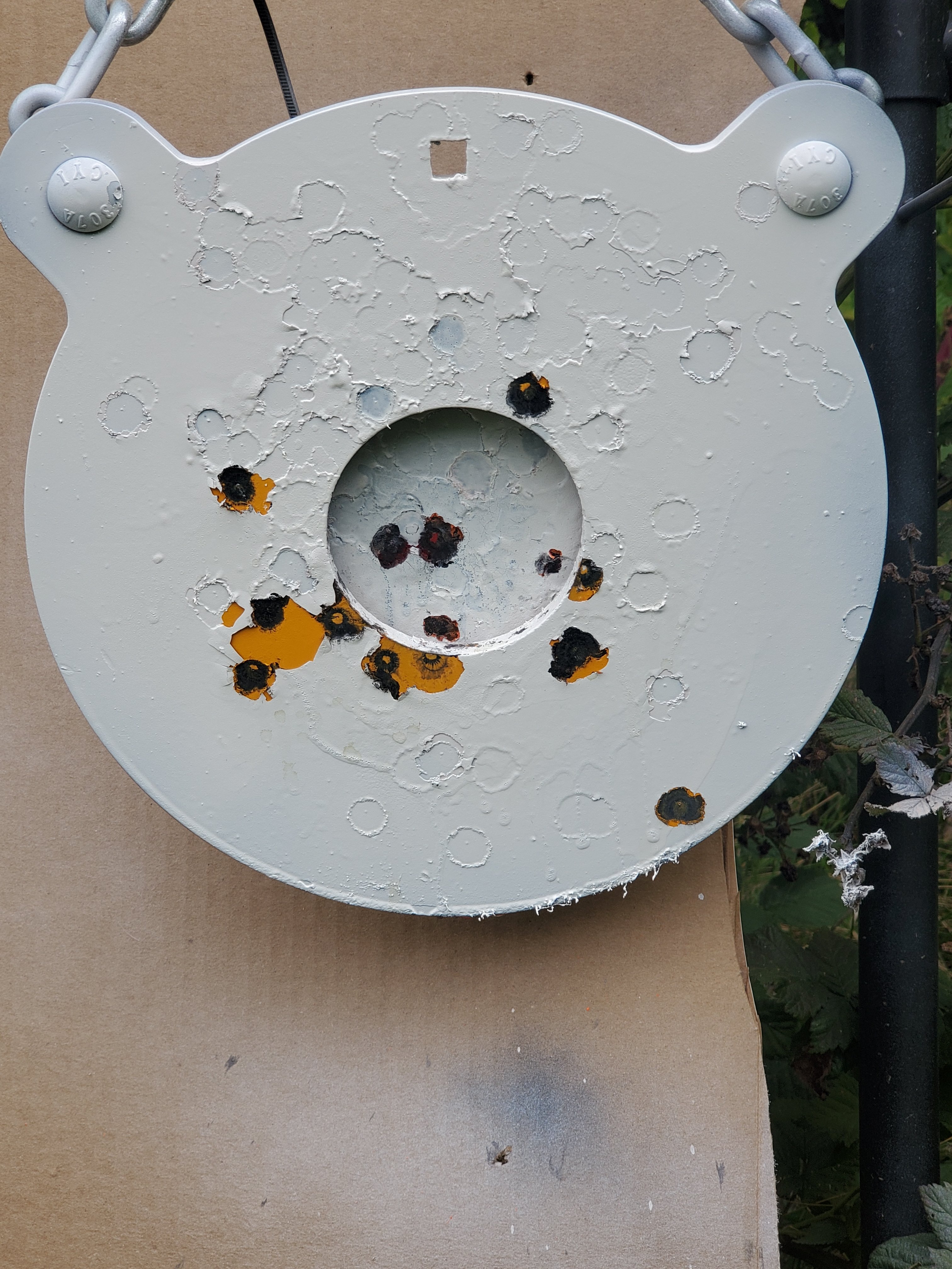

The top target is at 50 yards. Shot off hand standing 10 shots with the scope set at 5x. I was able to get 8 hits. Rifle was an HW95 .22 shooting CPHPs.
Bottom target also shot off hand 10 shots with same rifle but at 40 yards.

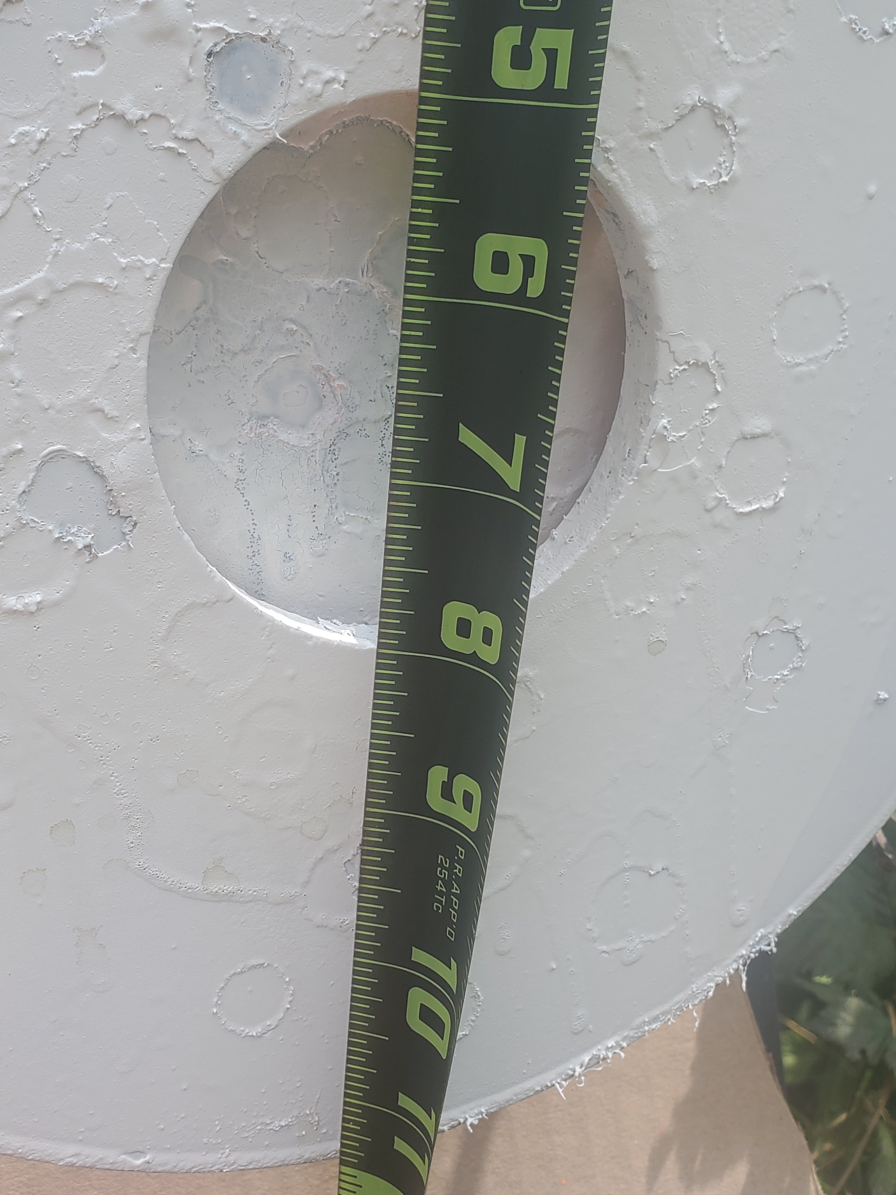

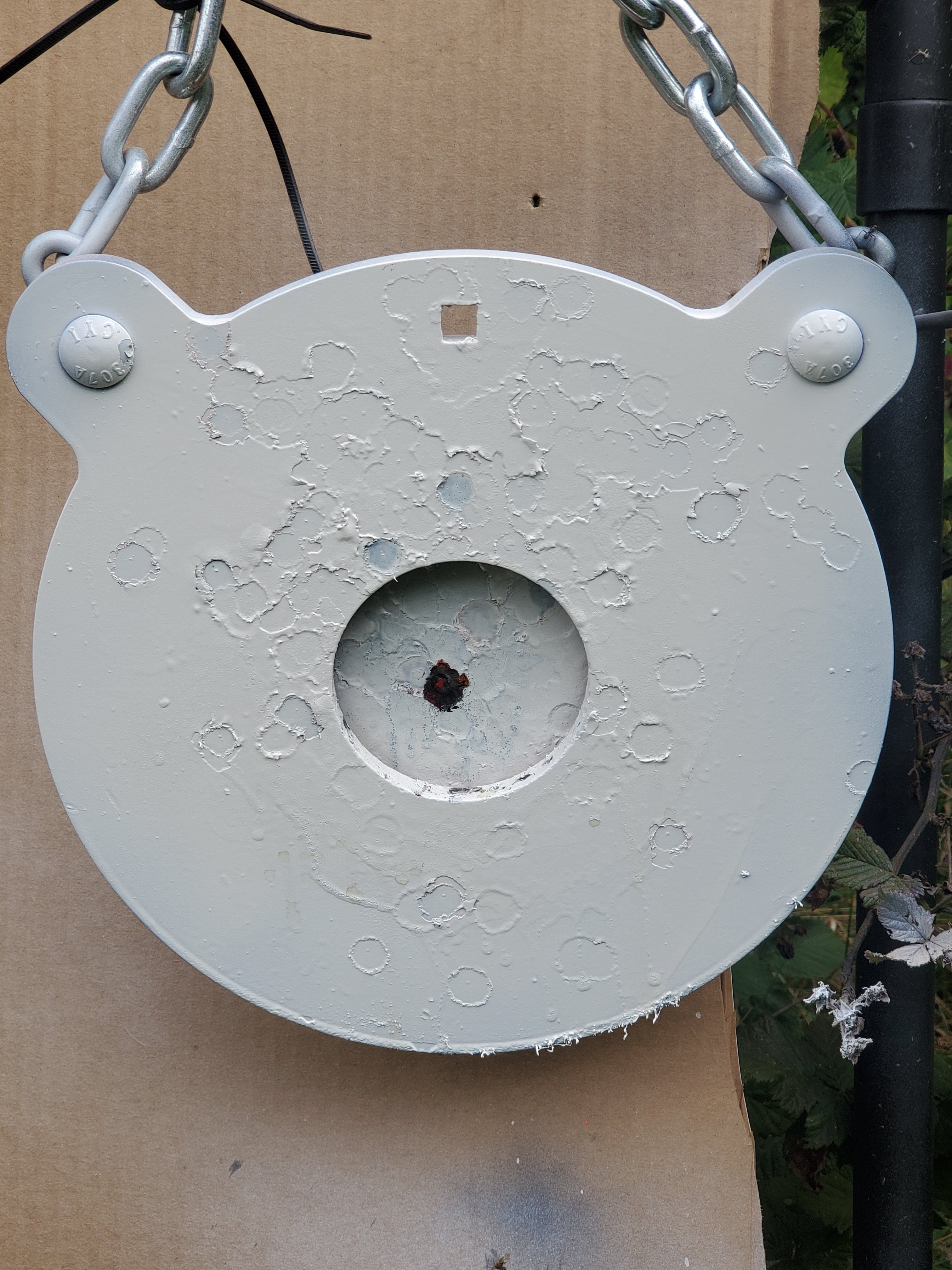

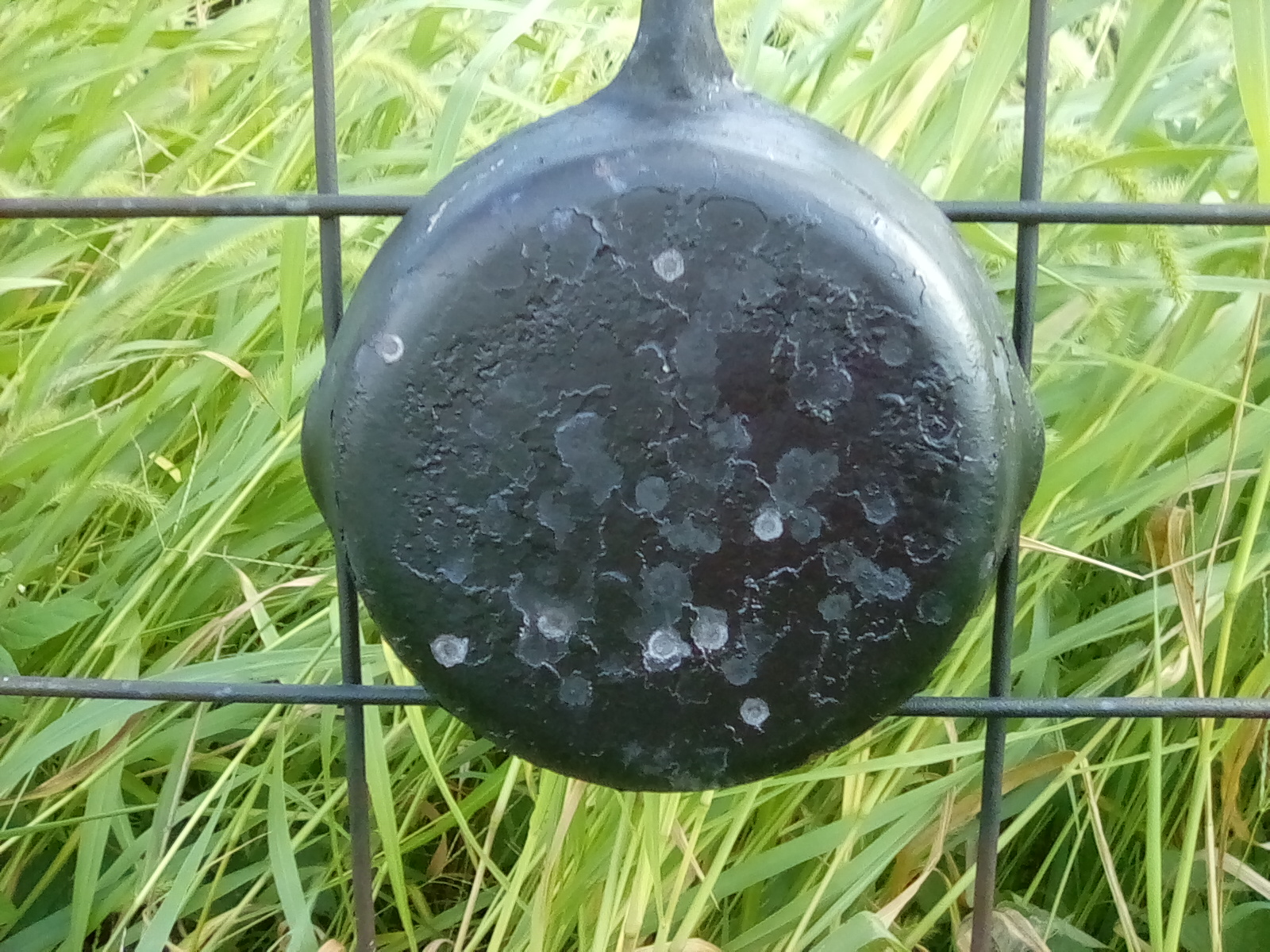

I love shooting my frying pans. I put modeling clay in the other side for something different to shoot at.
So I figured I'd check back in. I've been shooting but the groups looked similar to the 1s I already posted so I just kept practicing and didn't post any pics.

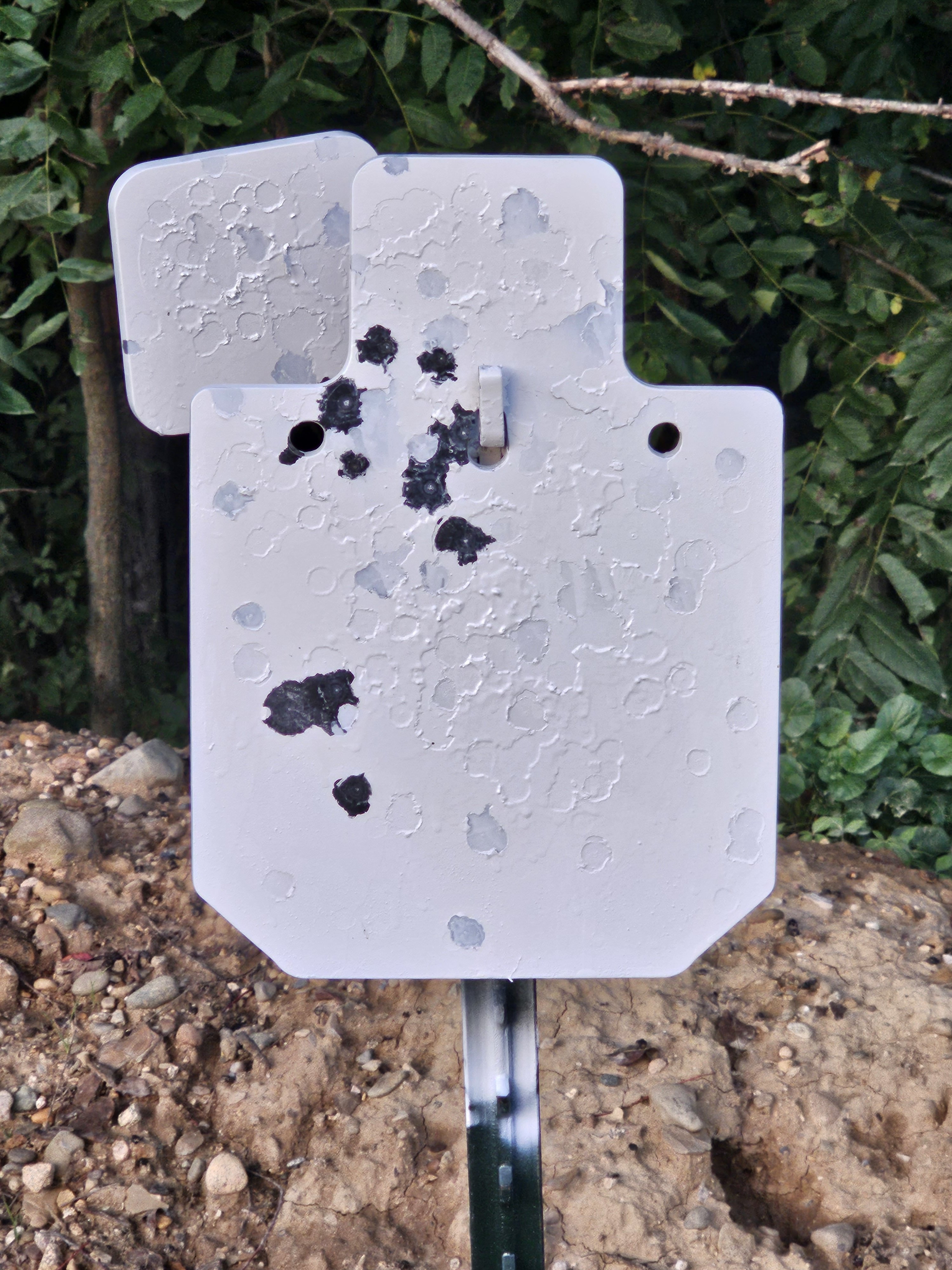

I can tell I'm able to hold on target for longer now. I got done shooting at 50 yards yesterday and walked back to the house. I have a steel hostage silhouette target setup and figured what the heck and took a offhand shot at 68 yards and nailed the bad guy dead center. No pics but it did happen lol. I'll continue to practice and im always following everyone's posts in here so keep it up.

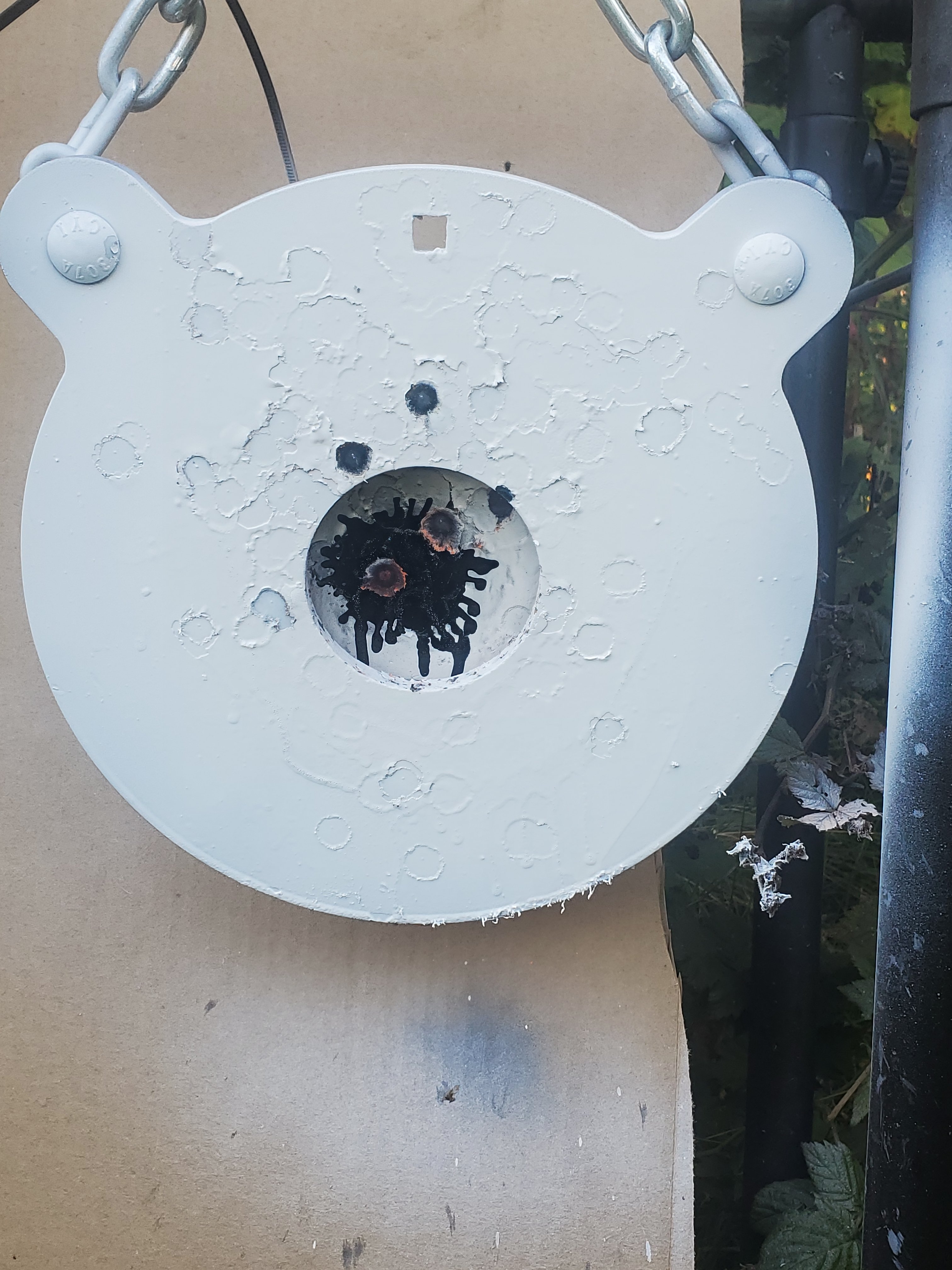

Last group I shot at 50. It's not a whole mag but im starting to get more bullseye hits and it's getting slightly easier now. muscle memory is slowly developing. Also the muscles you use to hold steady are becoming sore so I know I'm building those up.

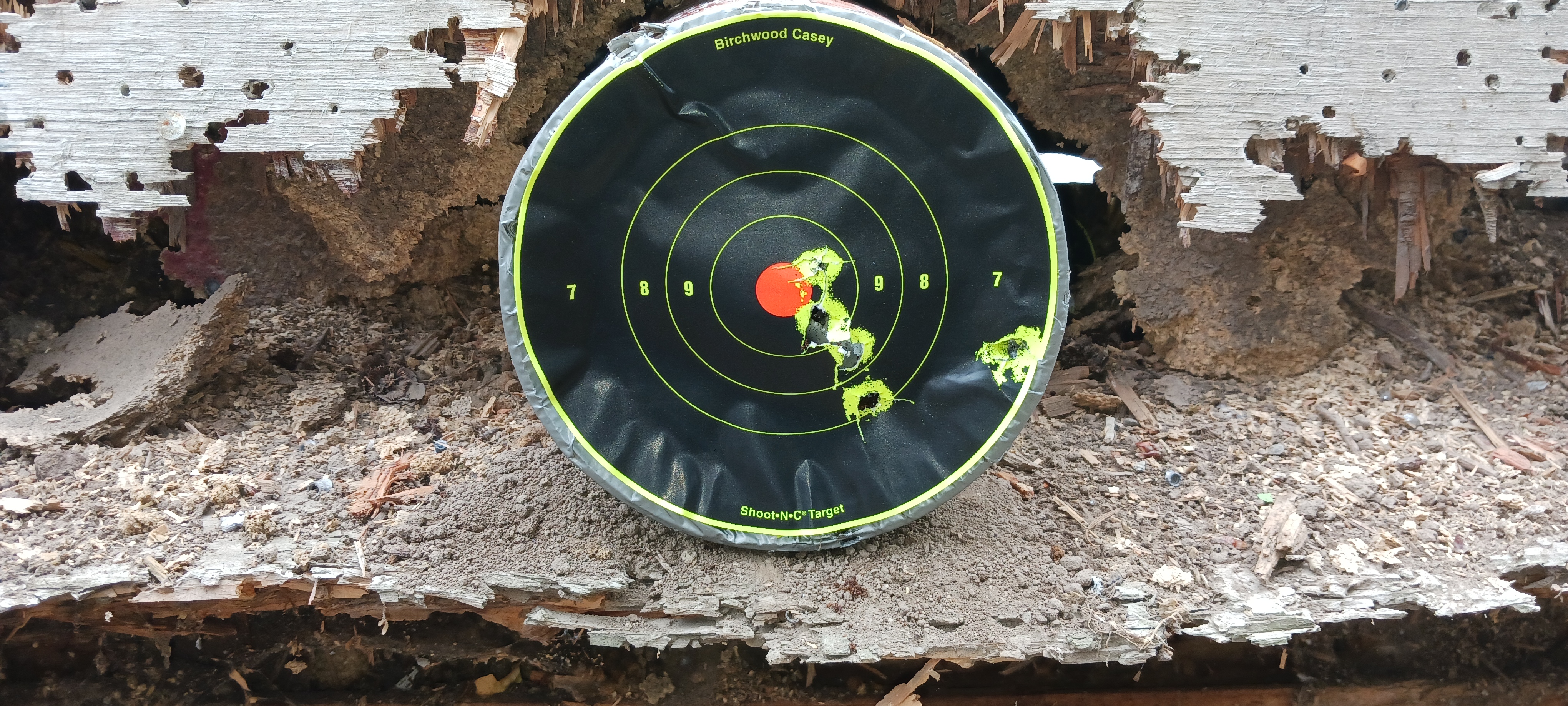

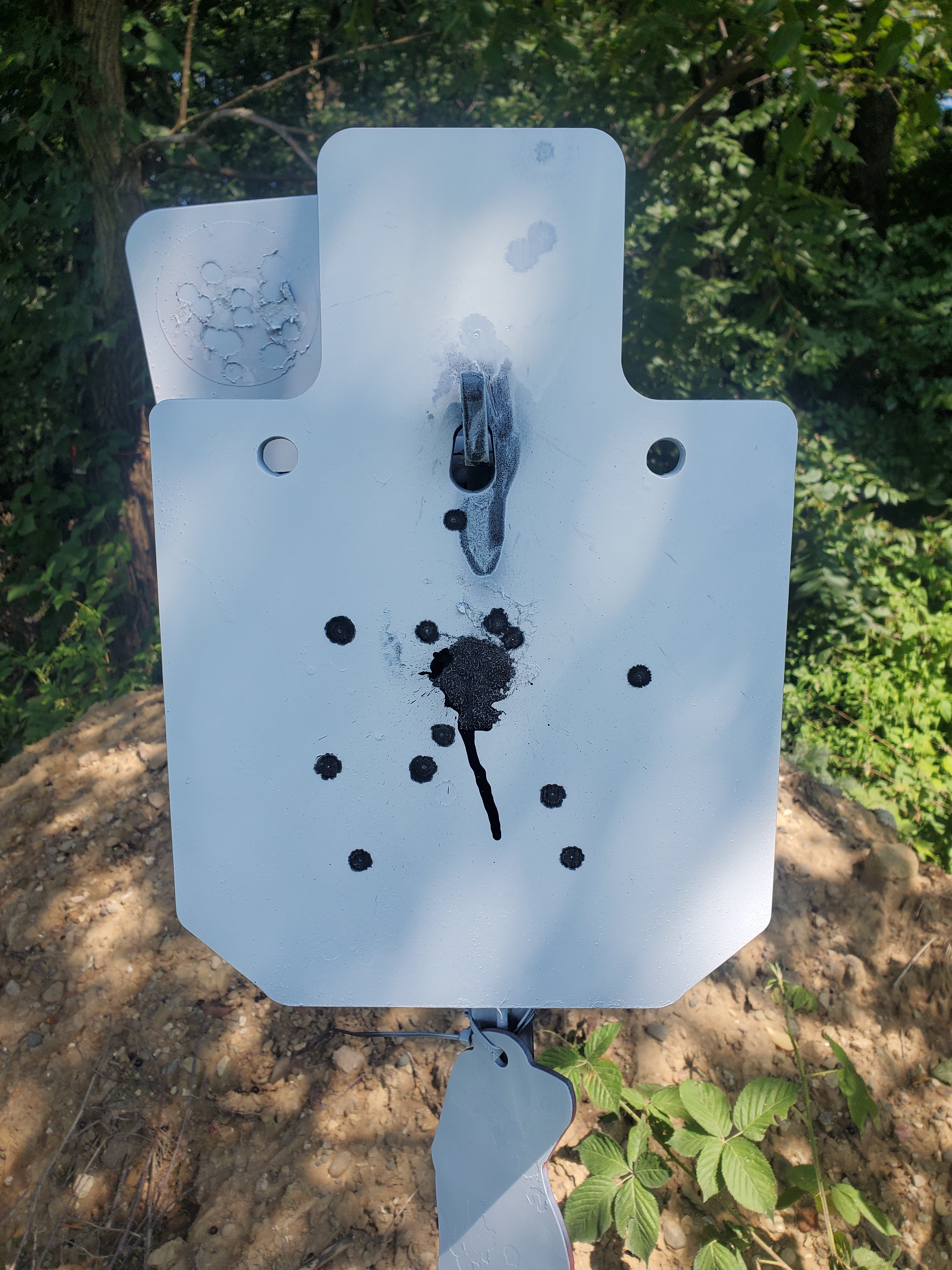

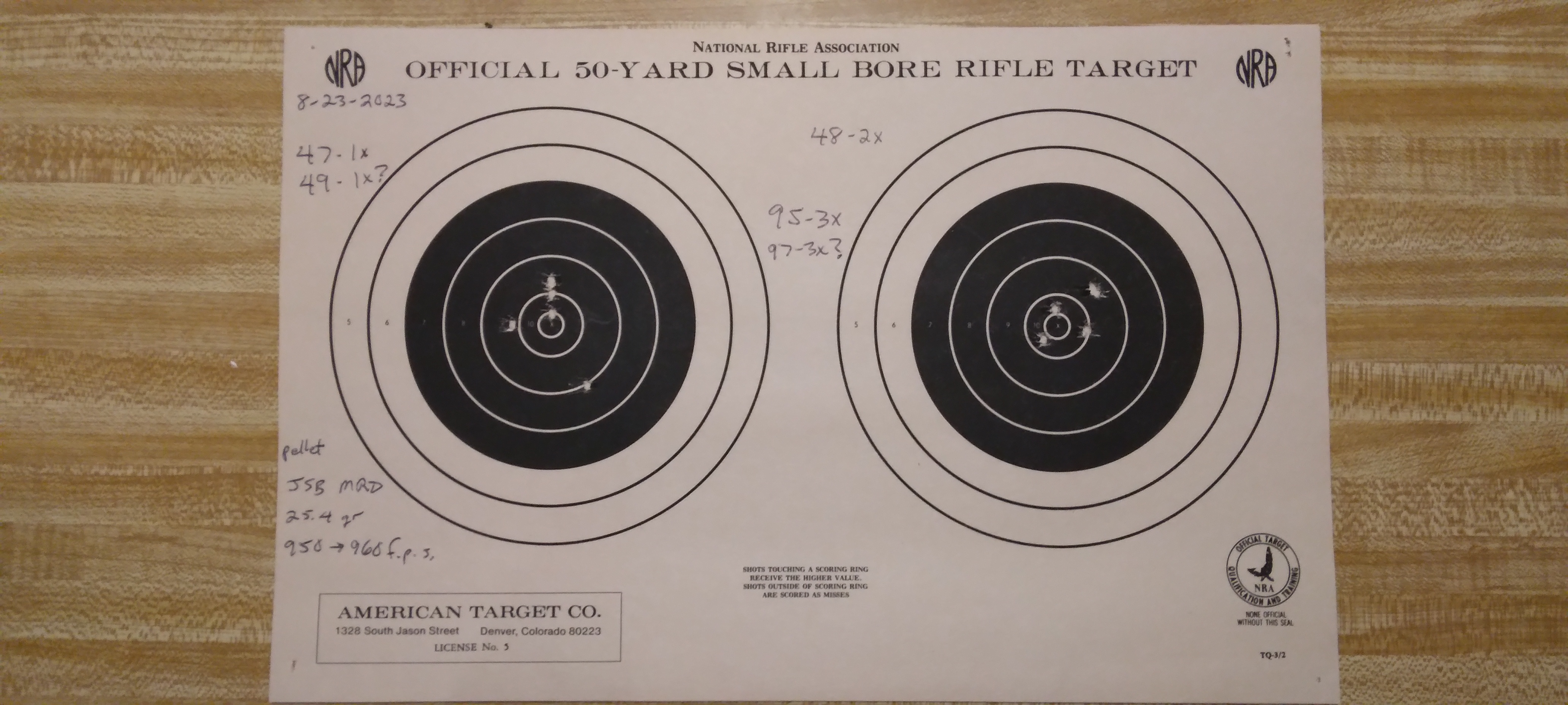

Pulled back to 50 yards tonight StandingView attachment 383044. 1 5/8" and 1 1/4" 5 shot group sizes. The jsb mrd pellet makes a different hole in paper than slugs.
Try to relax as much as possible, prep for your next shot by relaxing and taking at least 6 full relaxed breaths, rest your rifle on a tripod in between shots, get a sequence that you are comfortable with, and adapt if needed. Work on your body position of hold, at the beginning of learning curve, it will take time to get a good position formed. Always working on your method, and adapt to new styles, as your skill grows. Stay at it, it is hard work, but well worth it once it is obtained.

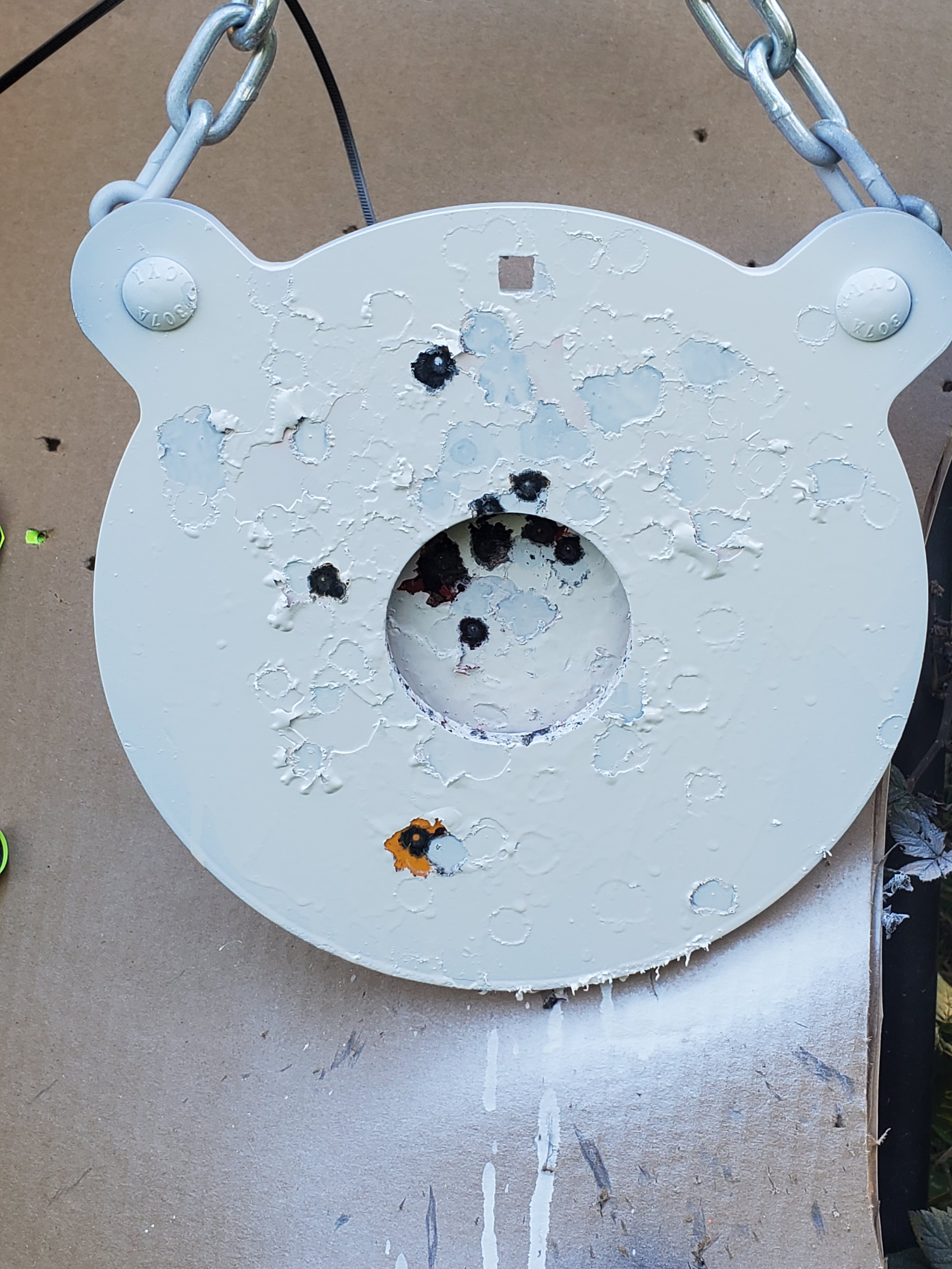

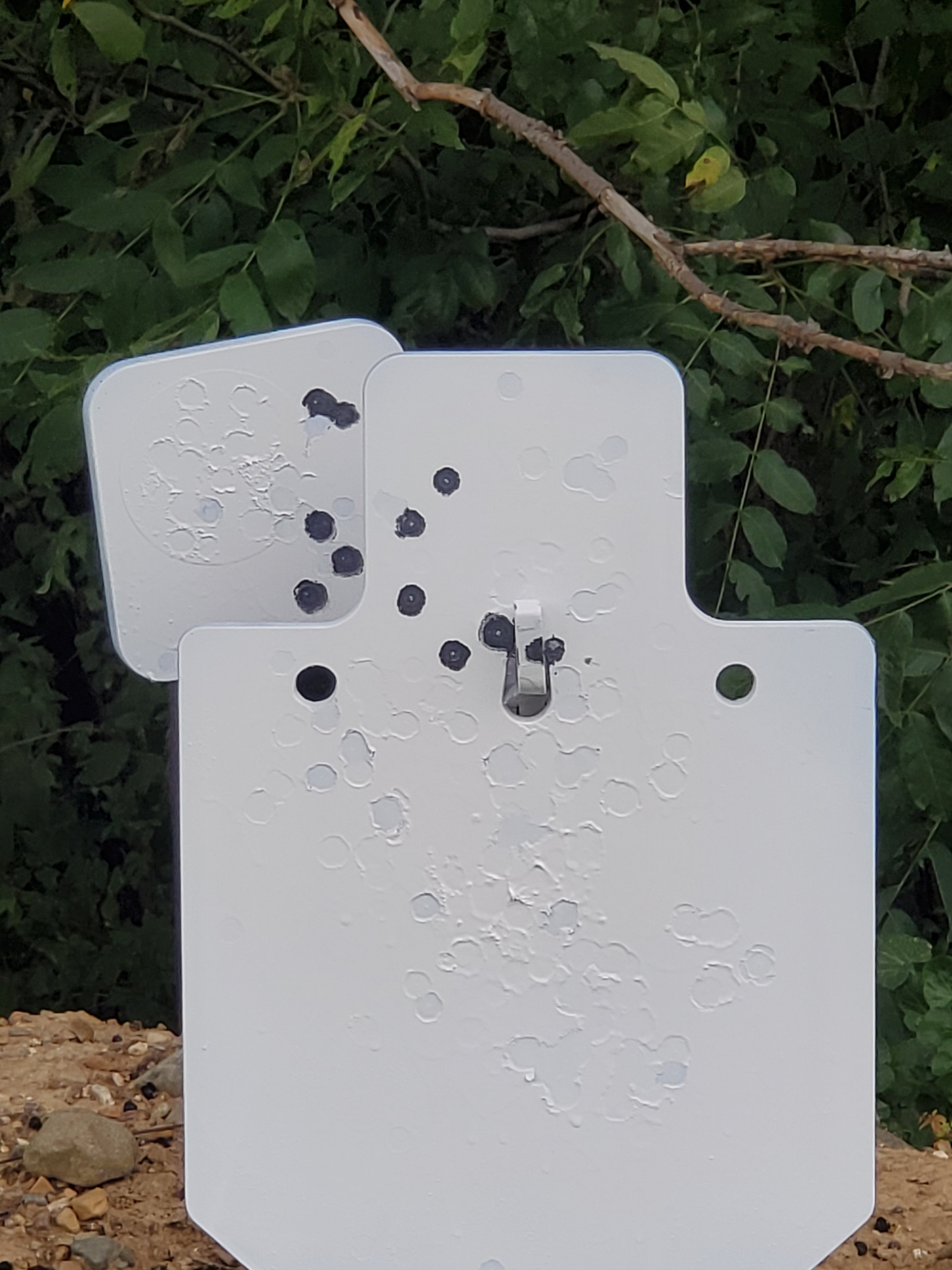

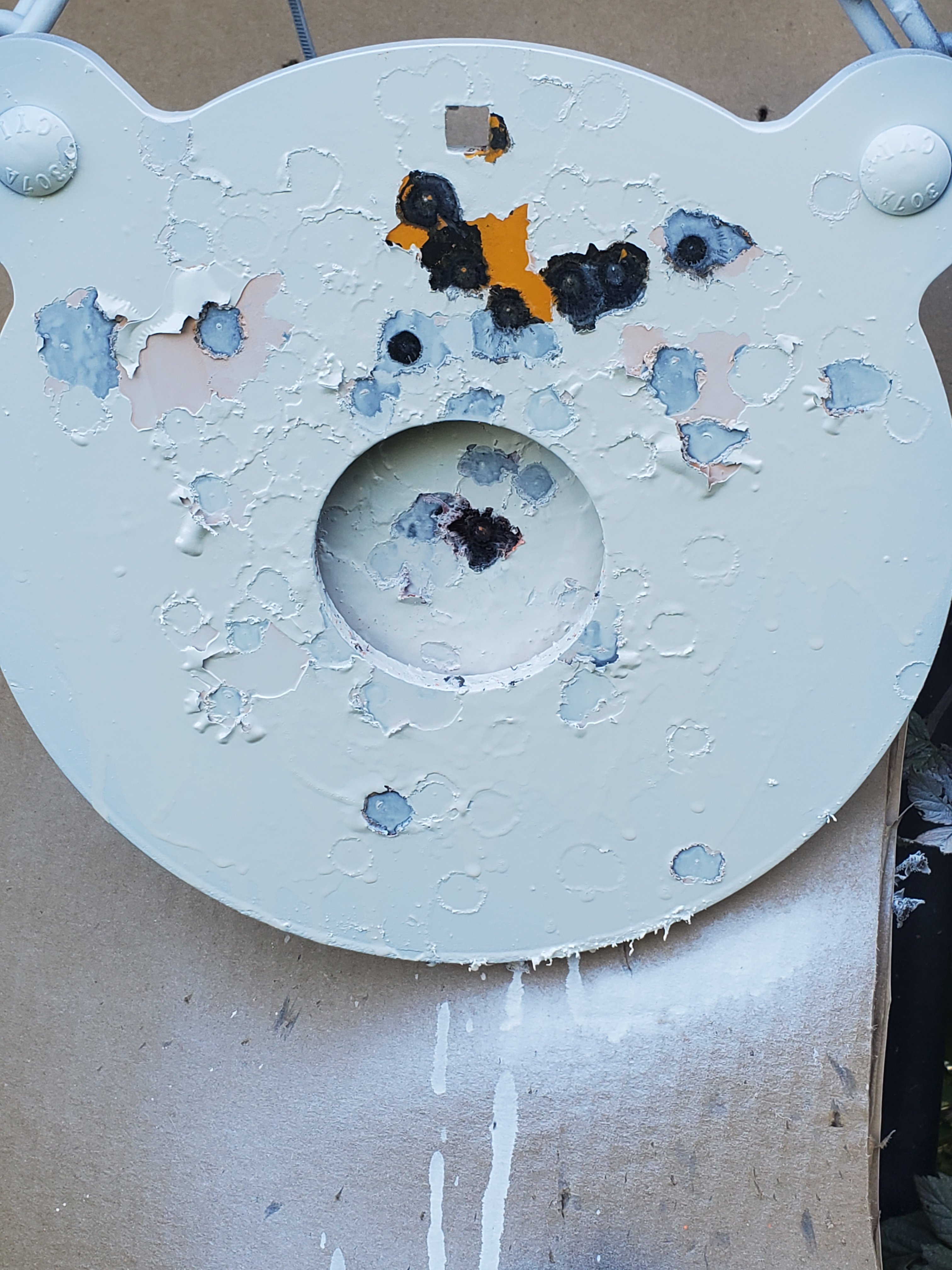

This was 2 groups. 1 with the evol on the silhouette and the uragan on the circle gong. Both groups started out bullseyes and then the wind started kicking my butt. It was blowing me around so I'm sure the pellets got influenced also but i didnt care I tried holding dead center on every shot.
I absolutely have better days than others. Some of the earlier postings were on a day I was shooting well.
My best guess is I usually shoot my groups within 1-2 minutes per group. Still forcing myself to follow through, which is probably the hardest for me currently, along with finding a comfortable grip on the forearm.

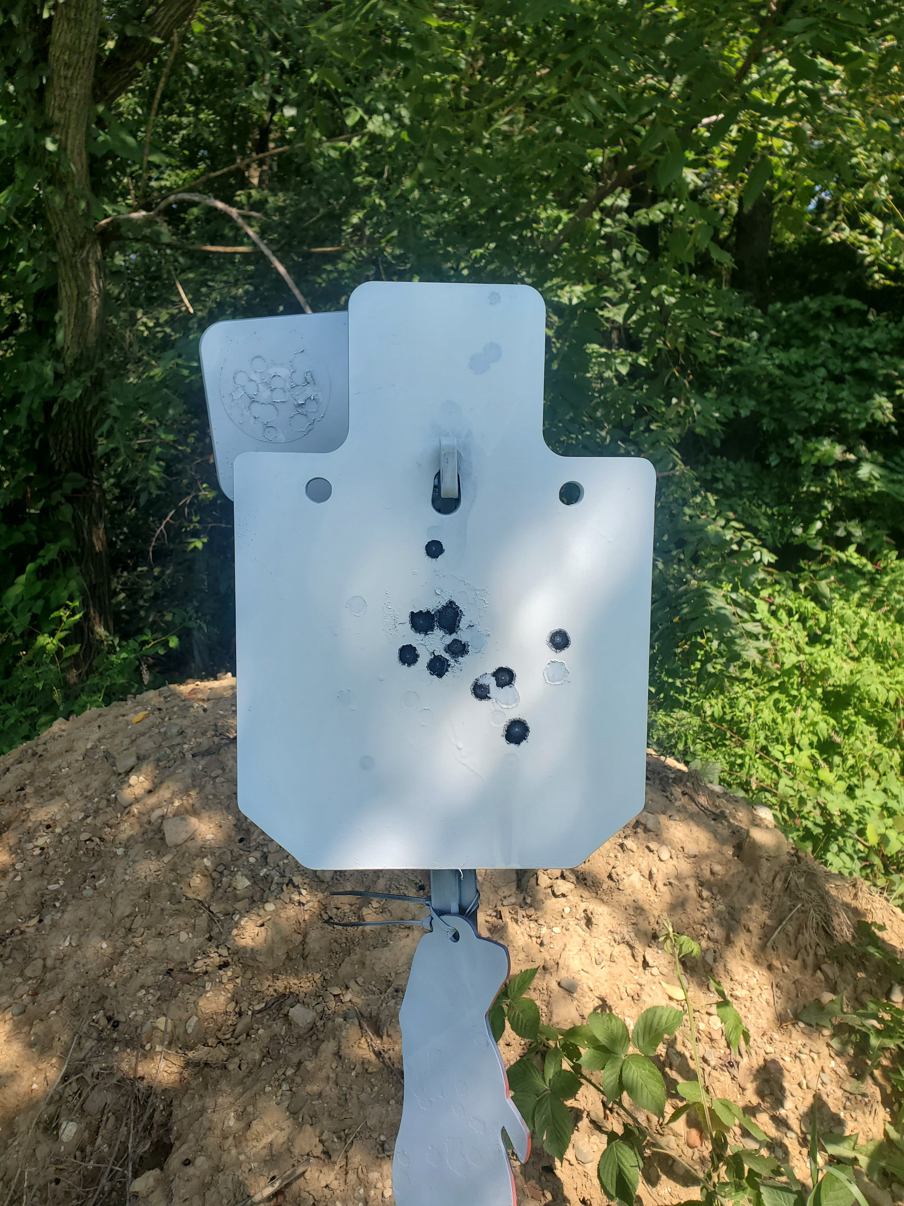

This was the start of the uragan 2 group from above. The silhouette was aiming at the target hanger and the 1st shot was also on the hanger... just saying 😆. It started raining on me so that's all i got in today. I'll have to hold steady inside looking at the wall for some reps! Thanks to everyone has given advice and contributed to the thread. Have a nice evening all!

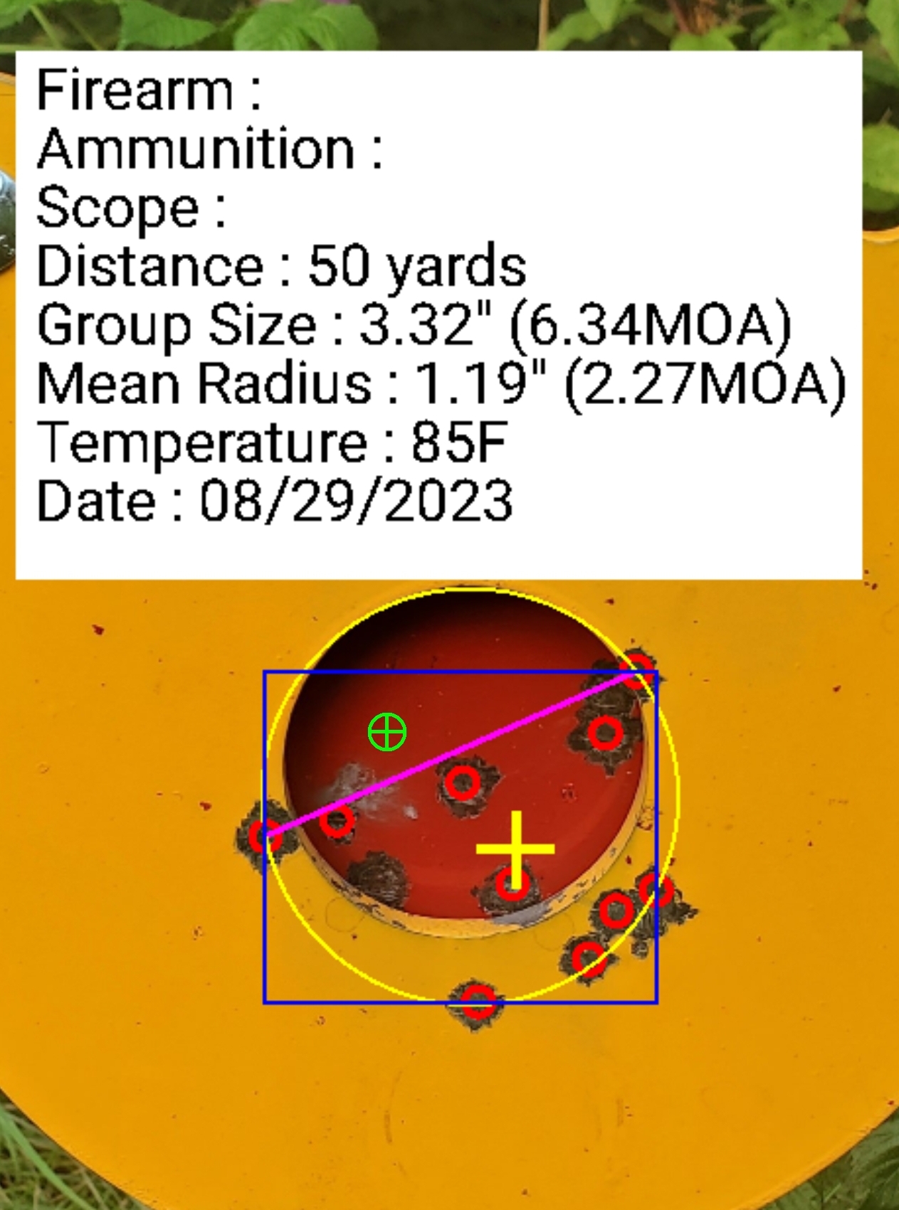

I'm curious what everyone feels is acceptable group size for shooting 50 yards offhand? I usually shoot off a bench so give me a break 😆.
I've just started practicing offhand at 50 yards and my 1st go was laughable. This was my 1st attempt with the uragan 2 compact 22. At least it leaves lots of room for improvement 🤣 i painted a black spot to aim at then decided i didnt need it for the other groups.View attachment 382838

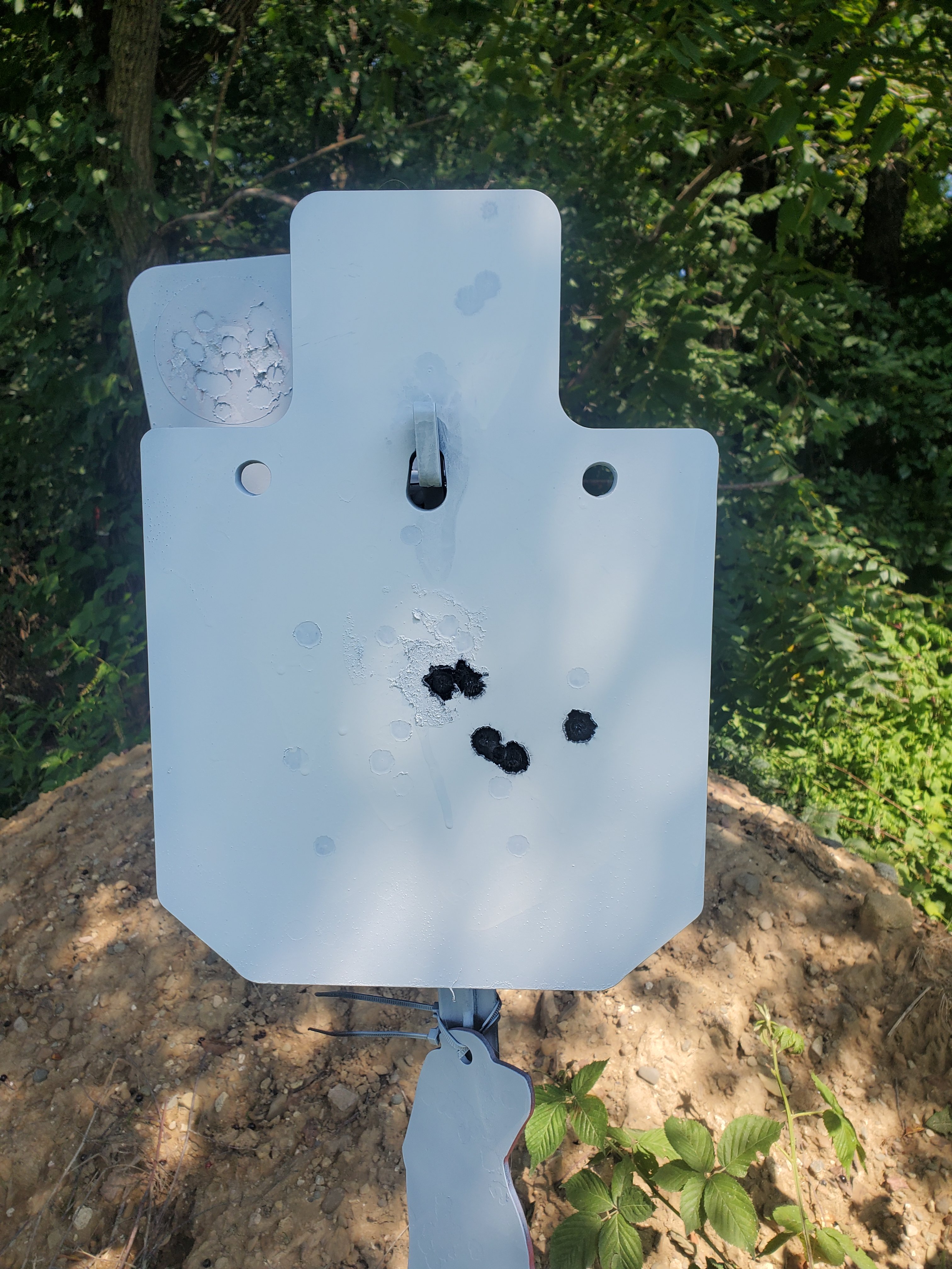

Then I started aiming high on the target and dropping into the kill zone as I squeezed the trigger. This improved my group considerably but still not great. This group was from the taipan vet standard 25. Mag only had 5 rounds in it
This group was my attempt at redemption with the uragan 2 compact 22. Much better but still not real good
I'll be practicing more each day to see how much I can improve. My goal is to be able to consistently hold 3 inch 5-10 shot groups at 50 by the end of October. Not sure I'll reach that goal but I'll try.
Feel free to post your 50 yard offhand groups or just let me know what you consider acceptable by your own standards for 50 yards. I'm not talking cherry picked groups either. What's your average out of 10 groups of 5+ shots per group?
Also if you have anything that helped you with offhand shooting feel free to post up the info. Never know what I might be missing or doing wrong. I try my best at having good trigger control but I'm figuring out the rest as I go.
