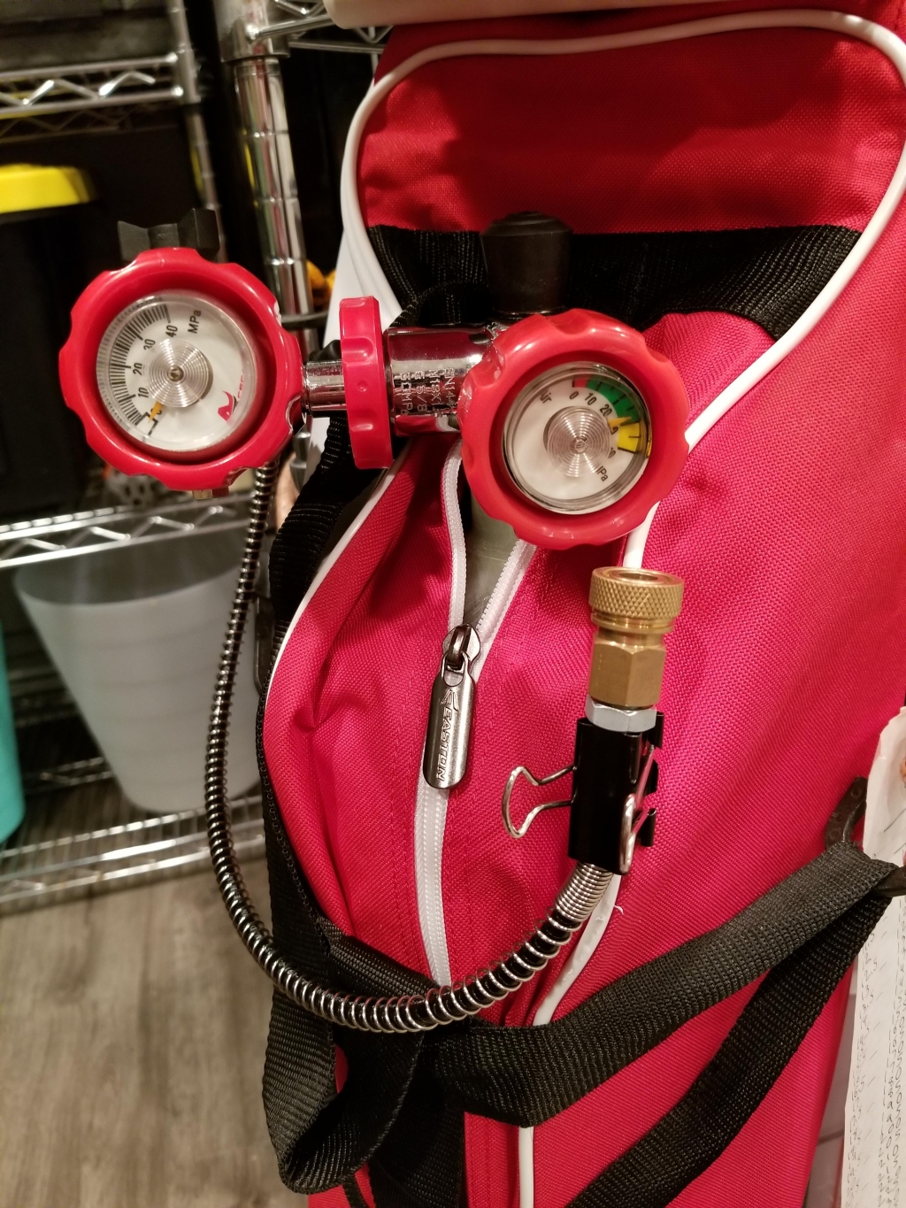

I have a 6.8L version of that set up (dual gauge). I have been very happy with my mine. Quality construction and the gauges are accurate. Speaking of gauges; I suggest getting the two gauge assembly. The tank combo you are looking at will only give you the fill line pressure after the tank valve is open. A two gauge fill assembly will give you a constant reading for pressure in the tank as well as fill line pressure. I assume that you have or are getting a compressor? This is not a DOT certified tank and therefore can not be filled by a dive shop. Acecare does have DOT tanks available but they are considerably more expensive.

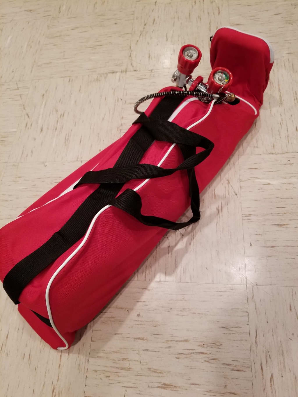

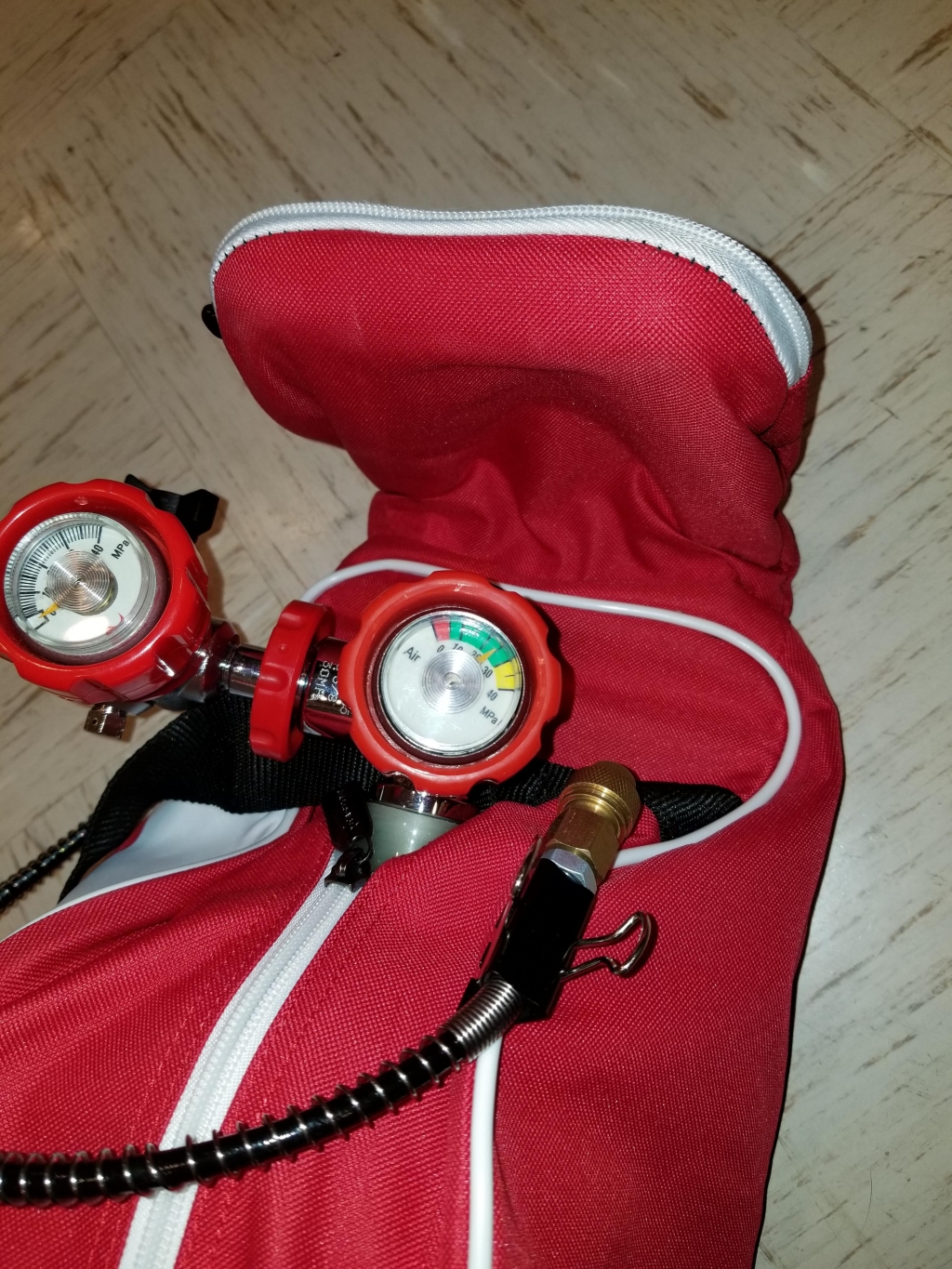

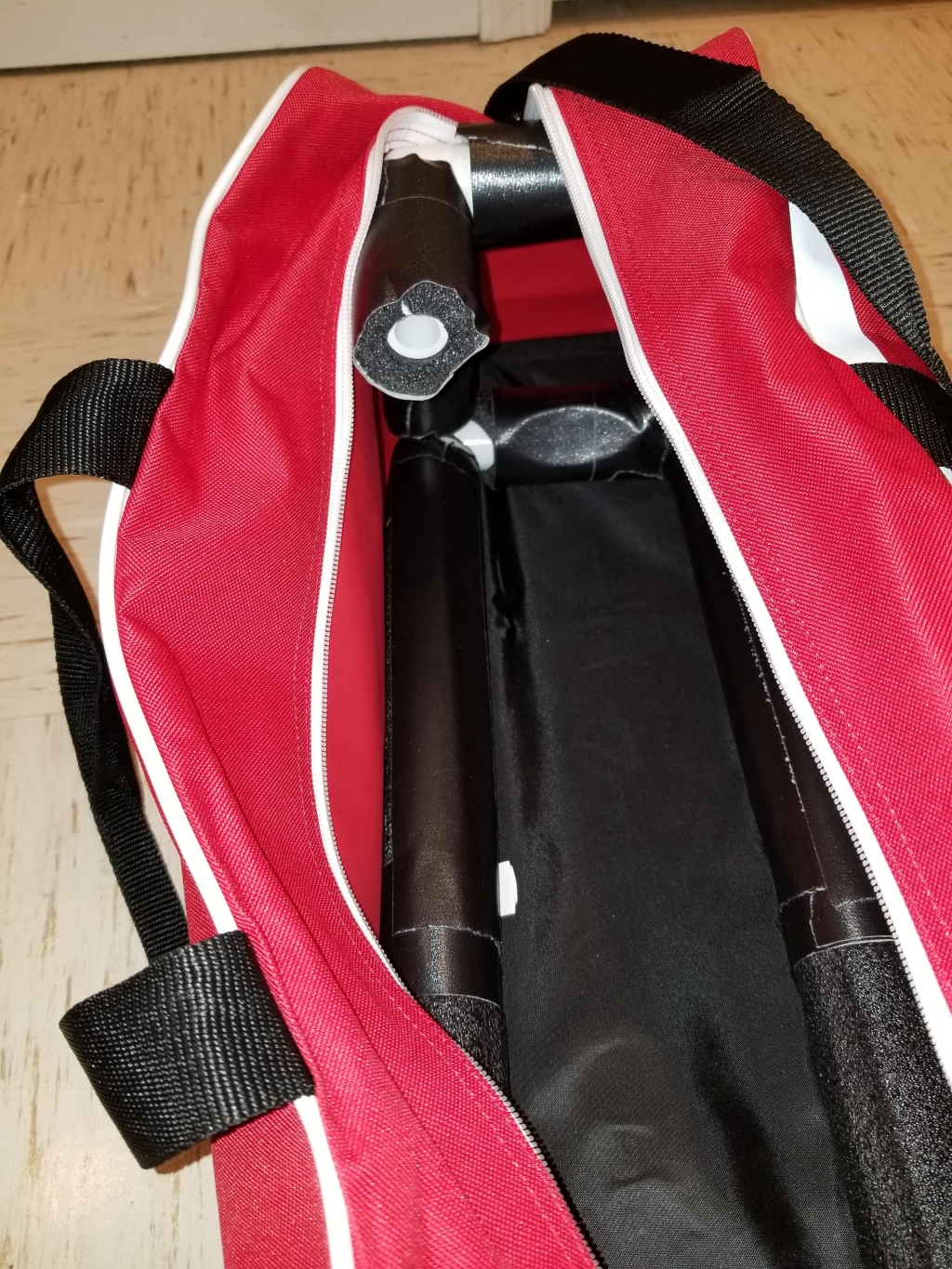

I bought the following from Acecare early last year:
2018 New 9L 30Mpa 4500psi carbon fiber cylinder/ high pressure air tank with valve and filling station for paintball tank refilling × 1
Acecare was selling direct at that time and the setup was $247.16. If you search this forum, several folks have bought tanks from them. I posted pictures of my tank in one of the threads. Their direct website is no longer operational (pcpmall.com). My tank was not DOT certified and was held up in customs for completion of DOT paperwork. I told UPS it was not DOT certified and was used for paintball and the tank was released from customs.
