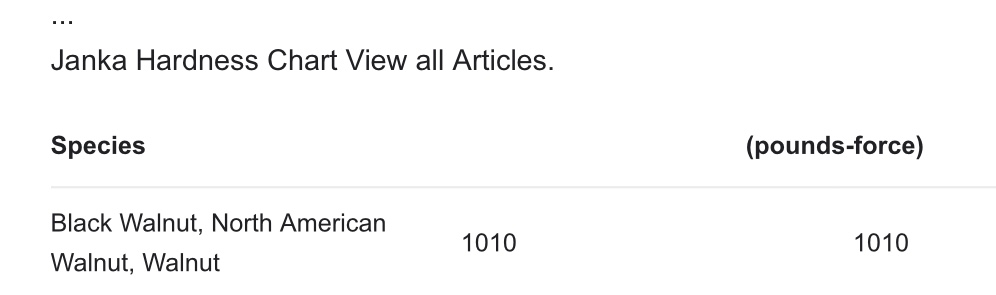

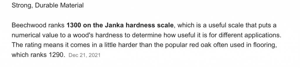

Beech is harder than walnut

The walnut on my tx isn’t as hard as the American walnut on Winchester 52’s or my 40x.

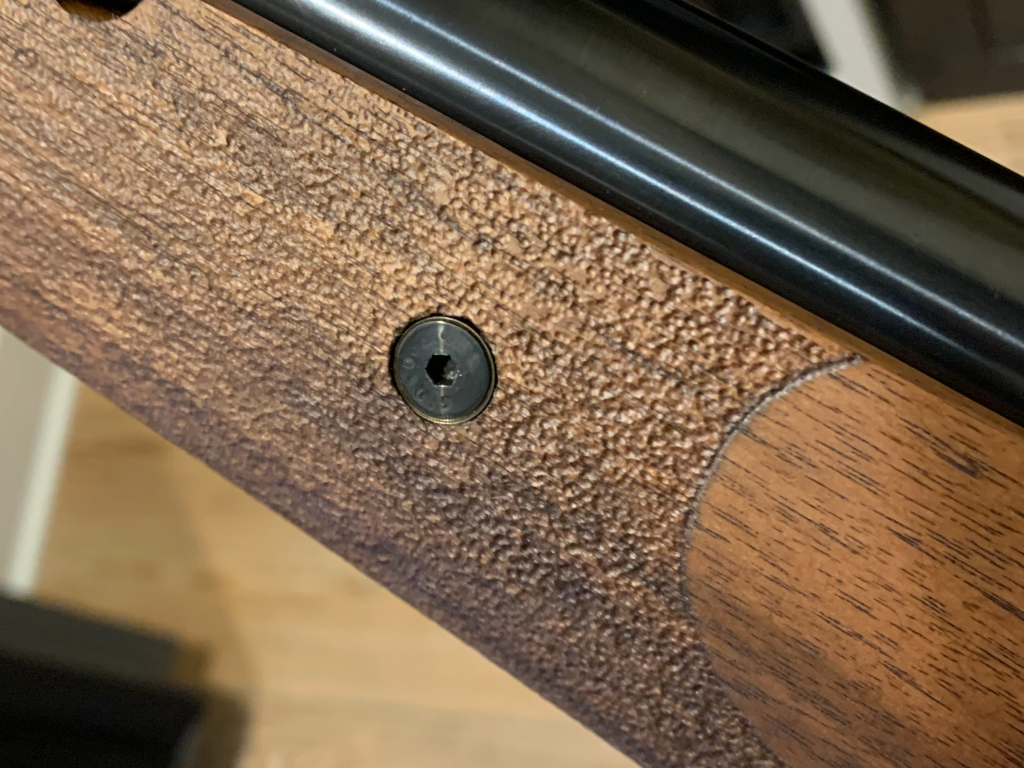

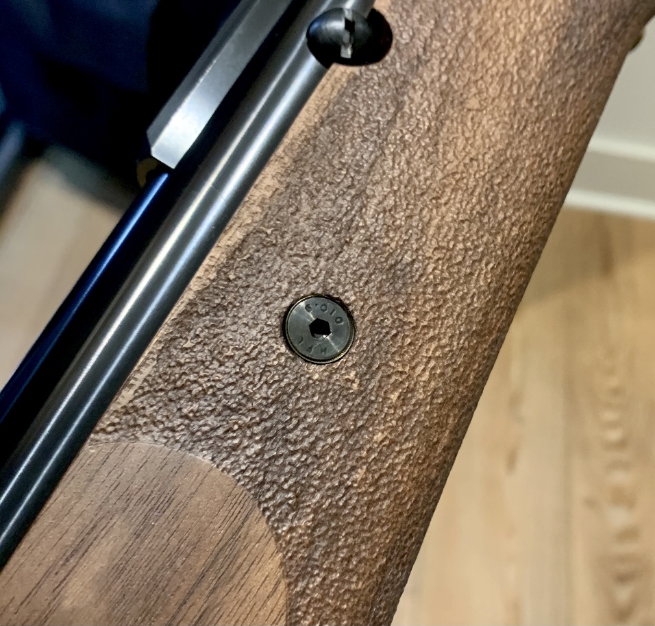

Looks like the inserts I use to make, I used brass when the gun had other brass accessories but used blued steel on rifles that had no other brass details. Appearance thing I guess....in my experience the AA guns had better quality screws than the HW rifles. Always had much better sucess with quality screws being used to replace the sloppy thread HW factory screws.
The inserts I posted photos of are hidden by the screw.
