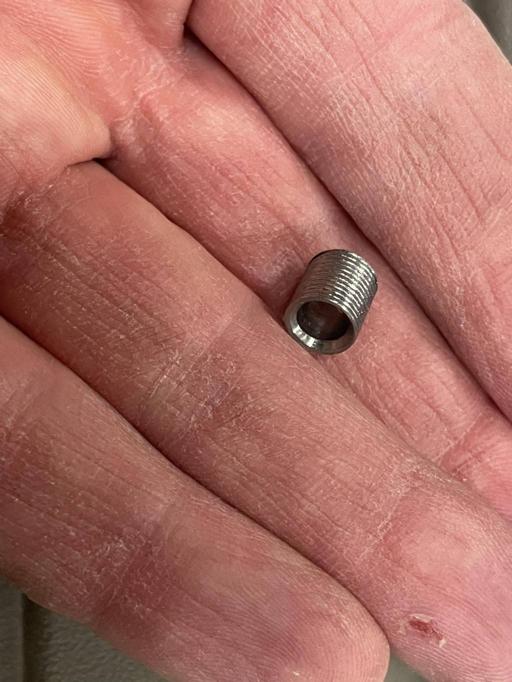

I couldn’t keep the screws on the fore end tight so I drilled out the holes in the stock and epoxied in a pair of bushings I made on my lathe. I haven’t had to tighten the screws since installing them.
