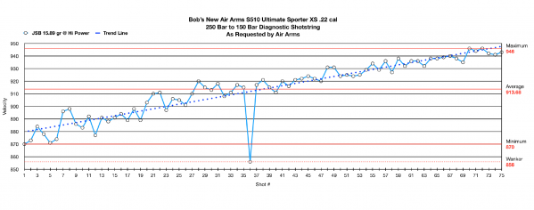

Heres the same graph but cleaned up a bit..sorry about the size...I'm not exactly Microsoft Certified in this stuff..

I hope they exchange it too. Seems they would maybe want to test my rifle for themselves. Considering it is brand new and I have experienced this problem from the very first fill, I don't think an exchange for a test certified rifle is asking too much.
If it wasn't for a 20% minimum restocking fee from Pyramyd Air, I might have sent it back already asking for an exchange. And if not for a 4 to 6 week turn around time on repaits, I might have sent it in for warranty work.
Huma did tell me that his regulator would go right into my rifle. Though I don't know if the manometer would still be functional. However that wouldn't be a deal breaker for a Huma being in can just fill to 220 bar knowing I will get 60 good shots .

Bob your are a nice guy but not very smart. came to the wrong forum too as said. cant blame you...
I told you it just needs a tune already back then along with clear instructions what to do.
now behold it became a public relation issue and potentionally affecting sales instead. not surpriced at allthat the big guns step in too
😉 I am sure you escalated high enough happy now?
all it is it just needs a stronger hammer spring or adjusted tension.
bizarrly when your FX was exhibiting the same issue you did not return that particular gun but adjusted it. 🤦🏻‍♂️
AA should make the adjustability easier thats true. i hope they learn from this.
Thanks for highlighting the issue. And no if the swap gun has the same spring and the same reg setting- it will have the same issue.
by the way there nothing wrong with the reg apart from being set way too high for that particular spring.

Bob you never listened, i told you to start by contacting the shop etc, plus told you to get to the hammer spring, plus pointed you to your own data shotstring of the wildcat which had EXACTLY the same behaviour when it was unbalanced. you fixed it accidentally purely as it seems. you walked by all this then you go to regional level and escalating it. come on man.
you ask for help but then you dont take advice. poor very poor
now just pray the one you get has a good barrel, your original just needed minor tweaking
