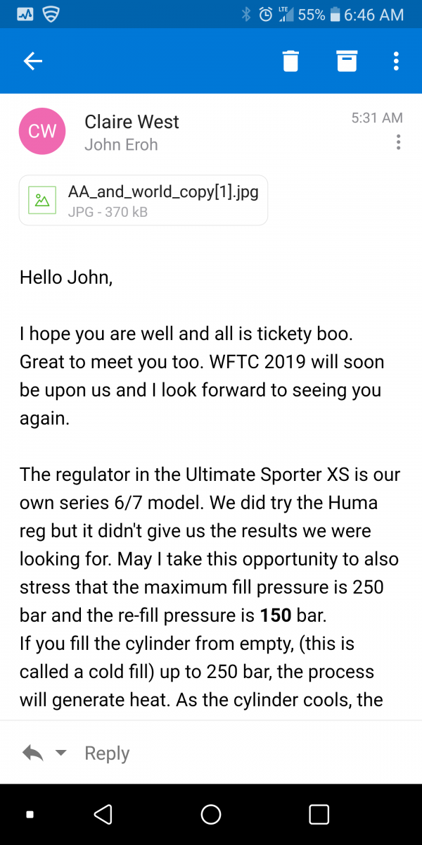

Hi Bob, Air Arms reached out to me & they want you to do some other tests. I'm gonna put you in touch with one of their engineers.
Cheers
Thanks Michael.

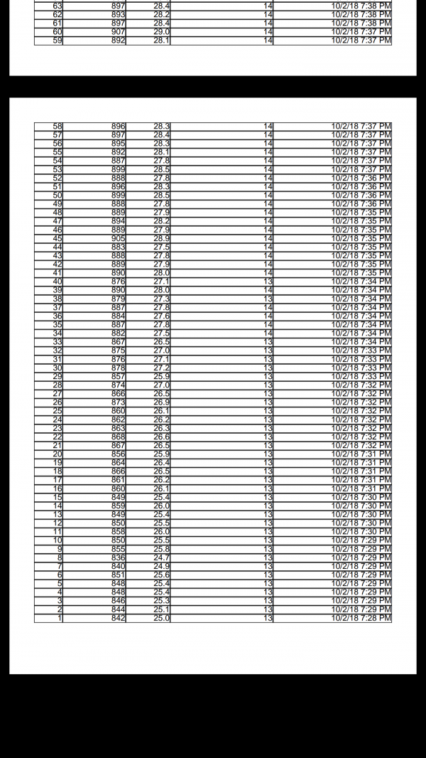

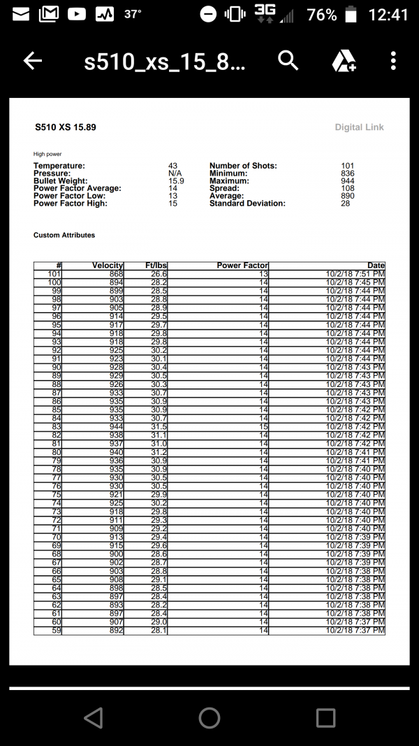

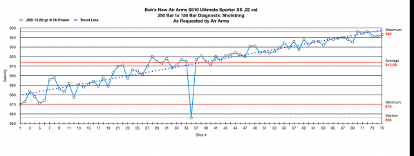

I have been exchanging emails with Alan from Air Arms. I just sent him the chart from the specific test he asked for. Here is that exact chart, which he wanted from a 250bar fill down to 150bar. If anyone goes back through all the charts I posted in the other thread, you'll see that the performance of my rifle has not gotten any better over 1,000 pellets.
I'll be sure to post how this all turns out.

I won't have time today to do the 250 to 150bar fill today as I'll be working into the evening.  I should get 60 shots easy but from 250bar the ES will be very high, as I already did a full string from 250 to 125 and you can see the ES for the first 60 shots is bad.
Even if you remove shot #36 from my latest chart....ES would still be very high at 74.
