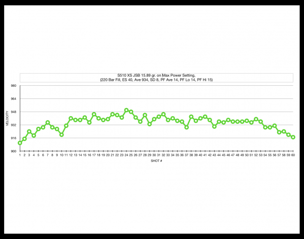

Your first 10 shots are still starting low and climbing. An educated guess suggests that you might have a creeping reg or perhaps a slight leak between the main tube and the plenum. The higher pressure at the start of the string will cause the lower fps. If the reg was working properly, you wouldn't get that rise when shooting a nearly full tube. The first two shots in each string are marginally lower so perhaps there is a little bit of creep going on.

This is why i am returning the gun,if your just paper punching for groups then it might be ok.but if your going hunting the poi is going to change with a spread of 40 fps it just isnt going to work for me
This is the first regulator air arms has put in a gun i believe they got it wrong

BDX made this out of the numbers in my Chrono chart. You wouldn't guess it was a regulated model looking at that curve. There are eight small groups of shots that are nice and tight, separated by some shots where the velocity semmed to dip and then climb.
