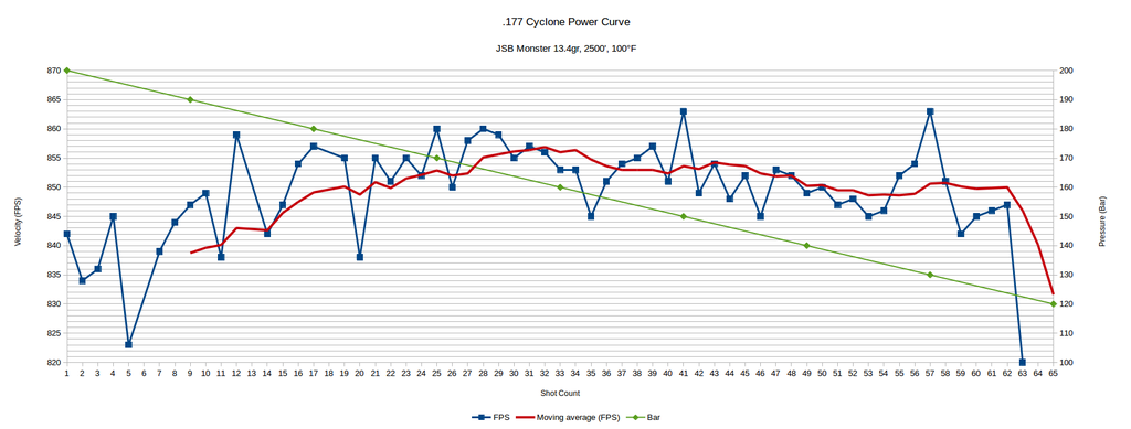

I recently got a chrony and shot a couple strings from 200 bar. The first was with the hammer spring preload set as it came. I don't know if it was the factory setting.
The second string was with max hammer preload. I have no idea what's going on inside the gun to make it this consistent. Any lighter pellet would probably be transonic and unstable at this power level. And I haven't been to the range yet to see whether these pellets are actually good at this speed.
