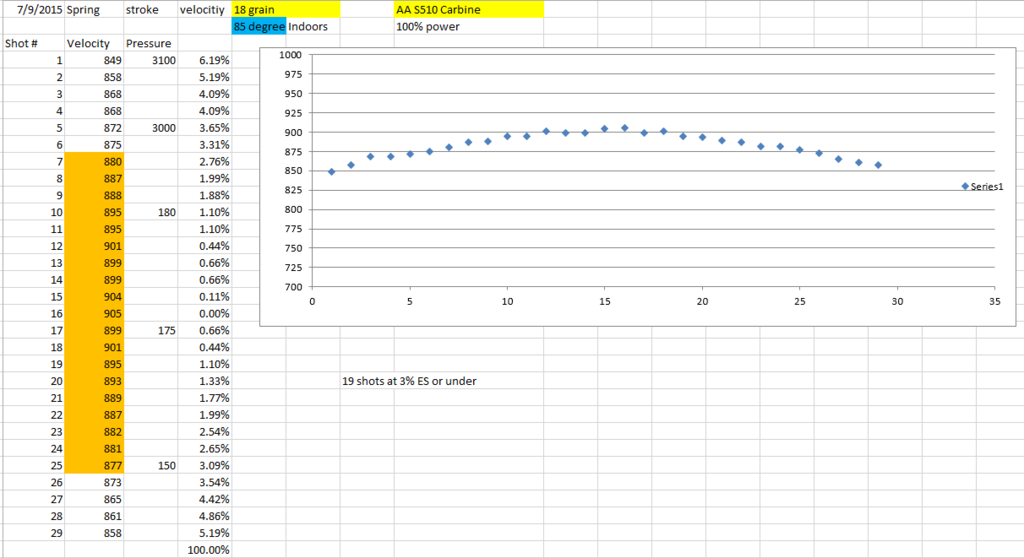

Spash, here's my take from experience. At the same time I had the Regal Xl 22 and the AA S500 22. The Regal has a really great shot count at 29-30fpe, right at 30-40 at 2-3% ES from a carbine. I have quiet a bit of data on this gun along with the AA 500 Extra and the Carbine version. The Extra is a lot longer than the Carbine and it will give you about the same shot count and energy as the Regal, maybe a little more power. The AA's FAC are fairly loud as well so I started using a LDC on my S500. Now that it was nice and quiet it was as long as a goose gun. This led me to selling it and gettin the S510 Carbine. Now I have a gun that is in the same length class as the Regal and as a bonus it came with a really nice LDC but..... the shot count on the S510 carbine at full power is only 22-23 shots if you try to keep the ES at 3% or under..that was the down side.
So, I decided to regulate it. Now it's a really great gun. 35-40 shots at around 1% ES at 28 FPE. If I had to choose now between the Regal and a AA Carbine I'd go with the Regal. If you don't mind a longer slightly louder gun I'd go with the S510 Extra.
