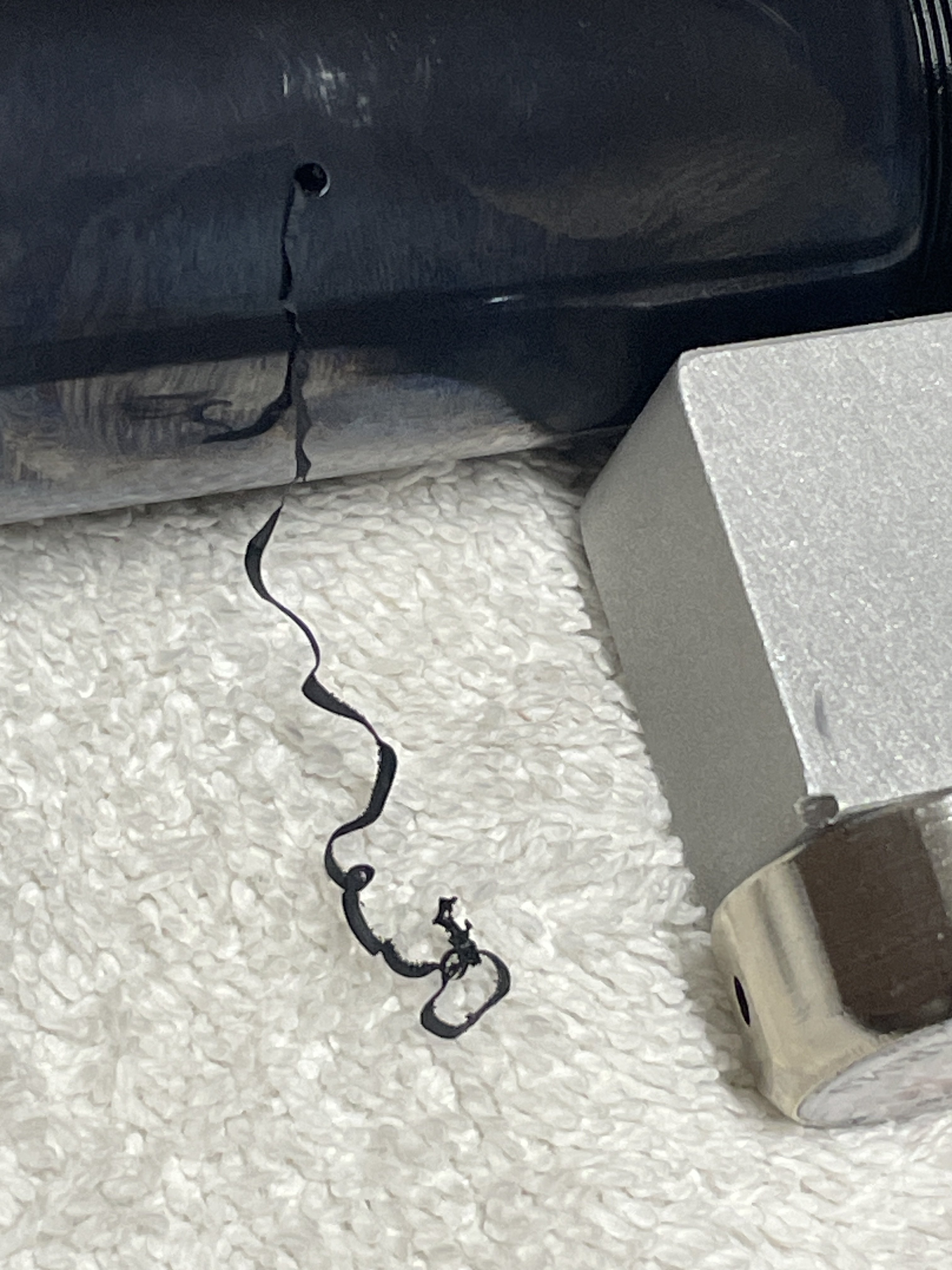

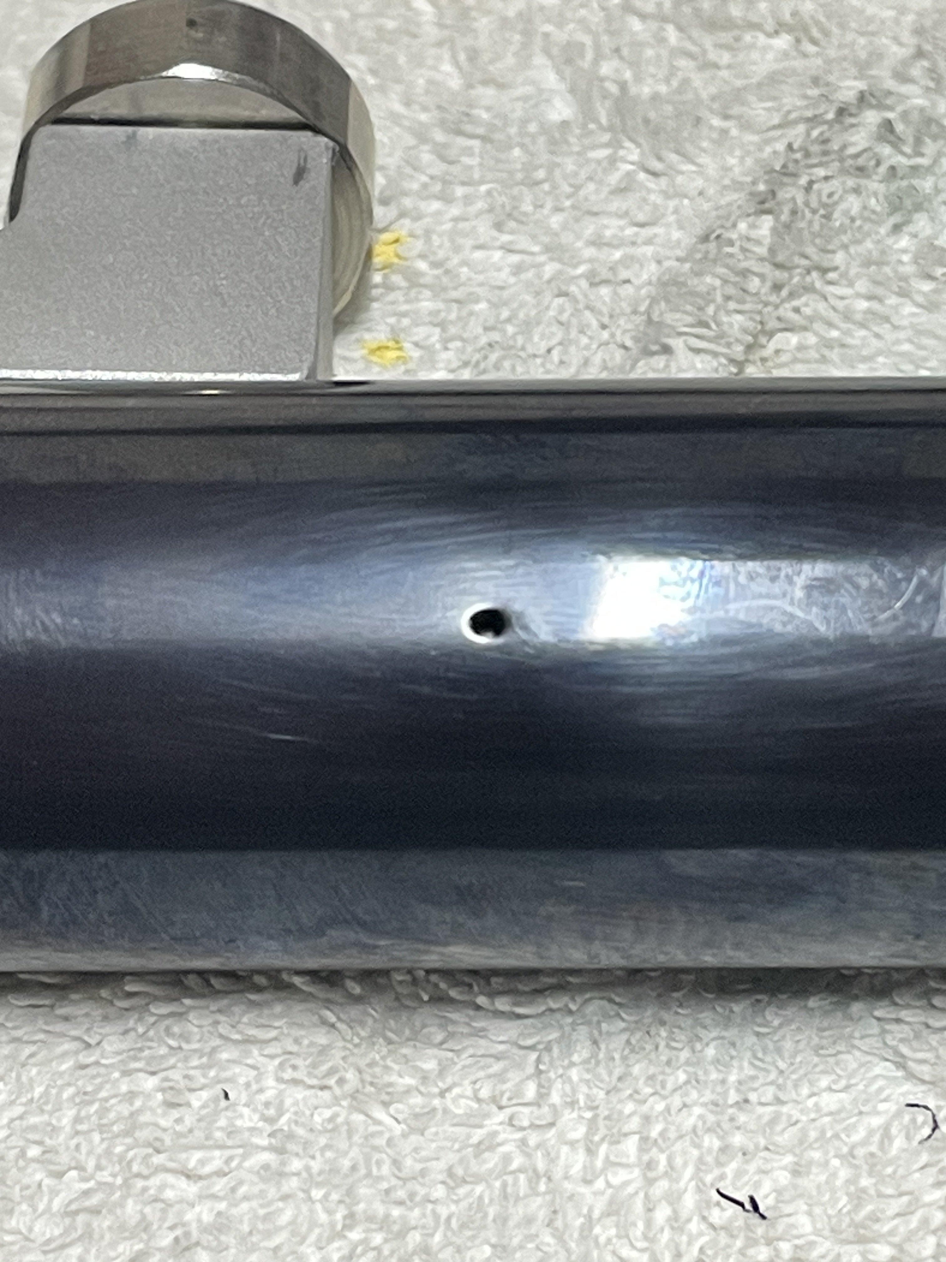

A question for the experts, I have an Air Arms S510 Ultra Sporter XS Regulated that sprang a leak after shooting a few rounds off.
the leak came from the hole in the cylinder where the regulator housing lines up inside.

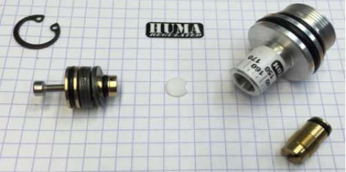

Sourced a set of replacement seals/rings and stripped to service.
replaced the backup ring and 23x2.5 -90 rings on the firing valve body, also the two 15x2-90's on the regulator having been directed to do so.
