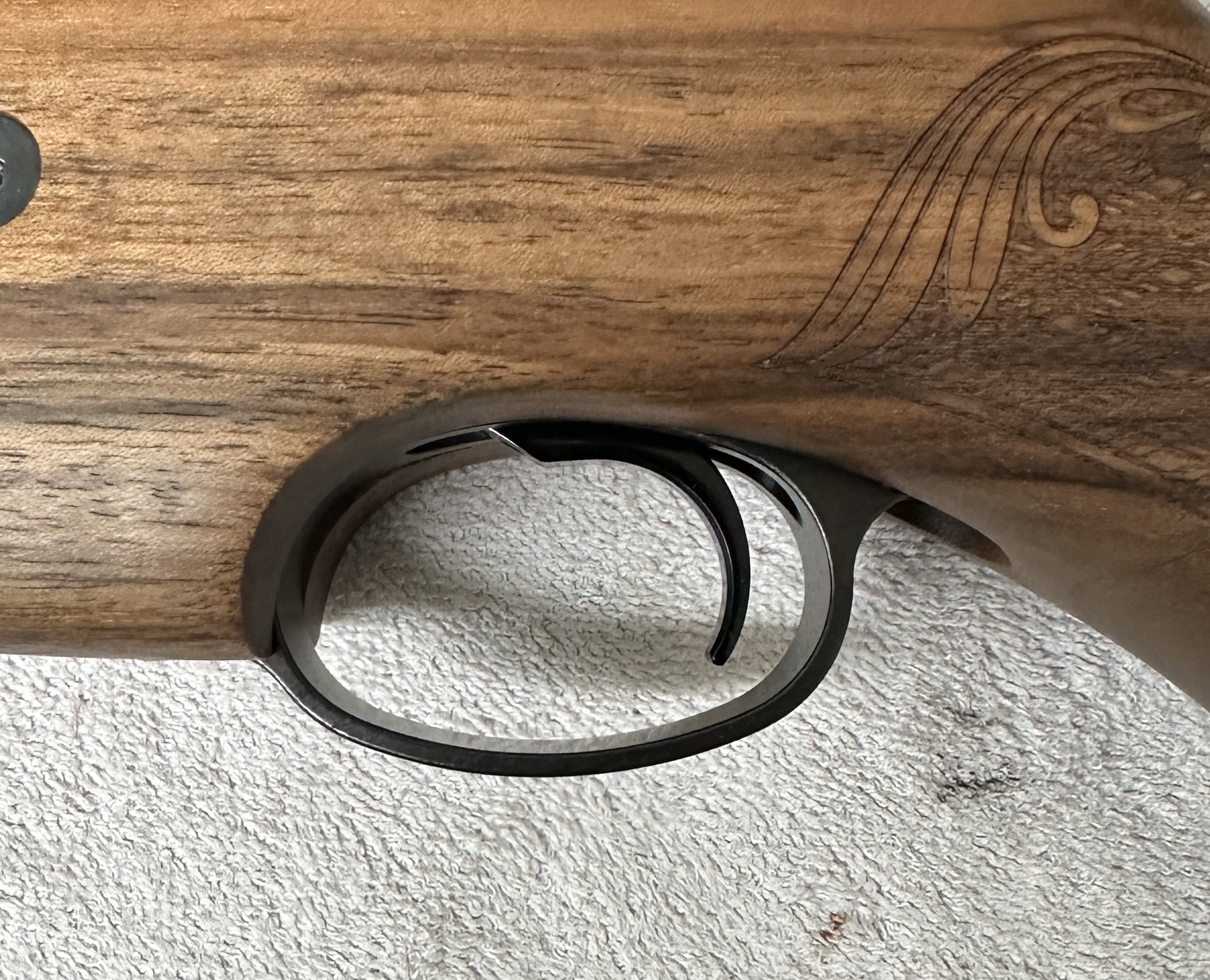

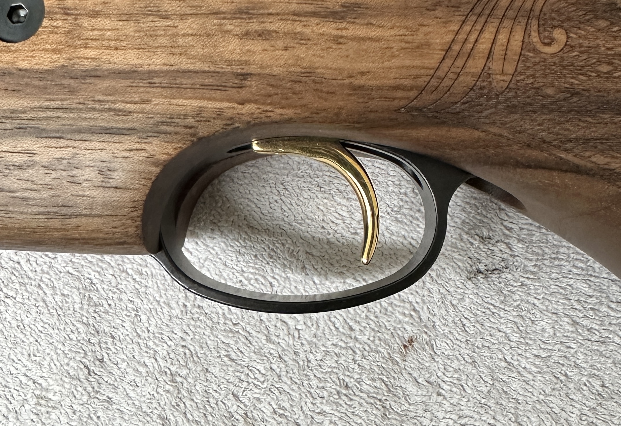

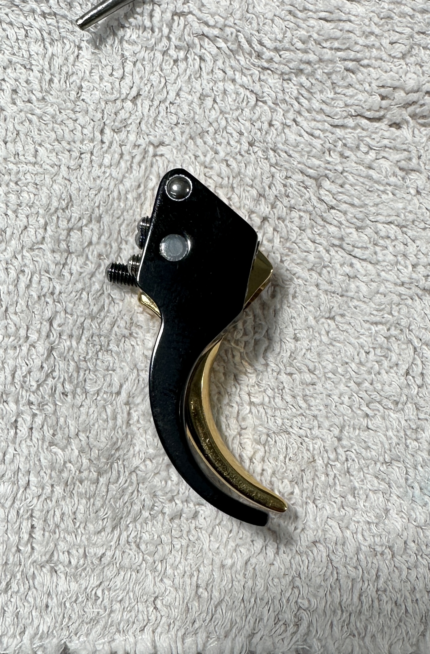

I upgraded to a black Rowan set back trigger blade. The gold factory trigger works great, I just like black better.
Before......
After.....
Distance from the back of the trigger to the trigger guard is roughly .126" closer with the Rowan.

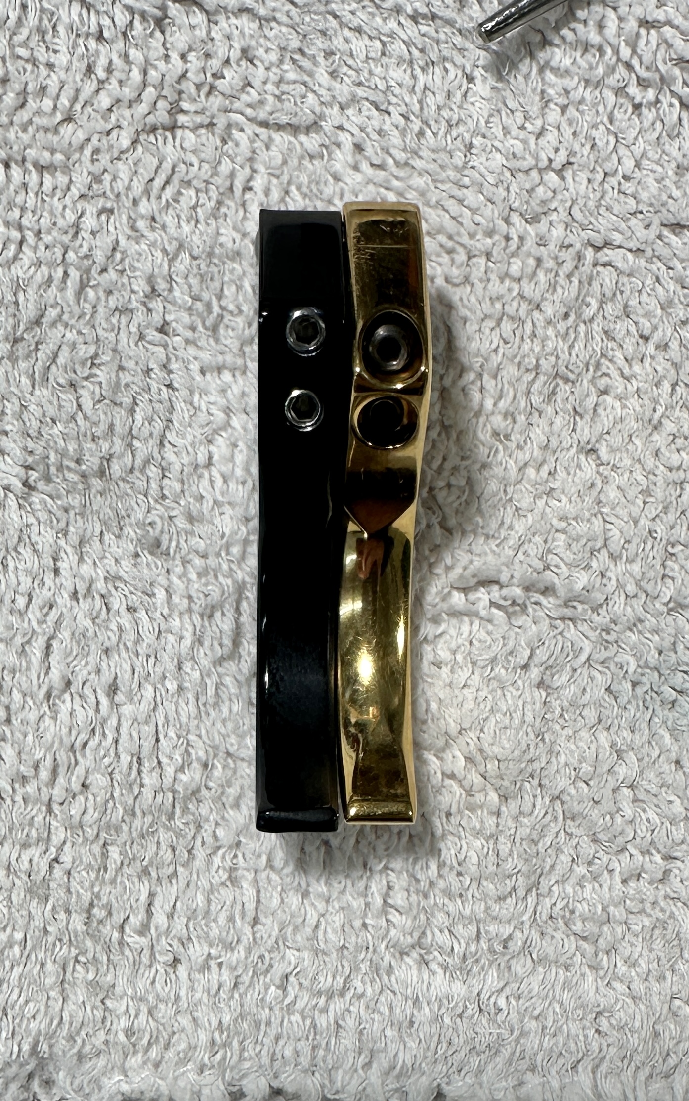

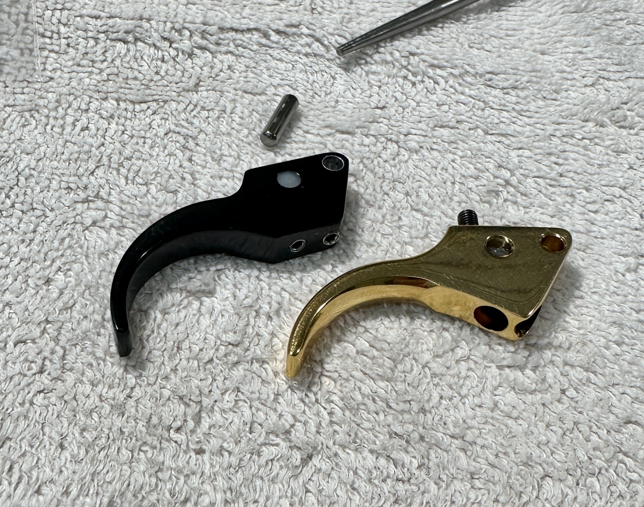

Here's some comparisons between the two.
The Rowan is about .010" thicker than the factory trigger, so I had to adjust my washer thickness that I had added previously, for side to side play.

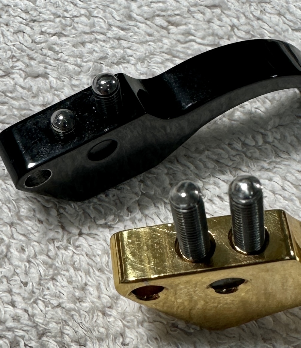

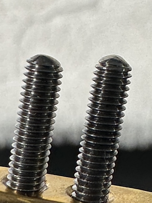

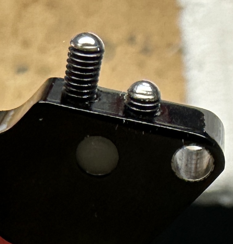

Here's a look at the spherical polished heads on the adjustment screws. The factory Prosport screws looked better, so I swapped them out to the Rowan trigger blade.
And here's the ones that came in the Rowan trigger blade..
And they would probably work just fine, I just liked the looks of the factory Prosport screws better.
Factory Prosport screws on the black blade, and Rowan screws on the gold blade, after swapping them out
Now to shoot it and get it adjusted, and see how I like it. ✌🏻
