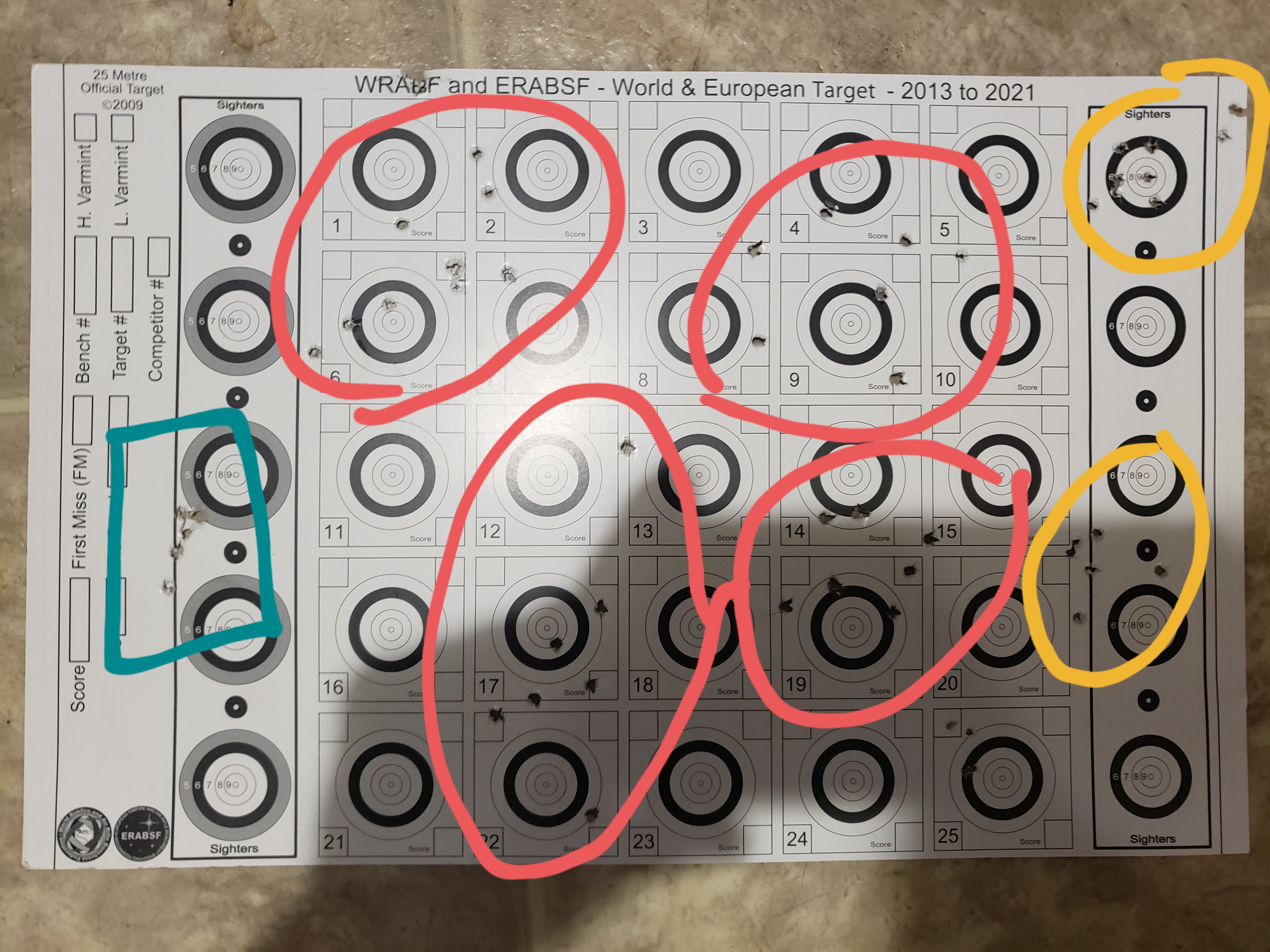

Ok so messing with full power tunes for a .22 springer here. I was already inside the gun modifying the trigger housing to accept a better spring guide and decided to swap the heavy 55g top hat for a lightweight 10g top hat. Got it back together and took a few shots down range to settle it in and then moved to paper because it felt pretty good.
Red circles: 10g top hat, front bag only. Holy f.... I think there's something wrong here.
Moved to the Orange circles: 10g top hat, artillery hold with hand between front the bag and stock. Better. Nothing wrong with the barrel, the gun is just hold sensative. Very hold sensative. Let's put that 55g top hat back in and see what happens.
Green group: 55g top hat, front bag only. That's better. One low shot but thats definitely better. Amazing what a 45g/0.1lb/1.6oz can make
Long story short, sometimes the manufacturer knows best lol. Still worth the experiment though and I may try again and meet in the middle to see what happens.

Yessir that's the lesson learned here for sure. All said and done and that 40g reduction really didn't feel that all that much better all said and done.

Sqwirl57, yeah it’s a balancing act for sure. I recently had a customer send me an extremely hold sensitive TX200 .177. His goal was to optimize grouping at 50 yards. As it arrived it would not even group at 30 yards. Like you I also reduced mass weight by going with a delrin tophat. But I also swapped to a lighter spring and machined a new transfer port. End result was a rifle that was much more manageable without any special hold.
The rifle ended up at 13.5fpe.

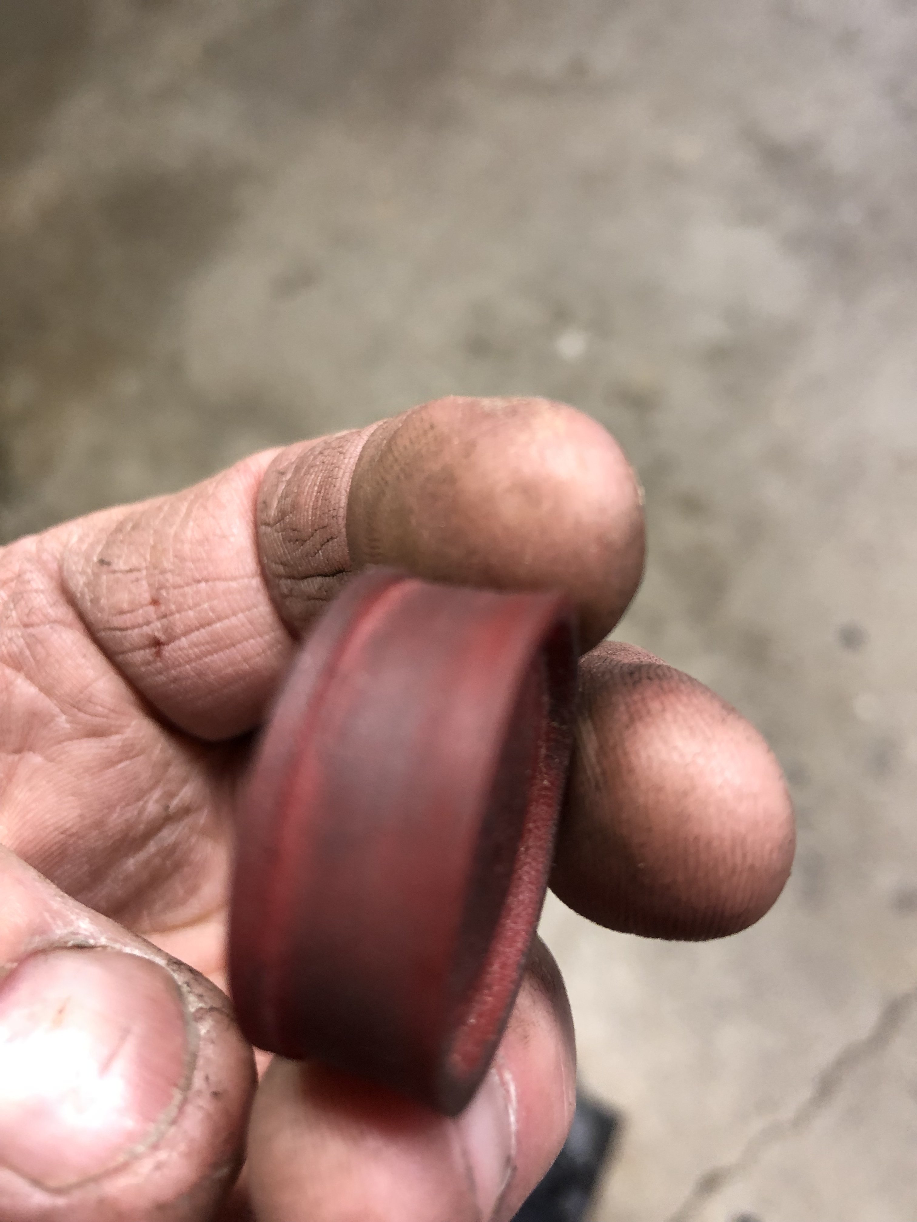

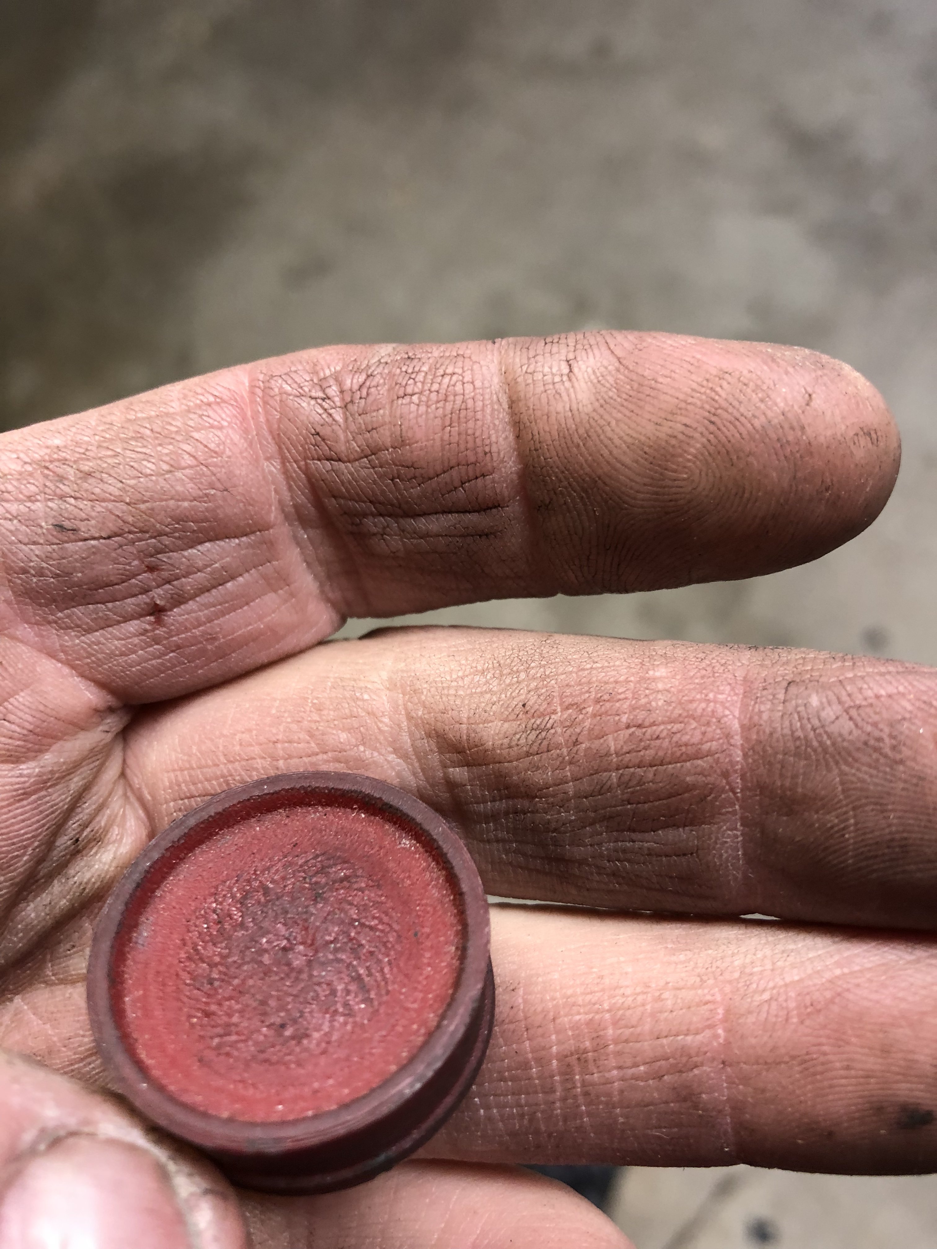

Funny thing is my 97K with an aluminum O-ring seal will stack pellets no problem. What does your cup faced seal look like?
Is it similar to the prosport seal?
Reactions: Sqwirl57
It’s not a accuracy issue it’s a shot cycle feel ..
also the 97/77 platform is center transfer port design with a much shorter length. It has a much different potential
