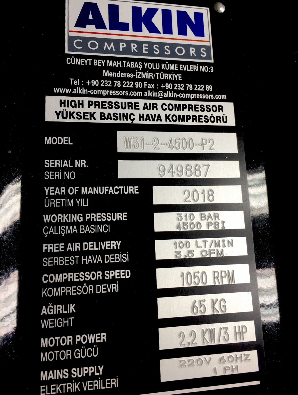

With all my bills paid, and money in the bank I decided to pull the trigger on an Alkin W31. It doesn't have the auto condensate drain but I'm used to that and it wasn't worth an additional $1000 I didn't have to get that option.Other than that it met all my criteria.

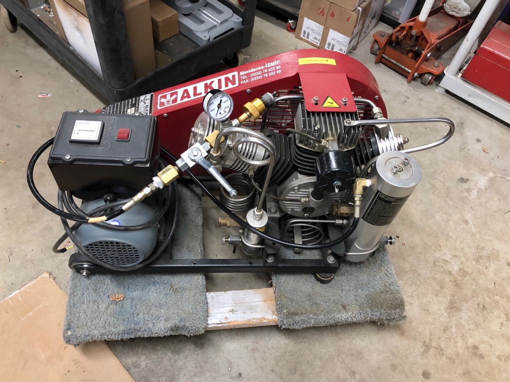

The racket the Alkin initially makes is scary. It sounds like the insides of it are about to be outside of it. It's very disconcerting for sure, but totally normal if you're expecting it, which I was. It quiets down in seconds when under pressure. It isn't a quiet compressor, but neither is it oppressively loud. I didn't need ear protection in my garage which I had closed so as not to disturb my neighbor.
In any event, I hooked up my baby monitor and went back into the house fully expecting for the filling to take at least 3 hours, which would be considerably less time than the LC110 took to fill it from 225 bar.
Freakin' A!
It was done in 1.5 hours! Even with me draining the condensate every 12 minutes. I actually thought something was wrong with my gauges for a minute. I opened up all the big tanks and the pressure dropped to 4050psi. Another 30 minuets and they all were topped off!

But, it's not all roses. There are several things to be aware of. The compressor doesn't come with a plug, and the one I got requires single phase(w/e the hell that means) 220v. There are models that requre 3 phase (is that 3 times better?) 220v, as well as engine powered. I have a fuse box (yes fuse) in my garage that feeds off the main circuit breaker in the house. I had to spend a bit of money on an electrician to come run wire, install a socket, and put on the plug. $300 total. Also again, it isn't quiet. If you have neighbors very close to where you have the compressor You won't be doing any drunken 2am fills. It's also heavy as hell. I couldn't hardly move it, let alone lift it. I had to pay a neighbor (a rack of smoked ribs) to help me get it where I wanted it.

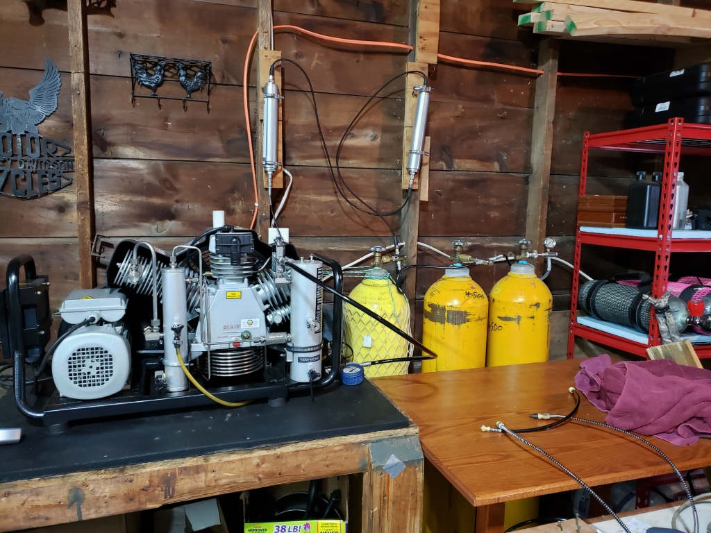

The setup I have is the end result of years of evolution that started with my first PCP. Perhaps a simplified timeline would help.

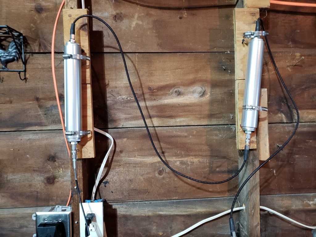

Initially I had a gold water/old filter but I decided I should get something better. So I got a Omega to use between the compressor and cascaded tanks, and the gold between the cascade and scba when filling.
My Daughter bought a Crown, I bought another Impact, and my Ex bought an impact. So, between the 3 of us we have nearly $20, 000 in guns. I figured it might be prudent to take all the precautions I could to make sure they were fed clean & dry air, so I added another filter.
However, 2 filters between the compressor and cascade seemed to take forever to pressurize. In retrospect I think that may have been a warning signal for the problems I had.
I have no such problem with the much faster Alkin, and while all those filters are probably overkill, I'd rather spend the extra $250 and not spend that money to have the gun resealed or repaired as often.

Your question on cascade systems is because it's not apparent what the benefit is. It took me a long time to wrap my brain around the physics of it, but I'm blinde.
For example, you can get more fills from two 30 minute tanks than one 60 minute tank. How is this possible when the air volume between the 60 and two 30s are exactly the same?
Well, what you do is use 30min tank A to refil your gun. The volume of air is now less in tank A of course. You keep using tank A until it's pressure falls below the fill pressure allowed by your gun. When that happens you put as much as you can from tank A, then use tank B to top it off. The next time you fill you use Tank A, then tank B to finish. This procedure, while tedious,allows you to use more air at pressure than a single tank. Adding more tanks adds more usable air.

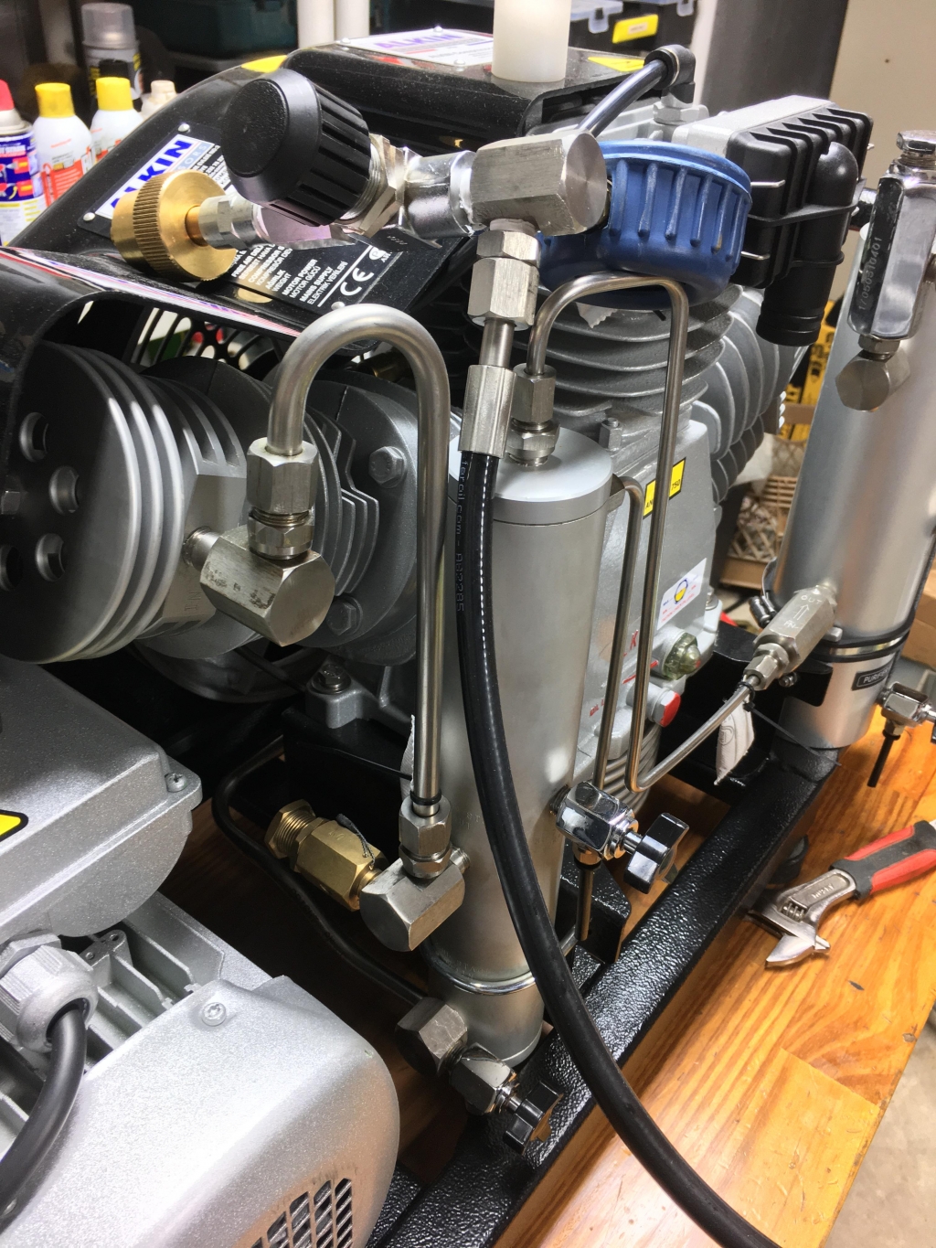

I have a Stethoscope & if the racket you speak of is on the left side of crankcase cover it's common. These are meant to run at 10 hour intervals.
